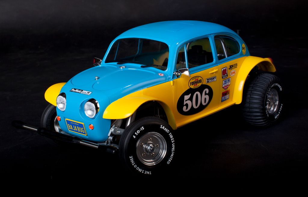

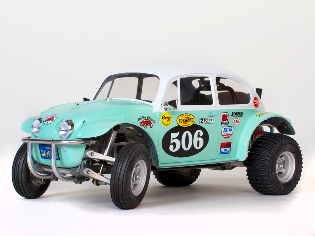

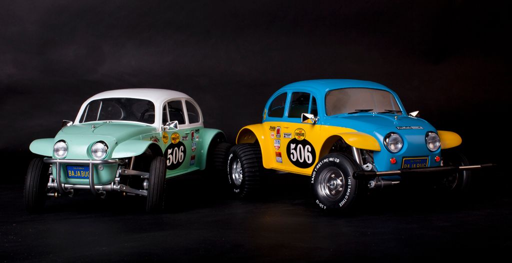

Well after complaining about the frustration of building a re-re (due to old technology), I took my Scorcher out for a test drive. Wow I was completely amazed how straight the car ran. I didn't even have to make any steering adjustments. I love this thing. In fact i love it so much I ended up giving my Scorcher a brother, bought another Scorcher. Of course, the second build was much easier since I learned from all my previous mistakes. Attached are a couple of pics.
thanks for the compliment. For me the most time consuming task of painting the Scorcher is sanding away the rough edges and the mould marks on the fenders. I wished i had the patience to install lights.
Brilliant job, got to love a Sand Scorcher, so 2 is ......errrrr... twice as good.
I too was surprised as to how well my SS went, still only tested it briefly up and down the road but it took off like a scalded cat with no sign of the 'dodgy steering' that they are renowned for having. Still need to address the lack of decent brakes issue and then I'll be really happy.
Enjoy, whether it be running or just admiring your work.
P.S. great photography too.
