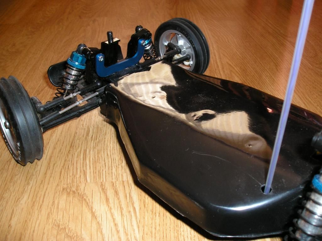

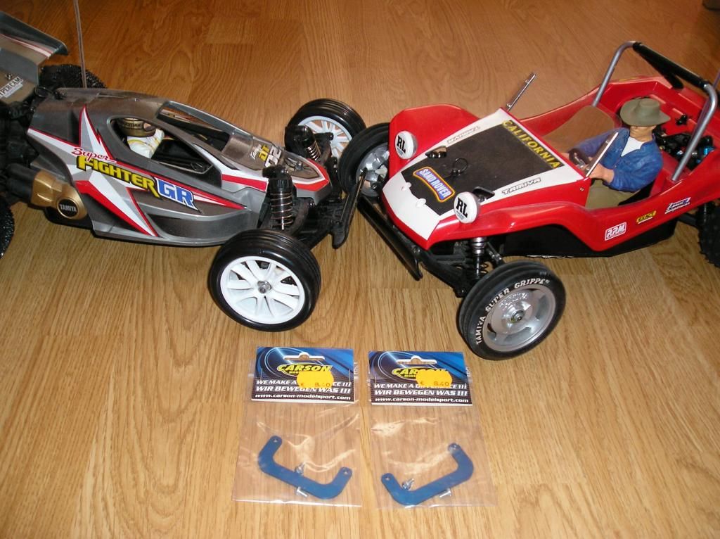

My son has the Super Fighter GR, he has given it a good thrashing and the body shell is quite tough. I have a Sand Rover 2011 and a Holiday Buggy 2010. I would recommend you get the Carson front shock tower brace.DT02Casron001_zpsf17a8dba.jpgSeen fitted and a huntersystems chassis cover to go under my Sand Rover body.DT02Casron005_zps9a0615d7.jpg

On the GR does the buggy body stop the dirt from getting in the chassis as I have the Holiday buggy and with that body it fills up the chassis with dirt...was hoping the GR would be more sealed and not fill up with the dirt?
Supper gripper, Does that chassis cover raise the temp of your electrics at all?,
not when using something like a whimpy motor such as a sport tuned no. We have run some powerful motors such as a 19turn spec and a 17 double and nothing over heated :D using the chassis cover is no different from using a Velcro sealed buggy body.
If it were possible to get any more dirt in the chassis it would be a shovel. So, no, the body doesn't help.
Love the looks of that chassis cover though!! I seem to recall a link to a member's site that was selling these? I'd love to find that again, because that would solve one major hassle!!
>shenlonco< the Super Fighter GR body shell is a poor fit on the chassis plus the windows are not glazed so the chassis fills up with dirt. You will need a Desert Gator or Sand Viper body shell and use the velcro not body posts to form a tight seal.
