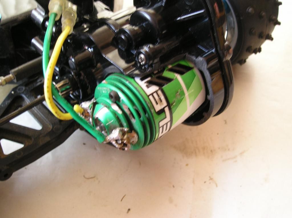

I run a 19 turn spec motor in my DT02 and it can just about handle it with the ball diff fitted. I did try a 17 double in my other DT02 but that had a geared diff and the car was a complete handful.
Even with an anti roll bar on the rear it was cocking its legs like a boy racers hot hatch :lol:
the chassis was twisting from the excessive power and it was awful to drive.
