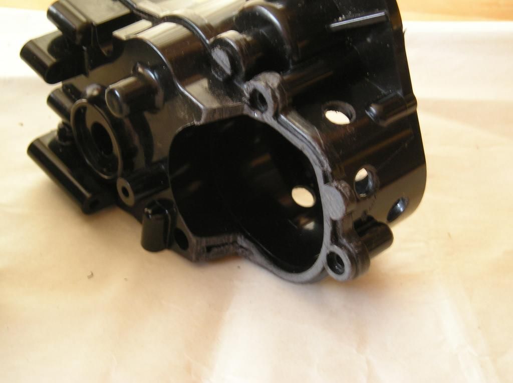

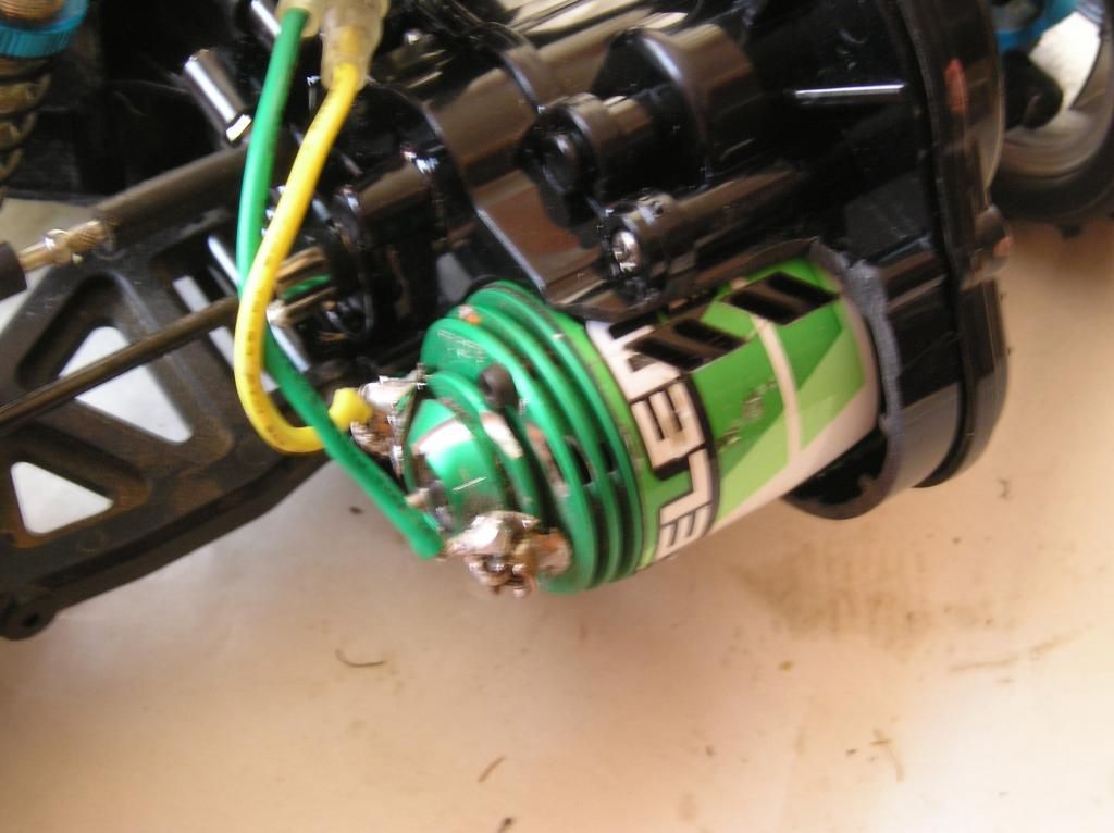

The DT02 chassis does have a motor cooling issue. There a few heat sink options available from a lot of manufacturers.
I decided to experiment with a couple of gearboxes.
this first one looks drastic but the integrity of the gearbox is not compromised
or a little less material removed with holes drilled for airflow
