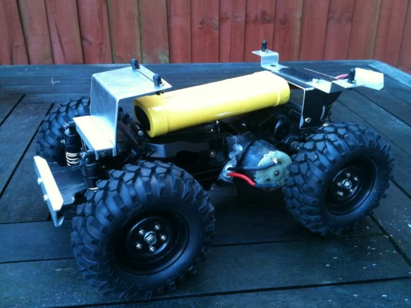

Initially I chopped up a TL-01 chassis to make something with the correct 160mm (or thereabouts) wheelbase - particularly as I wanted this to be a 4x4 - and I'm sure with a lot of time and effort it could be made to work well enough... However, Inspired by Toykid's Losi MRC/Willy hybrid, I then looked at alternative scale chassis that might be closer to the wheelbase I wanted, and sure enough, found something that was essentially perfect!
On the left is the original Taiyo chassis, and on the right an HPI Mini Recon, fitted up with Sand Scorcher rear wheels all round.
As you can see, the 160mm wheel base of the Mini Recon is perfect for the Willy shell, as was the 178mm track width... I chose the Recon for a number of reasons - mainly that it was 2.4 GHz RTR, and had a separate receiver - that also includes a 3rd channel so I can fit lights to it easily... The Suspension was also really plush, and it would appear relatively easy to convert the mini axles to larger 12mm Hex-drive (although I decided to ditch that idea and go for the Padlatraks as a homage to the original Willy).
Although the pin drive axles were only 3mm (compared to Tamiya 5mm), I was able to make some adapters using K&S aluminium tubing, and cut a slot in the back of each SS wheel for the pin, so the wheels mounted up perfectly.
I also extended the body mounts to the correct height for the shell, using more K&S tube - the 4mm fitted into the post mounts, the 5mm sleeves it, and the original 4mm mounting posts fit into the 5mm sleeve (hope that makes sense!):

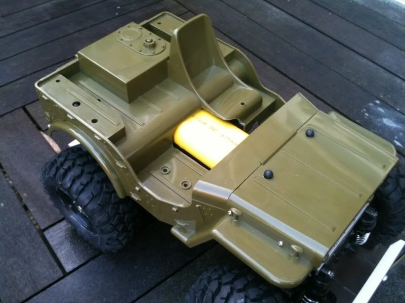

Having originally chopped up another WW2 shell to try and make it fit my Crawler chassis (I eventually gave up on that idea), similarly, I cut out the fuel cell and repositioned it in the passenger footwell - not just to be different, but because I want the rear loadbay clear for a few accessories - and used a section of another Willy shell bonnet (hood) to fill in the gap...
Because of the new fuel-cell location, I also had to reposition the gear levers on the bulkhead, and have fitted a steering wheel from the VW Camper kit, rather than the stock WW2 steering wheel that has solid spokes.
I have removed the spot lights from the rear rollover bar, and will be fitting the pad section with the fire extinguisher from the rear stays here instead.
So, to give you an idea where this is going, a few photos of the body mounted to the Recon chassis:

For the moment, I have mounted the body at this height (unladen) - mainly because any closer to the chassis and the wheels will rub on the arches - yes, the Recon actually has a reasonable amount of travel & articulation, and I imagine it will only get better as the springs bed-in.
With the current ESC position under the rear deck, there is still room to drop the body onto the chassis about 10mm:
And simiarly there is 10mm or so between the bottom of the body (even without trimming the centre rib) and the chassis, should I decide to drop it slightly:
Perhaps one (simple) option is to make a second set of body mount extension tubes - and have one set for display/scale appearance and the higher ones for actually driving?

My initial idea was to keep the bodyshell original from my WW2 and use a small lipo battery, but once I tracked down a 2nd WW2 body set I decided to cheat and cut out enough room to fit a standard 7.2v pack down the centre of the chassis. I'll cover it in plasticard to make a battery tunnel.
FEDB1E80-78F1-4E8D-AF9F-AFEF55E7A944-235
2D3F90F8-DAE8-45DB-96B5-2FD1A8B96F30-235
The rest of the electrics fit under the bonnet and fuel tank.
