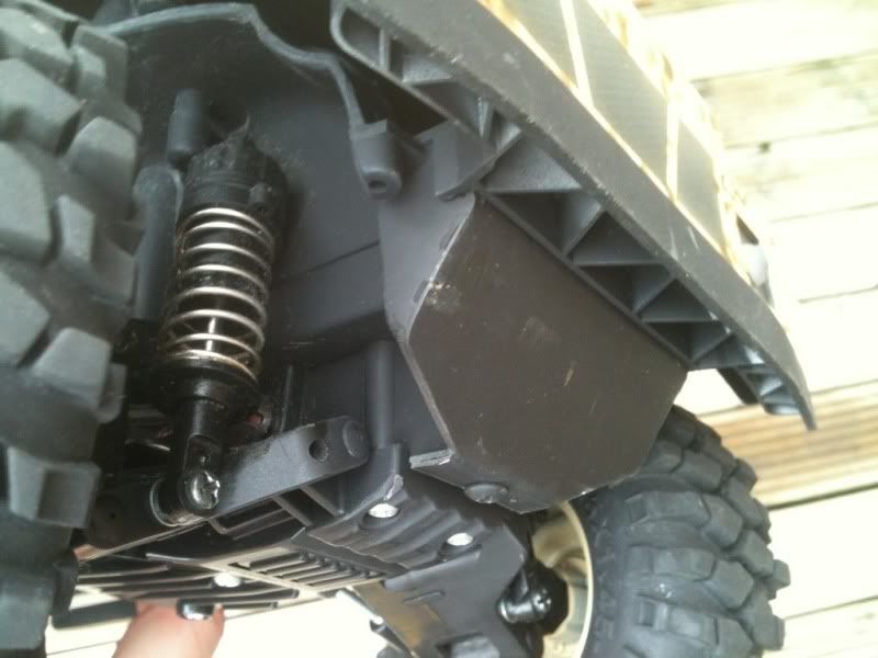

I got my skidplate it looks ace but on first inspection it seems to stop the body from fitting. I will have a play tomorrow and post some pics if I can sort it. I spent loads in there! Like a kid in a sweet shop!
Slight issue with the Skidplate I got yestersay...
Once you fit the skidplate it gives you no room for the metaltop body to mount on DOH!
These pics should explain..
I think I am going to try what XV Pilot said in my how to raise a Pajero Body post as I think the body raise maybe the only solution for this.
If anyone has any other ideas to make it fit let me know because it does look ace on the chassis!
Ah, I see what you mean. Raising the body should do the trick, or trimming the skidplate. My apologies - I thought it would be a direct fit like the Junfac one that I use on mine.
Those slip plates look nice but it'll just make you more likely to ground on rough terrain. Best thing is to cut off the "brick" at the front and either adapt that plate or make your own from aluminium. I cut mine down at an angle so it left the body mount holes at the top and the lower screw hole at the bottom (the pic below shows a Landcruiser bumper fitted which attaches just like your body mount).

A bit of shaped alum is screwed to the ledge at the bottom and fits up behind the bumper. I filled in any gaps left at the sides and sprayed it all black. Combine that with 96mm or these 108mm Ansmann wheels from Modelsport and it just doesn't ground anymore!
Edit: I should add the 108mm tyres are probably a bit too large for the Pajero bodyshell :)

You don't need to apologise I also thought it would be a direct fit. It kind of is it just does not taking into account the body. :D
I will have a play and see what works, will post pics when I have finished.
PS: Mr Crispy that looks ace! My metal work skills are poor, I would probably end up cutting off and finger or my hand etc ;)
Its a great idea though and I will look at that in the future when I have done a few more upgrades.
Trimming the brick is probably the best way forward for off-road performance, but I wouldn't say the skid plates make matters worse. Compared to a stock tub where the brick bashes straight into obstacles,, getting hung up on them, an angled skid plate helps the car to ride up and over the obstacle instead. That has been my experience anyway.
