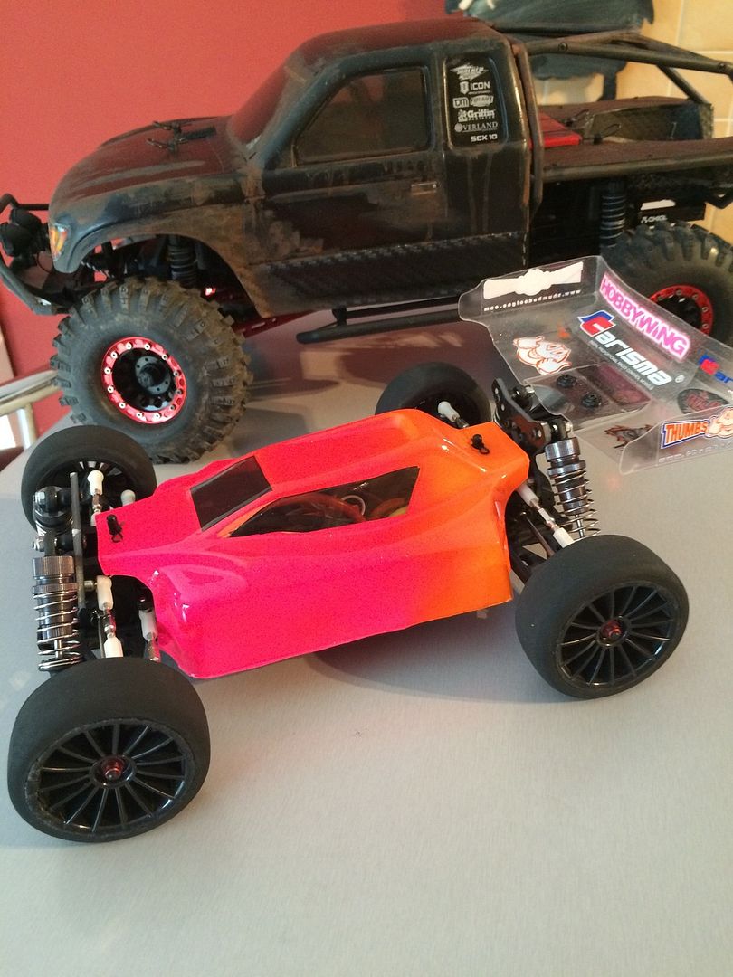

This is my three month GTB and not a bit of paint has flaked and its been bashed around a lot!
PS: The tryes are not slicks! It wears the tread off that fast!
