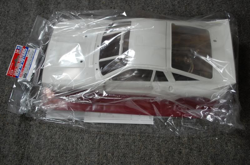

Would the new body set fit onto a Re Re Brat chassis? Or isn't a great choice now that times have moved on?
You are correct.. originally in the 80s it was on the Brat chassis. Im sure the body in essence is the same.. they probably retooled it for tc body mounts. I will let an expert chime in.
Though not an expert, I will attempt to explain:
The re-release body shell would not fit on a re-release Brat chassis, unless the wheel arches are made significantly wider. The original Lancia Rally had those larger arches to accommodate the large tires and suspension travel on the O.R.V. chassis.
In addition, new body mount holes would have to be drilled at the centre of the hood/bonnet and at the sides. If using the original bumper, two large holes also need to be drilled into the front lower grille to fit the bumper posts into the chassis.
Other than that, the body sets are in essence the same.
Less-significantly, the re-release model features a window/windshield piece that covers all the window openings, whereas the original had one that left the right-side window open to leave room for an antenna. If using modern RC equipment, this open window will be irrelevant as many 2.4 GHz receivers do not have aerials that will reach the antenna mount. The re-release 'glass' also has a hole drilled into the centre of the rear windshield for an antenna pipe out back as on the touring-car chassis it is based.
All light buckets and body accessories carry over, though. I believe the re-release set also has the added bonus of side mirrors and windshield wipers to add scale detail. A current re-release body set will not have a cockpit piece like the original re-release kit, which in turn is different from the driver torso/bust the original car featured, mounted on the inside of the body.
So, if you do plan to modify a re-release bodyshell to fit a Brat chassis, the only significant modifications would be to drill new body mount holes and widen the wheel arches. Those are the most important changes.

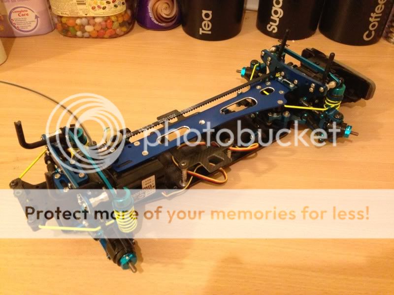

TA03 blue belts are rare as. I have one though :) Fitted here to my TA03F, which I restored with some new GPM parts this weekend. It's not 'that' blue in reality. I bought it years ago when they were more reasonably priced, I think I paid around £20 for it. I still have the packaging for it too, since I put the boring old standard black belt in there to keep it flat!
