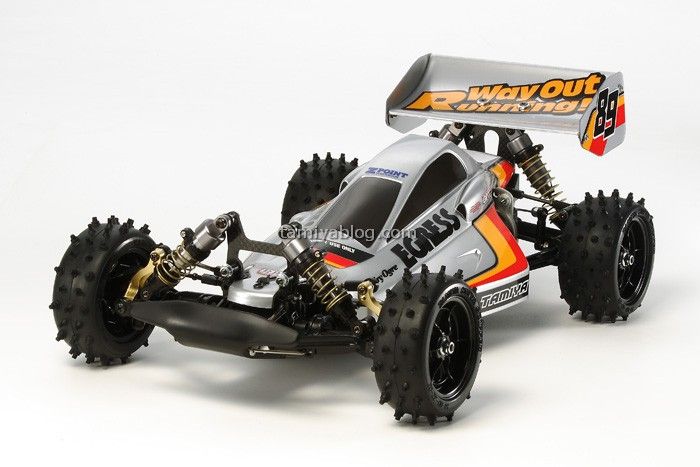

Wonder if they will fit each tyre in the four corners of the bodyshell compartment like the original too?
On inspection, it seems they will indeed as the body mould is identical to the original with the four blocks moulded at each corner to accomodate the tyres.

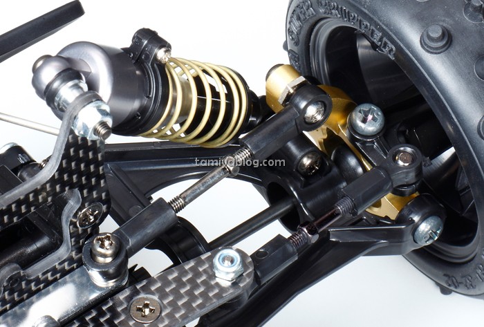

The aluminum brace is mounted reversed.

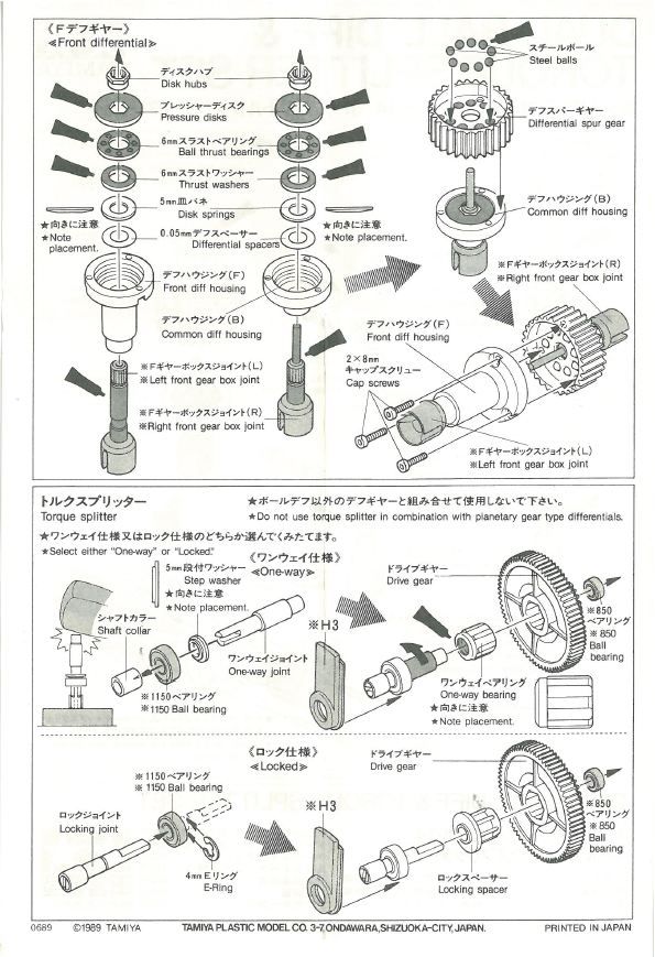

One interesting note: They've added shims to the back of the bearing on the one-way shaft to fix the clearance problem on the re-re torque splitter. The original torque splitter had a brass spacer to take up this slack.
re-re torque splitter set 84257
original torque splitter set 53034

Look fine to me too Haider - its just that the 3mm alloy spacer is smaller diameter than the base of the bushing that carries the rubber o ring - bit sloppy design really but its parts they already have i suppose
They do have the shock collar on back to front though :(

mmm,,,i dont see any problems!!
Can you please explain more
The silver BB3 bushing at the top of the damper is the wrong way around. The one that looks like a T if looked at from the side. The thin part should go inside the rubber washer.
Mate..
It is done correctly..and it is already inside the rubber bushing but since the spacer is smaller than the vintage one, u feel like if it is they way around..;-).
Check the manual and u will see the difference...
Also if u check the re re Hi Cap installation guide, u will see it is the same..
