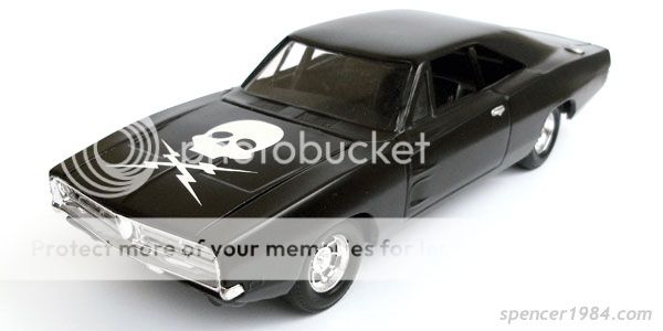

The Charger from the film Death Proof is a great alternative (looks awesome in matte black):
