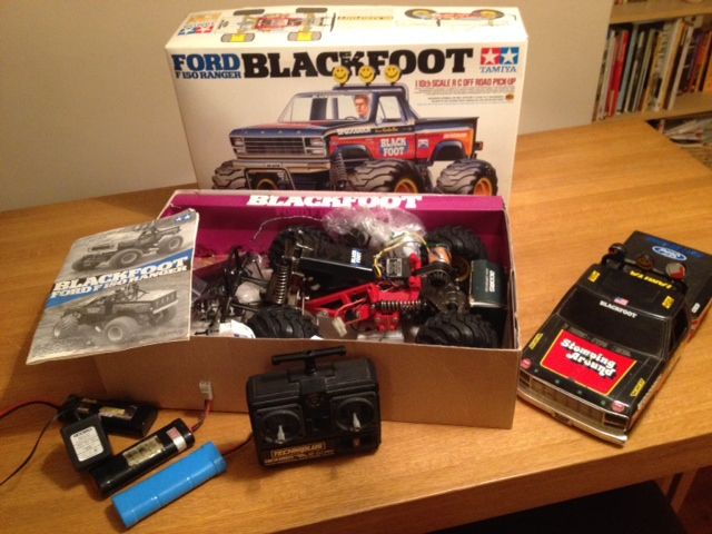

Hi All,
Snap : I also rescued my vintage Blackfoot from my Parent's attic. And as a 10 yr old Nephew of mine just got a Grasshopper, I dug out it out to see if I could get it running.
Here it is, complete with Original Box, Techniplus/Acoms radio kit, racing packs, chargers (fast and slow), Instructions, some spare parts and even the original Molyboenum grease and switch lubricant....ahh the memories !
8189F00E-C856-4BDF-80A3-BA8D01DCE088_zps
Now, a trip to my local model store and some 'net research confirmed that the the world isn't stuck in 1986 (sadly) and that battery and motor technology had move on. Reading the Blackfoot recommendations on here, I bought some new differential bevel gears, a new NiMh 4500 battery, installed new AA's in the transmitter/receiver pack and lubed the mechanical speed controller.
After stripping the gearbox, fitting the new diff parts and adding some grease I fired her up.....and the 1/10 Monster F-150 worked first time !
I was expecting various parts to be worn out, esp the connections on the rear drive axle, but amazingly everything seems to be fine (esp as it got flung into reverse at speed with abandon in the late 80's....)
So that's great news. Now....the questions....
Do you think I should keep the Mechanical speed controller and receiver pack, or go all modern and get an ESC ? One issue I have is that I have a 'hot' (at least it was miles quicker than the stock RS-540 at the time) Parma K Stock motor in it and I have no idea how many turns that has and whether it will melt a cheapo ESC. Any knowledge of this motor very welcome.
Guess I'll need to buy a modern battery charger also.
Then there's the question of dampers....was thinking of getting some Monster Beetle ones as a direct replacement, but should I consider non-Tamiya ? One part of me wants to keep it OEM, but another part wants to tune it the way I would have as a kid if i had the money !
There seems it be a lot of slack in the wheels/steering, might be normal, but I think I will definitely ballrace it.
So anyway, a fun weekend playing with a kit which provided so much entertainment back in the day. Any thoughts welcome.

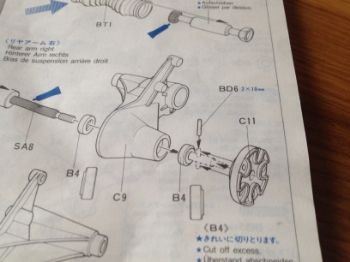

Started stripping it.
One bit I can't figure out is how the wheel hubs (C11, SA8 and BD6 on the below pic) on the rear axle come off, not sure if they pulll off and are stuck, or if I am missing something. Any tips appreciated.
Edited to add - sorted it, they were just stuck. Found my first broken bits too :-(

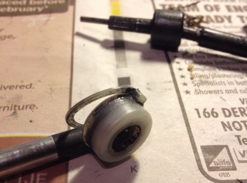

Which bits are broken?
This part :
8E5BEC9C-DF3F-4F9A-8ECA-74E7236B452E_zps
It's quite an important bit from Parts Tree B, connects the Diff Bevel gear through to the Joint shaft through the side of the gearbox plate, in step no. 19 in the instructions.
