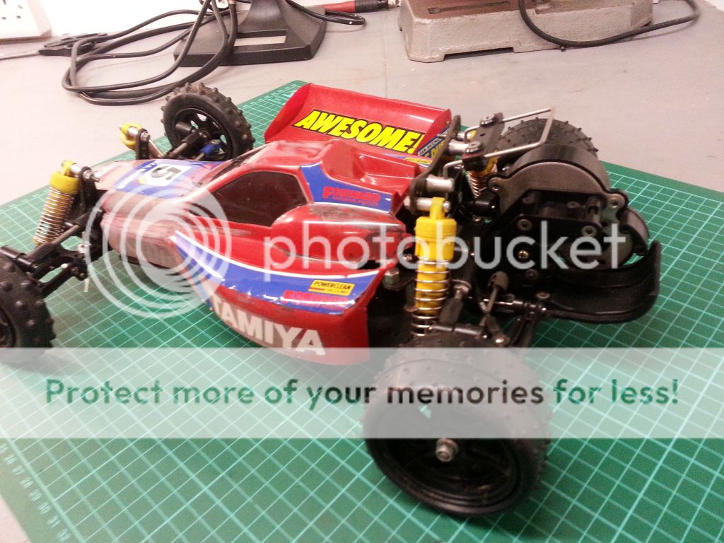

Finally the time seemed right and I bought this one:-
It looked in not too bad condition but still in need of some work.

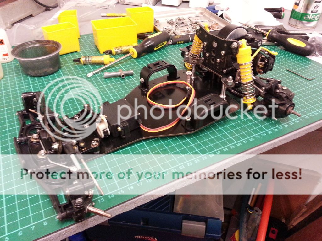

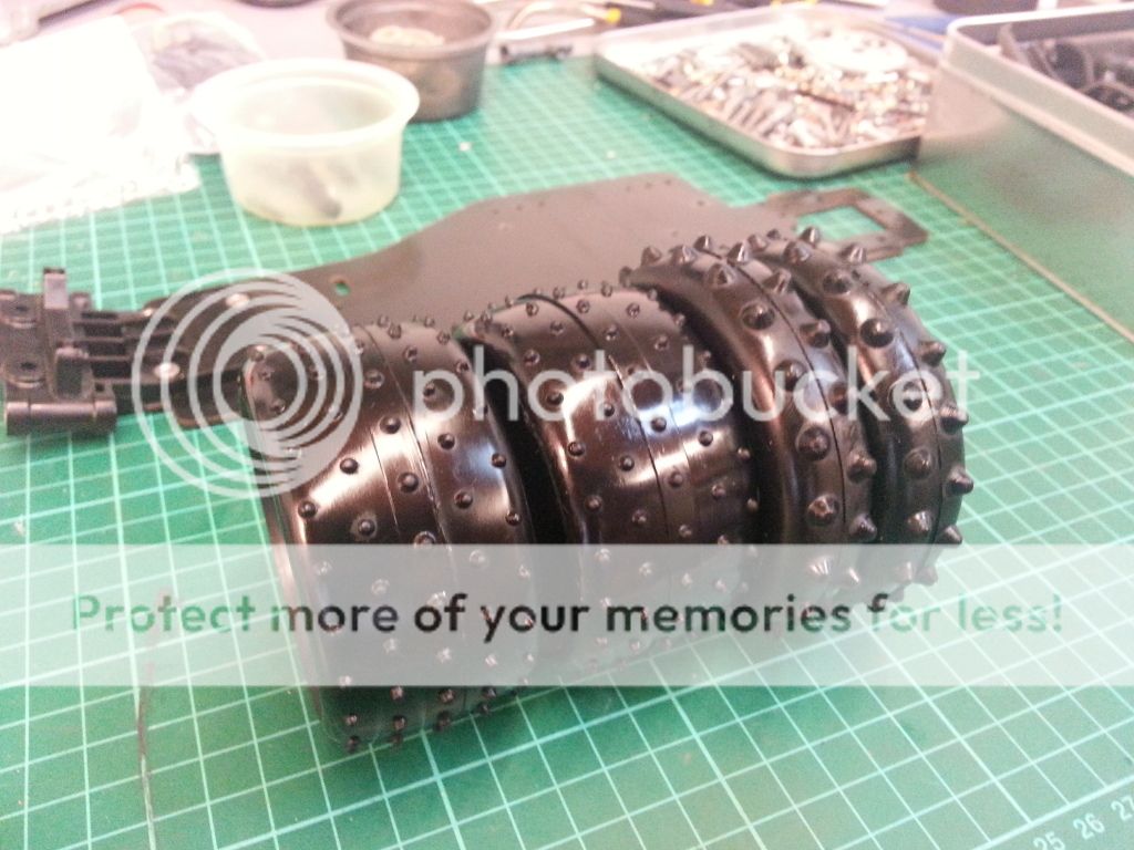

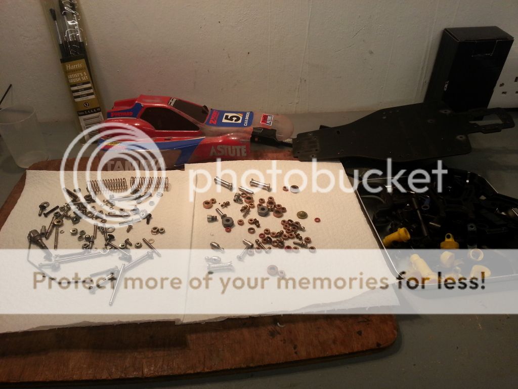

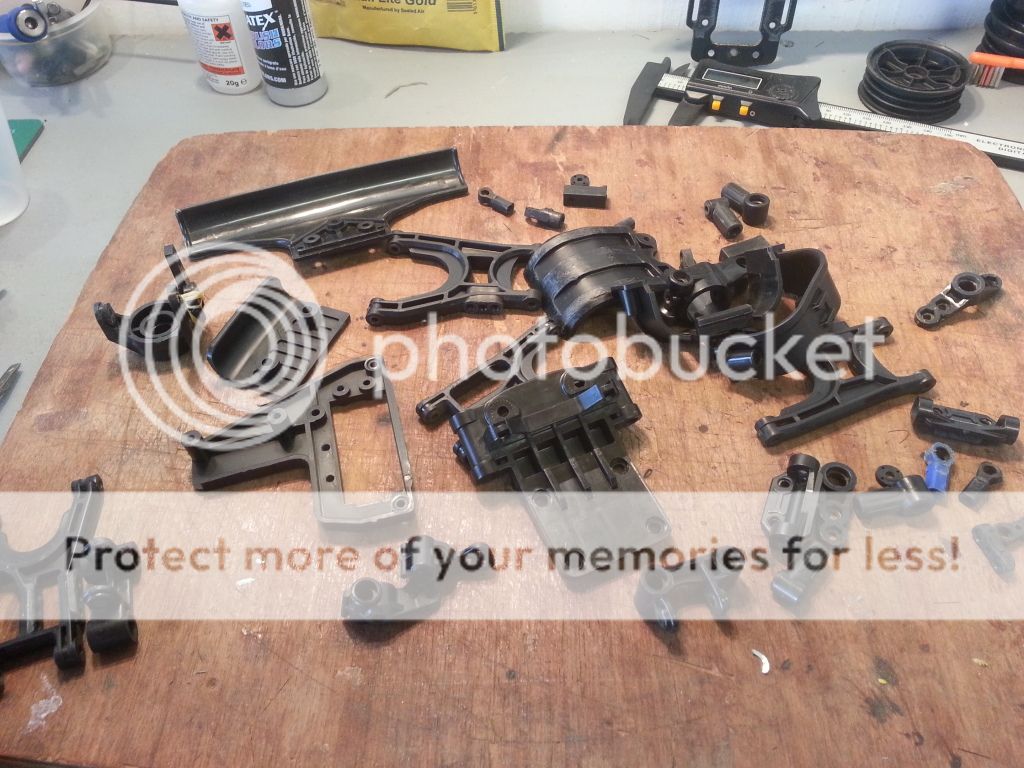

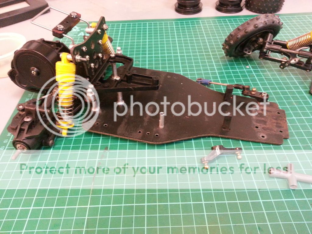

First job was a tear down and a good clean.

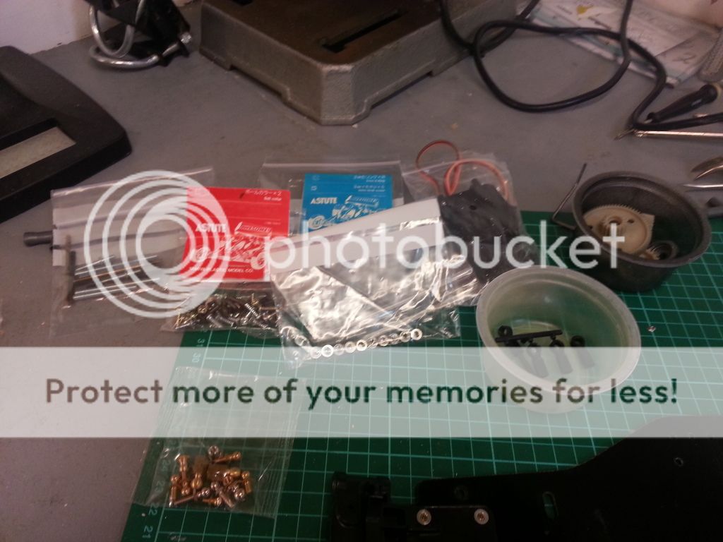

I also noted all the bits that needed replacing or were just missing.
A lot of the fasteners were rounded or the wrong type just used as make shift repairs.

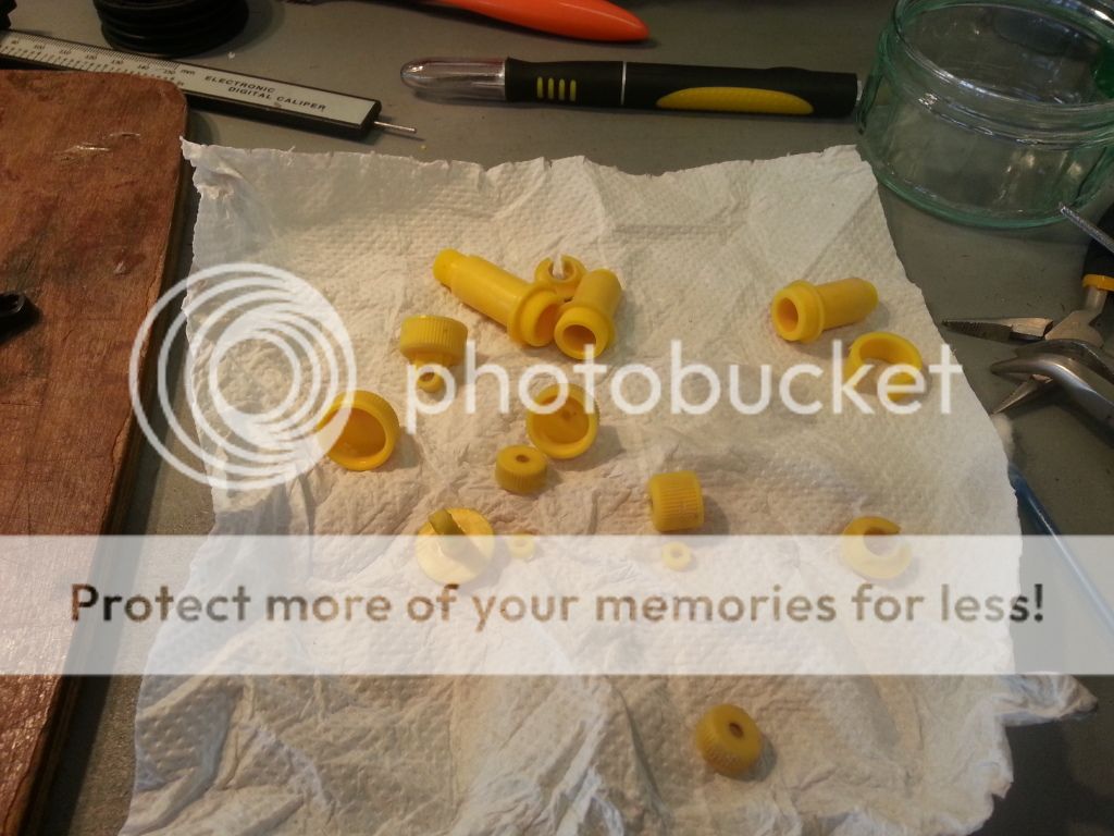

All the parts went through the sonic cleaner for a first pass. If you've not tried one they are great machines for cleaning RC car parts.
They work more successfully on metal parts but also do very well with plastic. Some of the really cheap ones don't do anything but once you get to the 40-50 pound mark they really are quite effective. I'd also recommend one that heats as well, it just helps soften all the grime.

First up one the rebuild was to put some clear coat on the chassis. The chassis had a fair number of scratches and scuffs and I wasn't sure if a layer of clear coat was a good idea or not.
It really made a nice improvement giving the dulled stuffed patches a nice new shine, it won't mask the deep scratches but worth doing.
Also the front arms were badly scratched so I gave them a good sanding moving to finer and finer wet and dry to get an reasonable finish but I think they'll need replacing at some point.

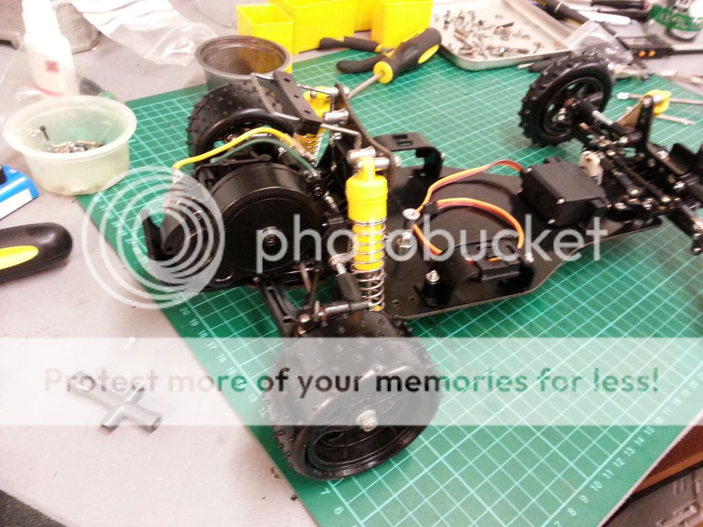

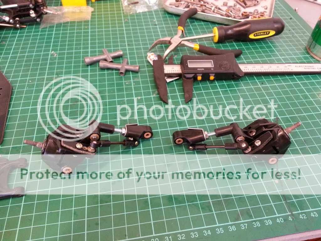

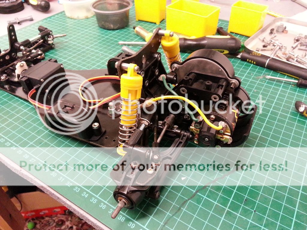

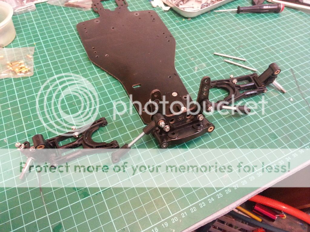

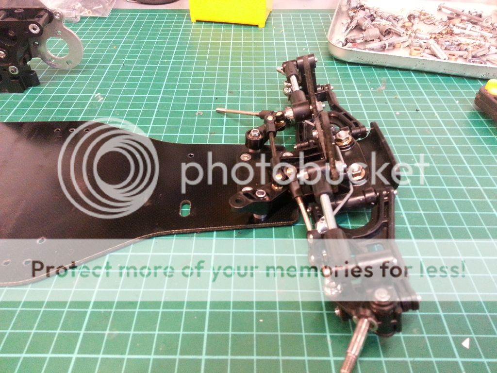

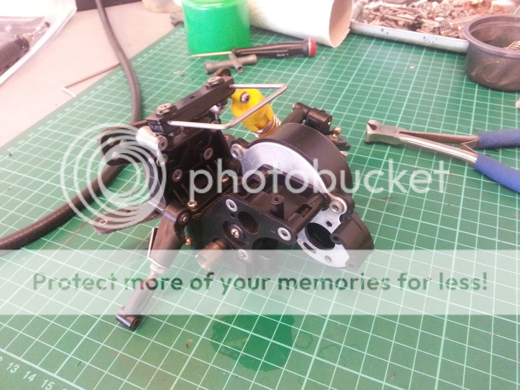

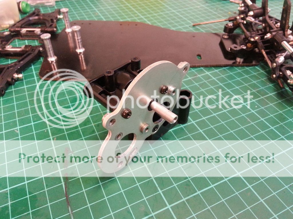

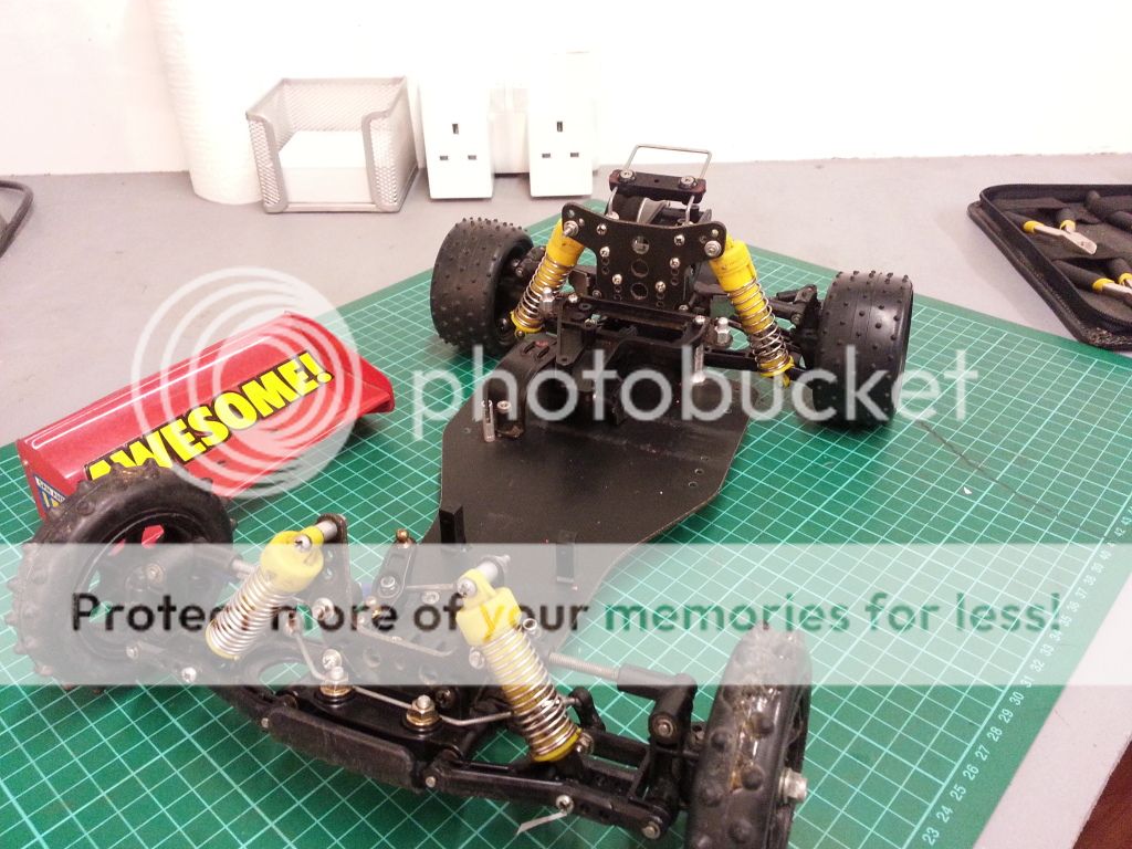

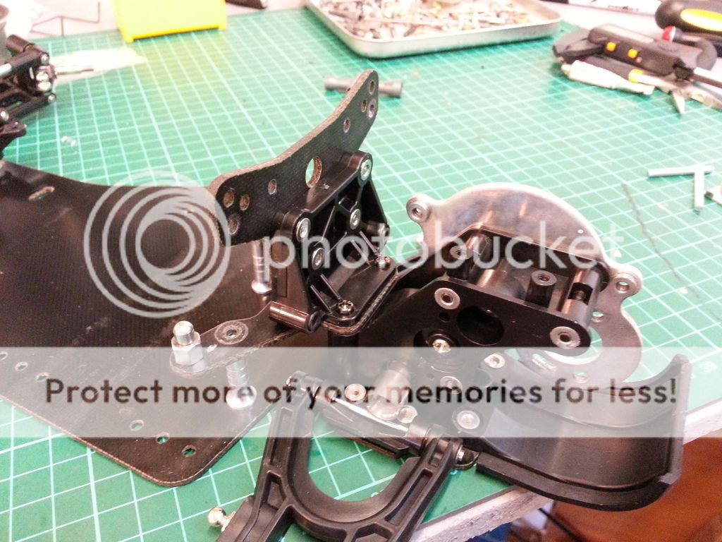

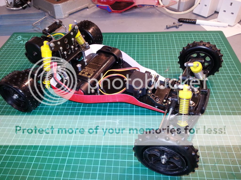

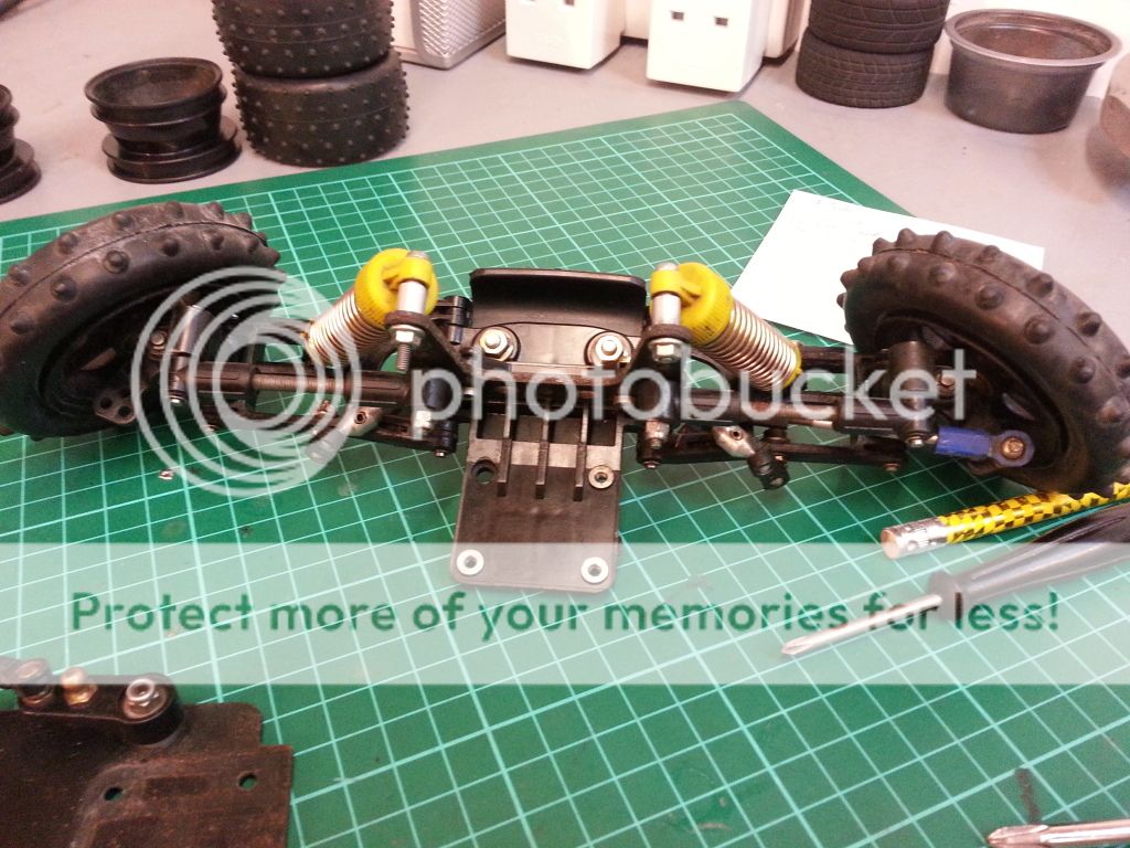

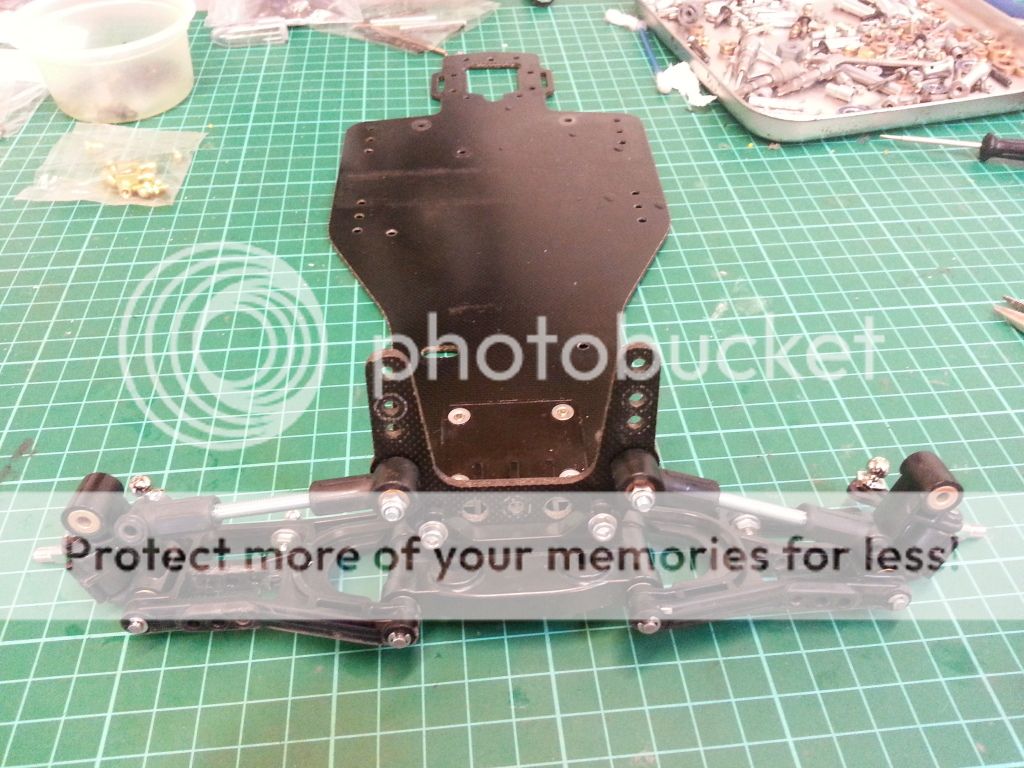

Some pics of the reassembly.
More reassembly. Cleaning each part as I went along if it needed a little more, also tidying any poorly cut stubs on any parts when they were removed from the tree. Looks like not a great deal of care went into assembling it the first time around.

Thanks for the comments and you're right about all the screws and bearings. It feels well made engineered though. I was originally going to replace all the metal bearings with ball races but it doesn't seem worth it for all the pivots so I've just done the drive train and front wheels.

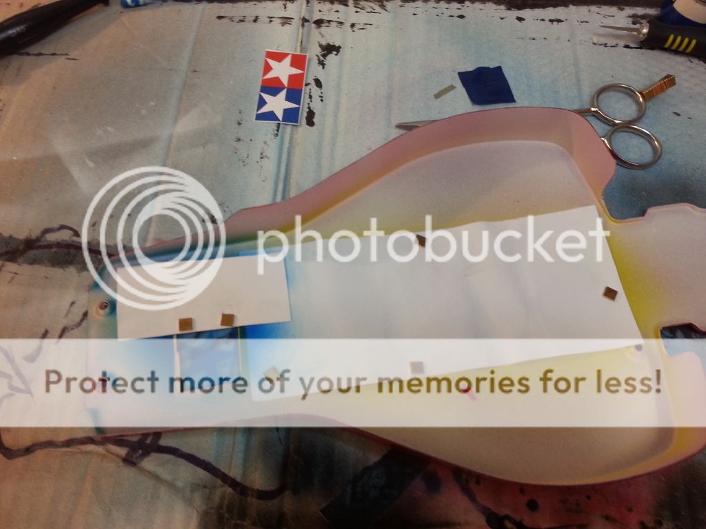

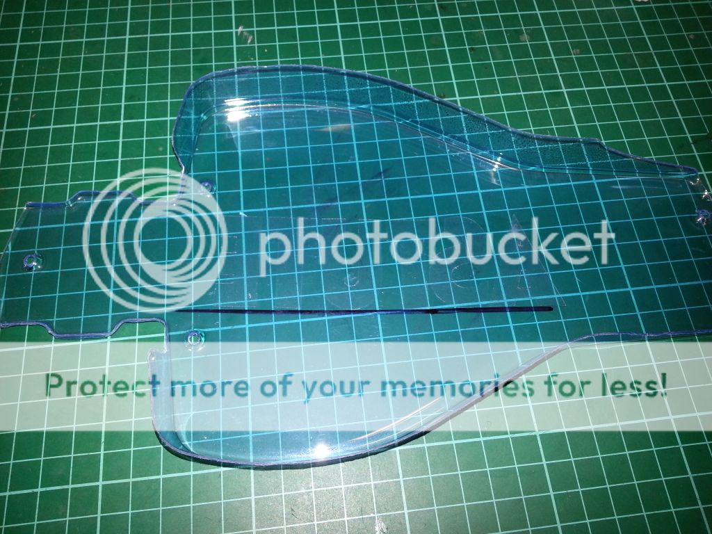

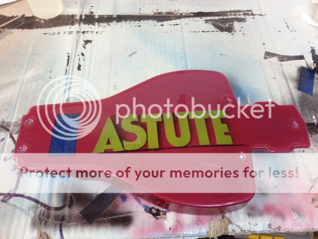

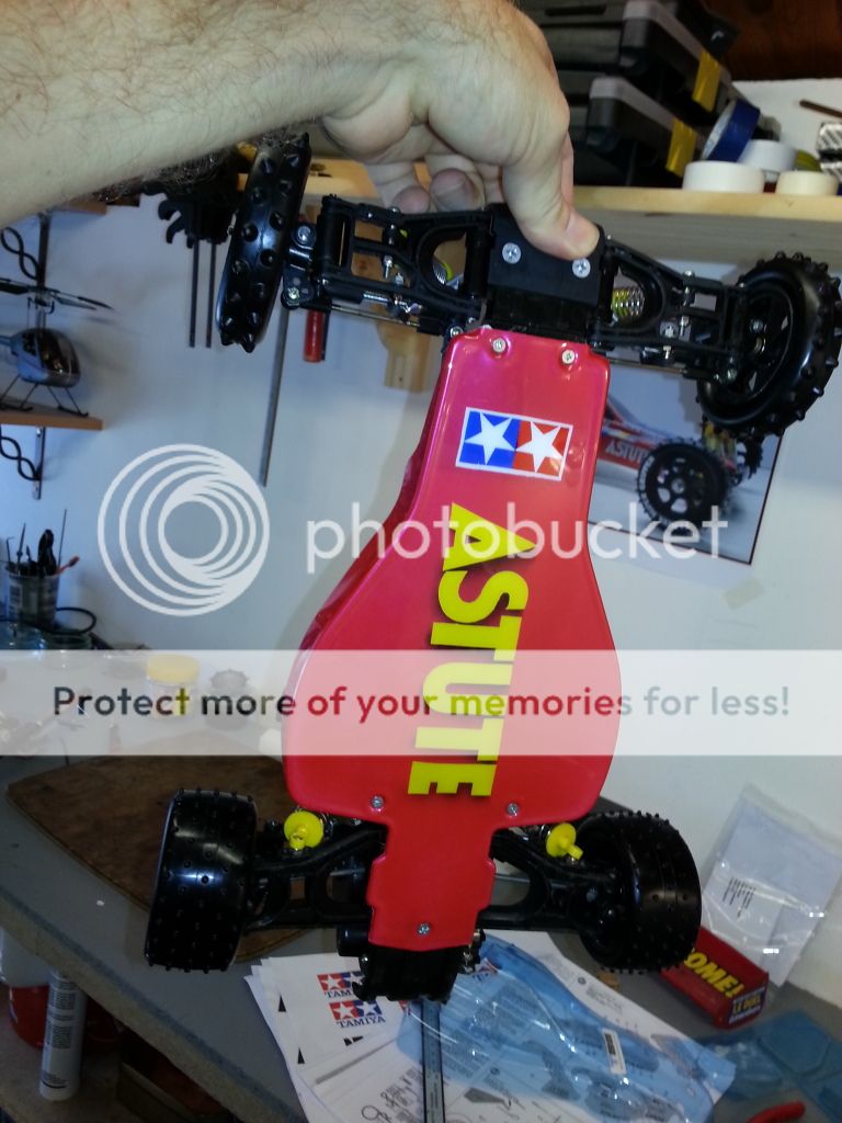

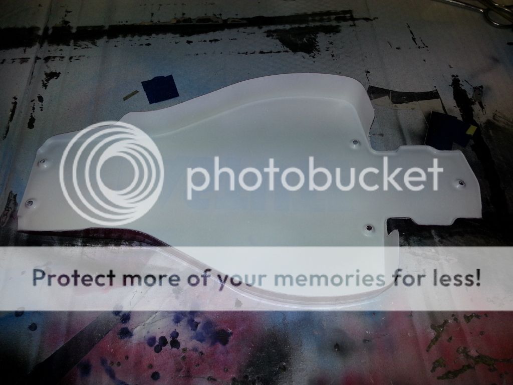

Next up is to start on the new body and under tray. I got a reproduction and it looks very good so far I've not finished with it but so far it looks nice.

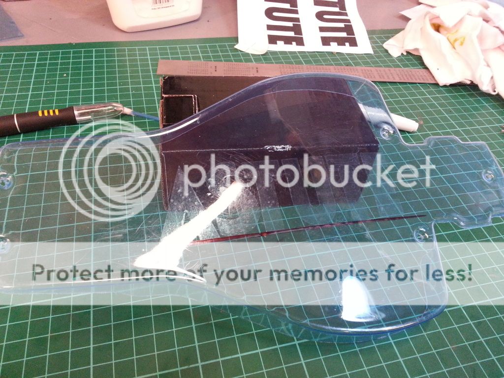

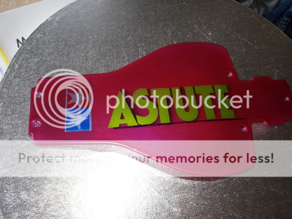

Got the under tray cut out, sanded down and washed with warm soapy water. Its not very often I get a large flat area on a shell to work with so I thought I'd try a couple of thing out with the tray.
Next step was to print out some lettering on to paper, cut them out and use them as a template to cut letter form sticky back plastic. I'm not so sure how well the picture have come out but you can probably make out what I'm going for.
Once I was happy with the lettering I started the painting.

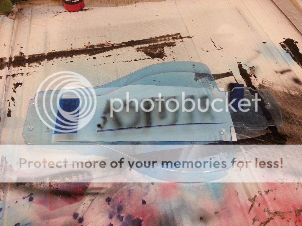

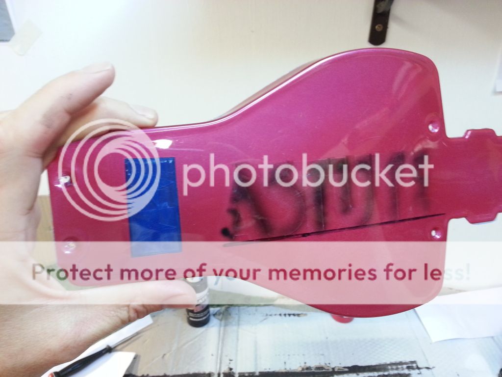

At this point I had a decision to make, either just paint the letters in plain colours or try to use some black to outline one side of each letter to make them stand out a little.
Bearing in mind my painting skills aren't the best I wasn't sure if I should risk the black. Well I thought if I never give anything new a try I'll never get better so I went for it with the black. If the worst happened I could always soak the tray and start again, it water based paint so it should come off.
At this point I'm thinking this looks really bad I think I've made a mistake here. It didn't help that I didn't really think and used opaque black rather than transparent which would have give a much more even coat.

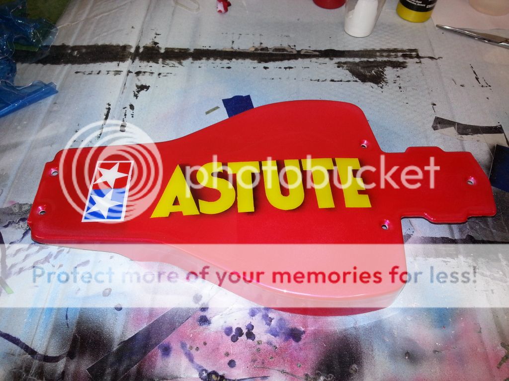

Anyway even with my doubts I cracked on with the main red coat.

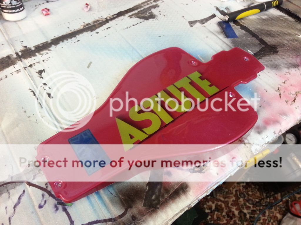

Backed the red with white
The colours look slightly odd as the over spray film very blue and gives everything a funny hue.

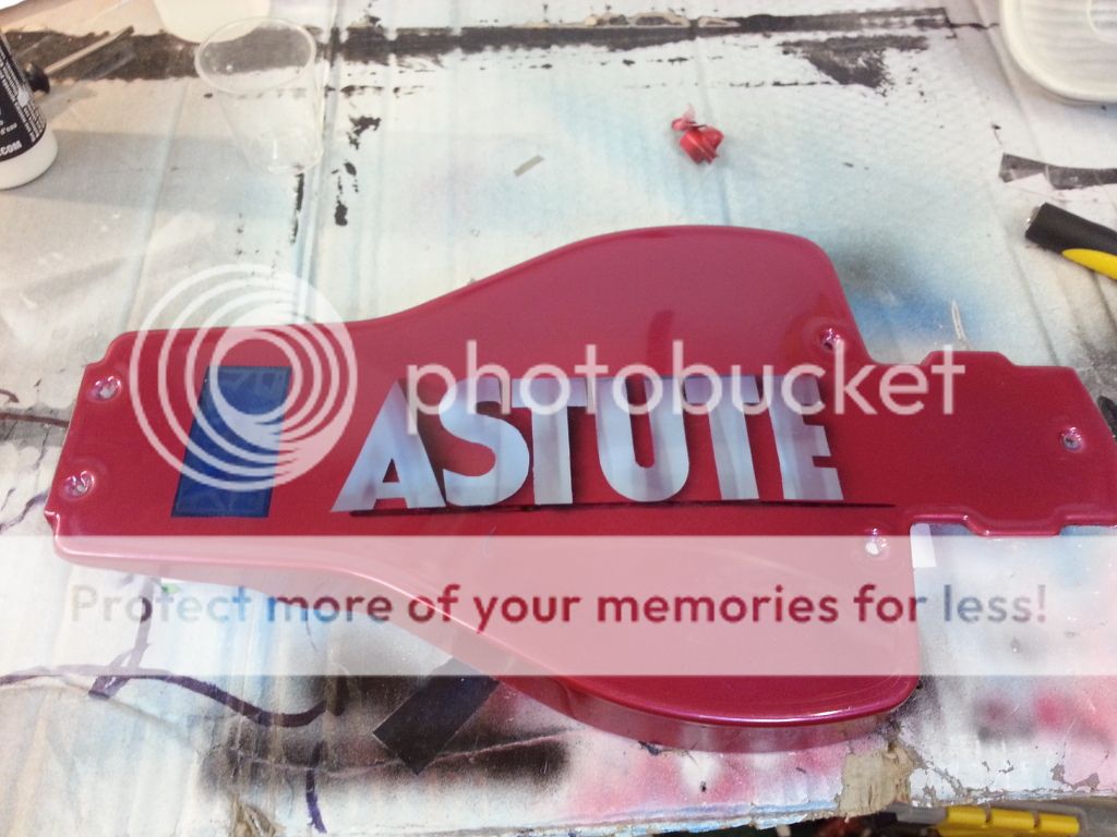

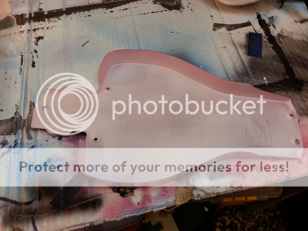

Almost finshed with the tray now, all that was left was to spray the read, blue then back it all with white.
Blue done, on with the red.
All done bare the white backing.
