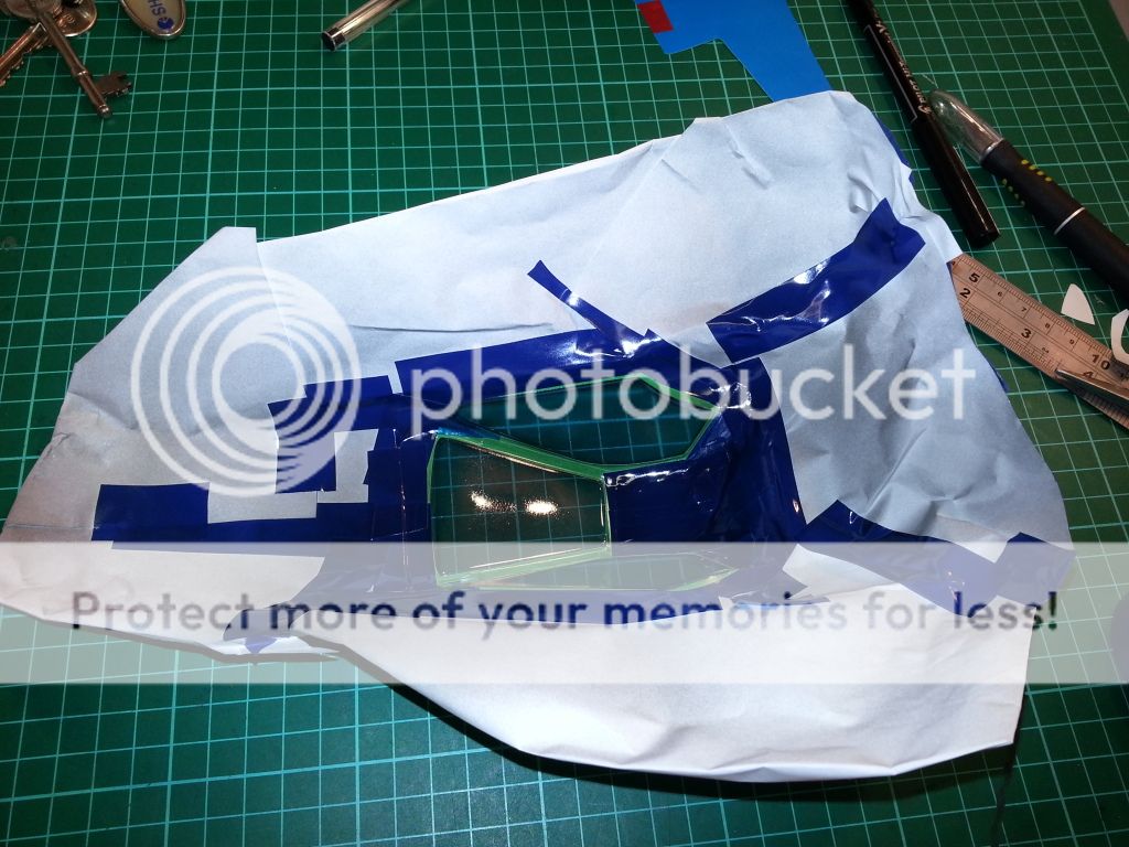

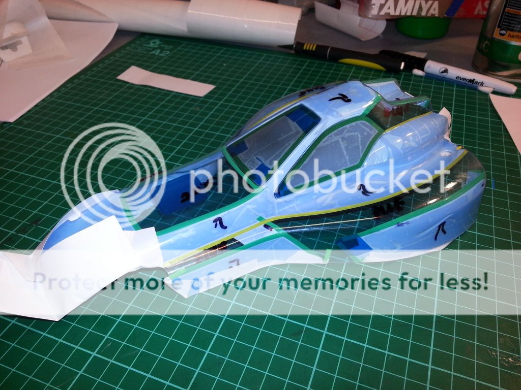

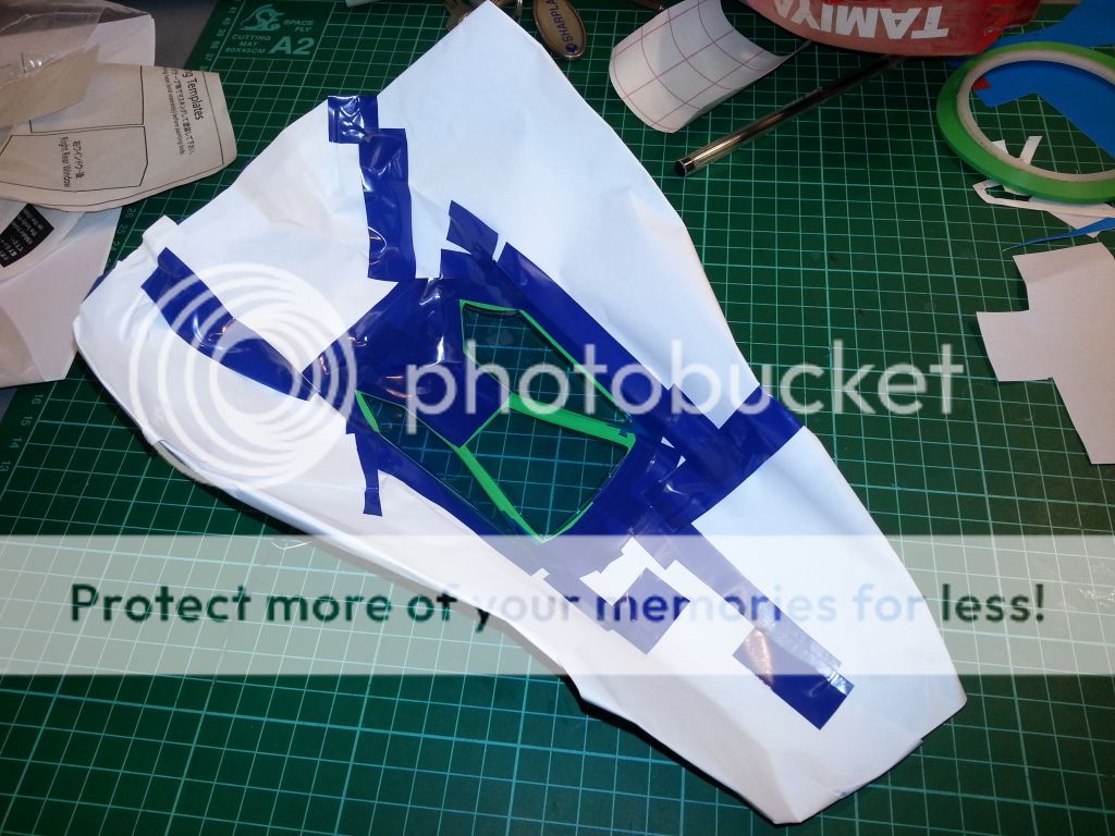

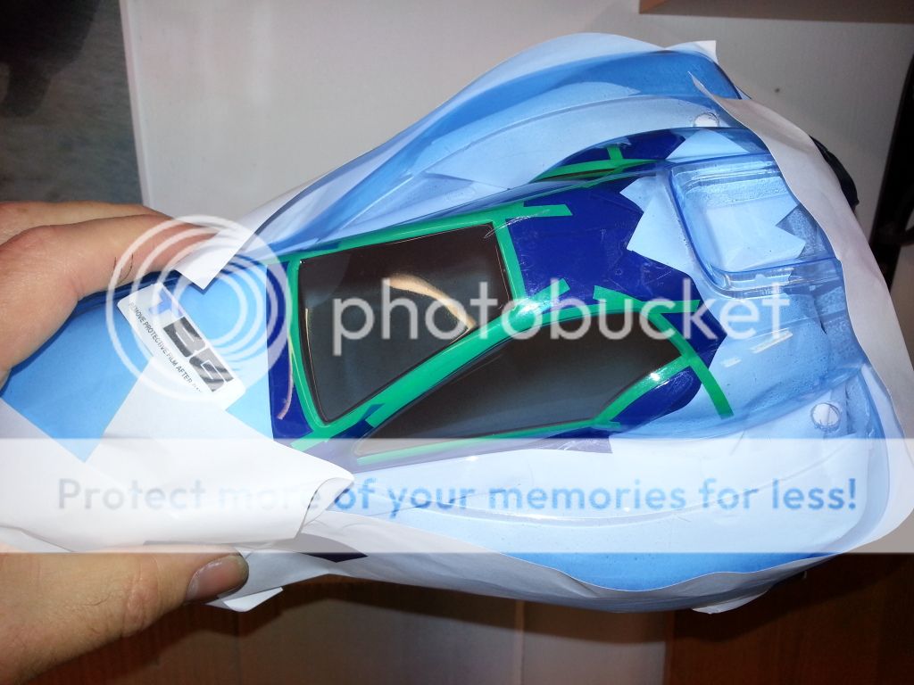

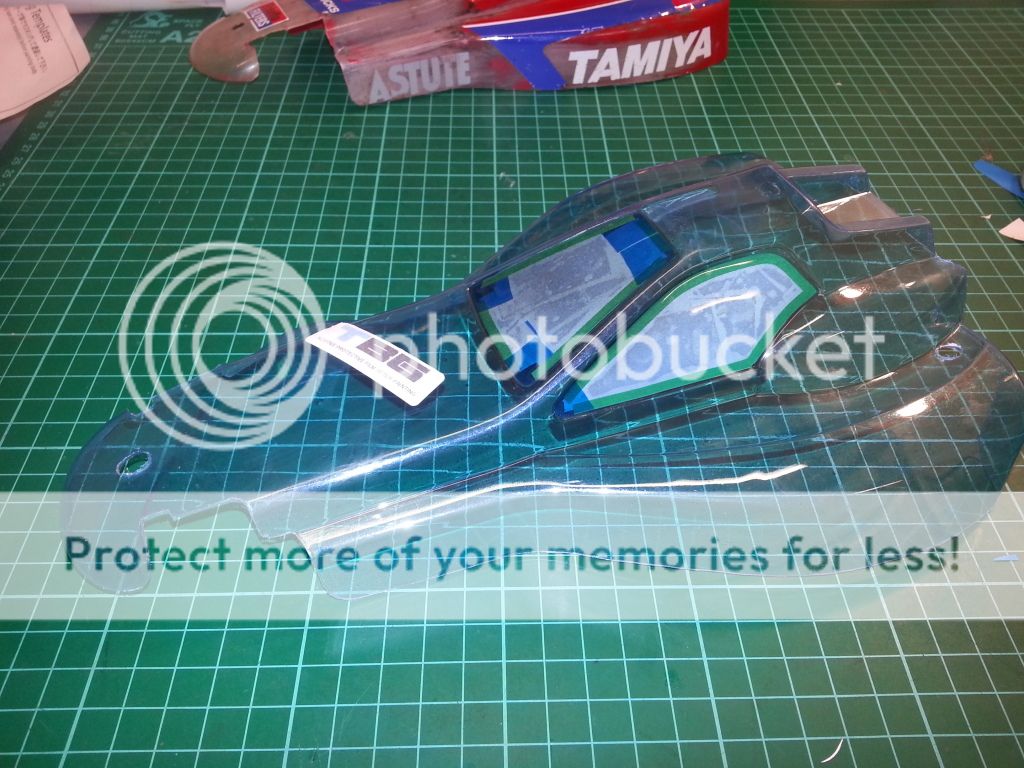

I took your advice and smoked the windows this evening. First off I masked everything but the windows they gave it a few light coats. This isn't the normal way I've done smoke but the solvent would destroy the water based paints if I did it at the end.
Doing it this way does mean I next have to mask off the smoked area very carefully around the edges before I start the next coats.
Starting the masking.
Got the main windows edged and started blanking the big areas.
All masked.
And after a few coats of smoke
I am absolutely no painting expert at all, but shouldn't you have painted the rest before the windows? At least, that is how I usually do it, when I paint the windows with the "smoke" color.
As he explained it, the solvents in the PS-31 Smoke would have wrecked the finish of the water-based paints he was using for the rest of the body. If he was using standard Tamiya paint all over, it would have been more practical to paint the windows after every other layer.

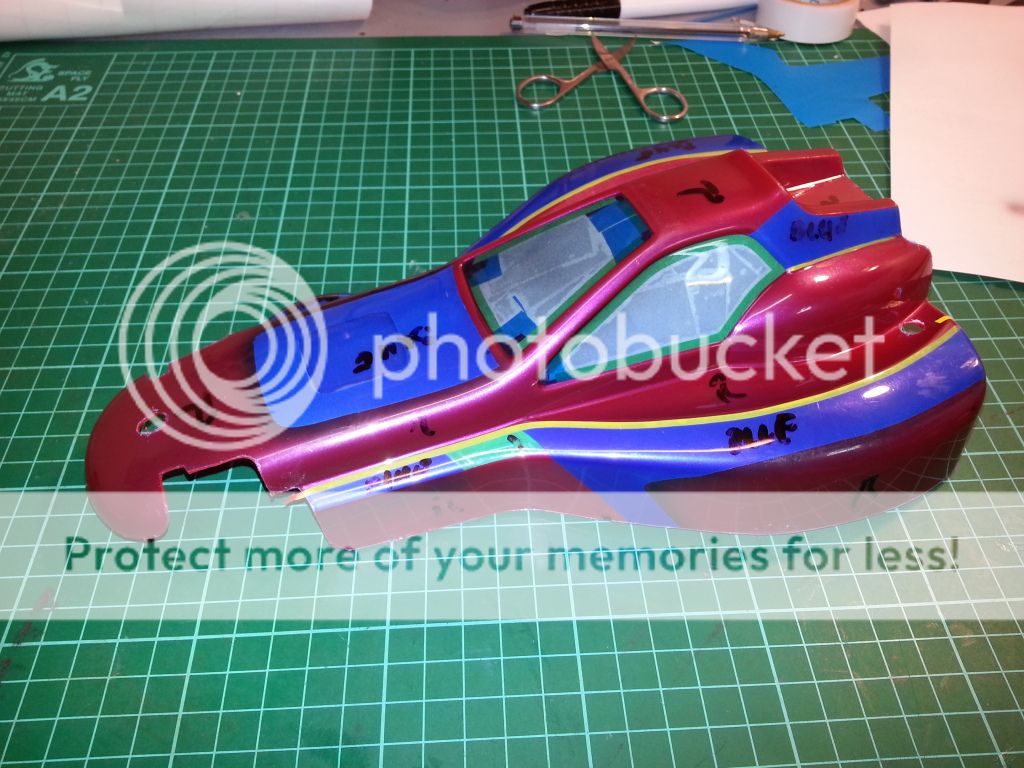

Got a bit of an update, I've done some more of the body.

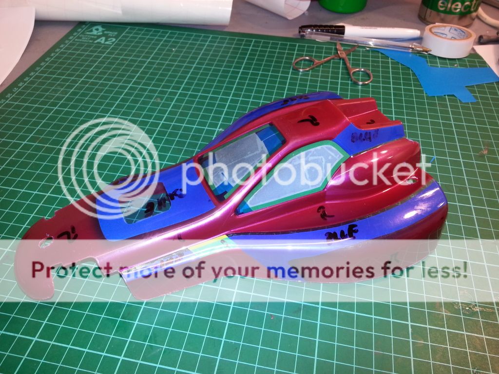

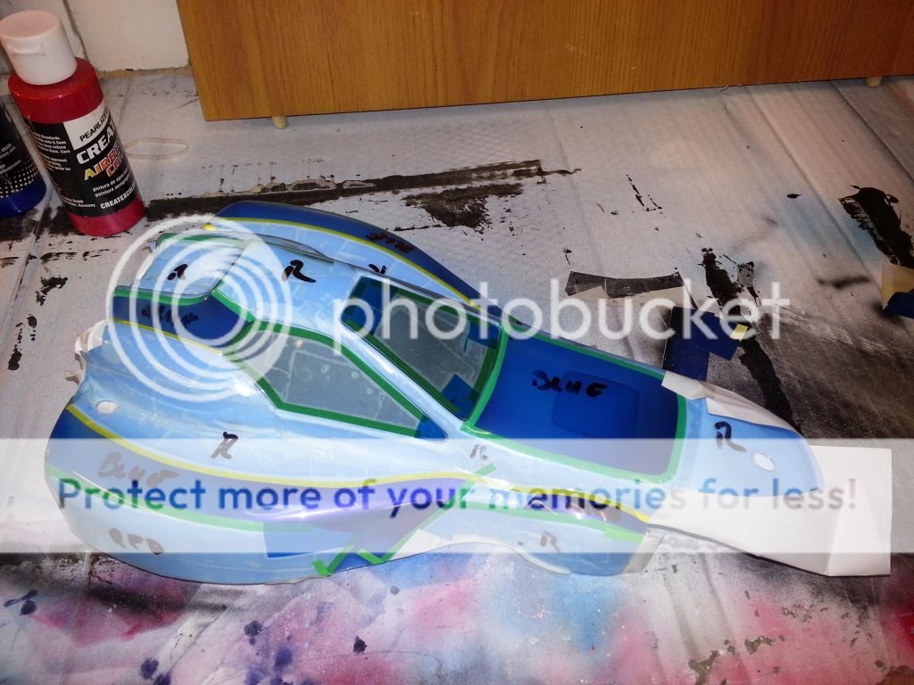

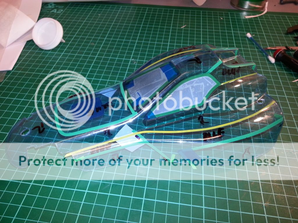

First off got some masking done of the smoked windows

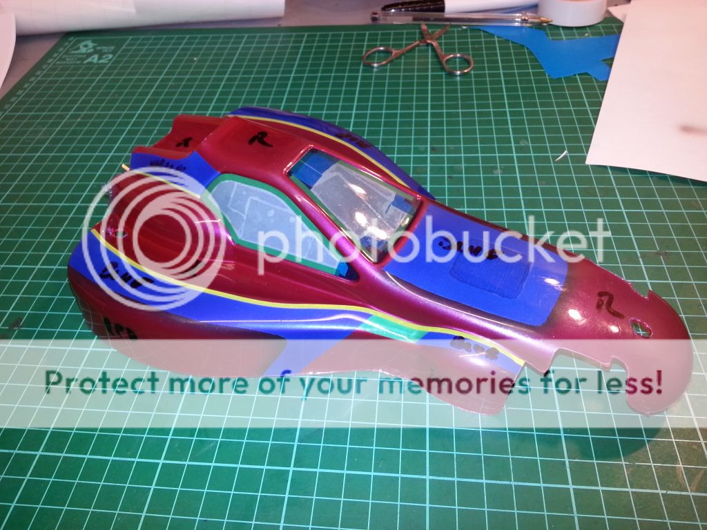

Then outlined the remaining areas, the yellows going to be the white stripes eventually.
Then masked all but the blue areas.

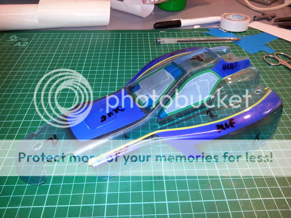

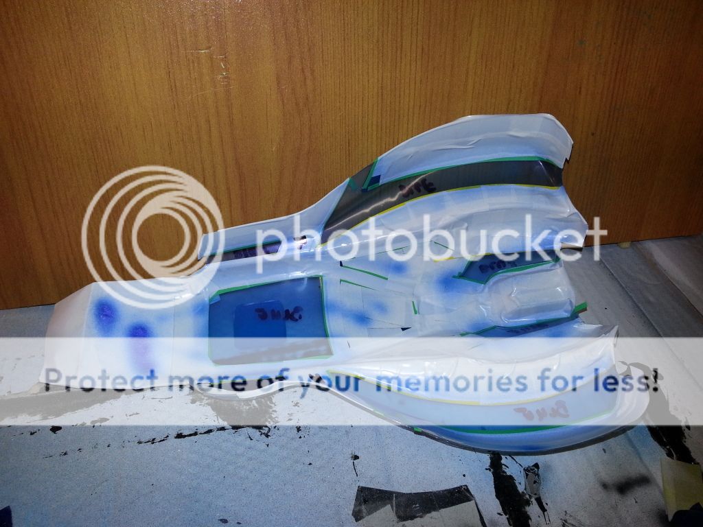

Made a bit more progress today, not all good progress but l'll show you that in further on.

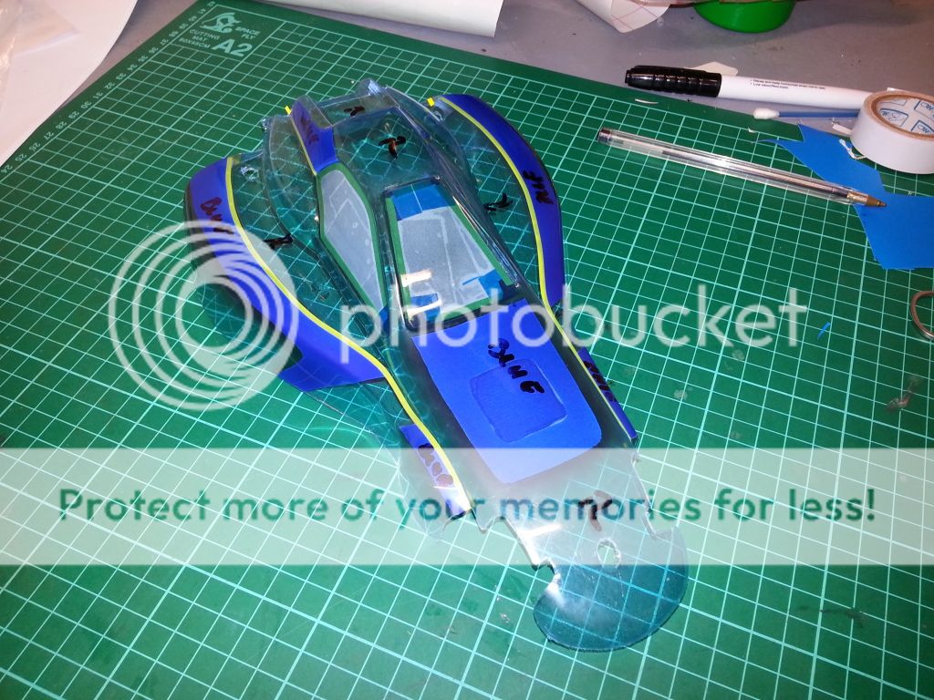

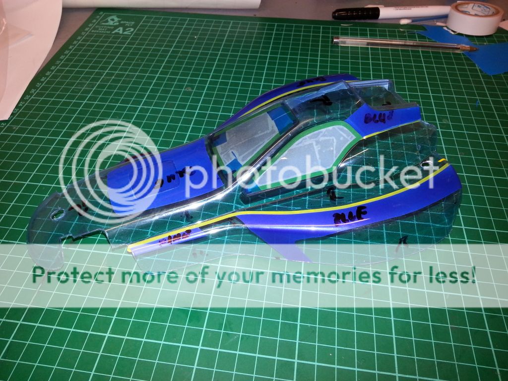

First removed the masking for the blue.
Then I liked how the black edging worked on the tray so I thought I'd edge some of the blue. Thsi time I used pearl black as it flows a bit better than opaque and I thought I might get a more uniform shading.

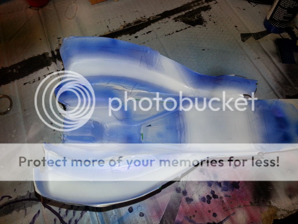

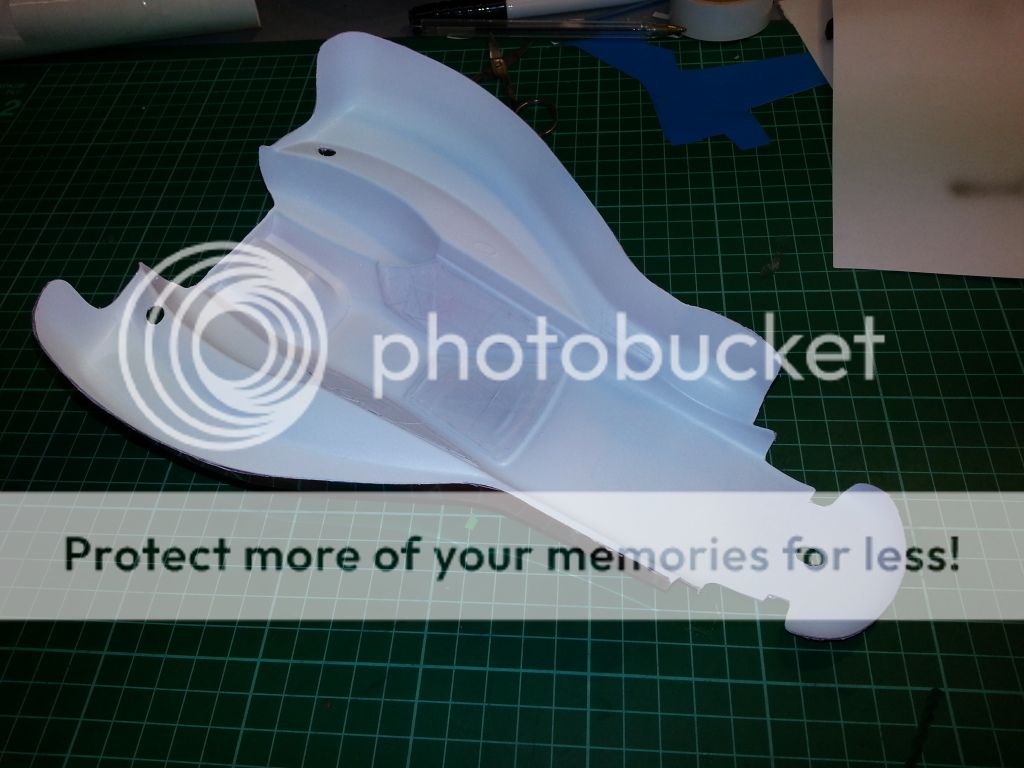

backed with white.

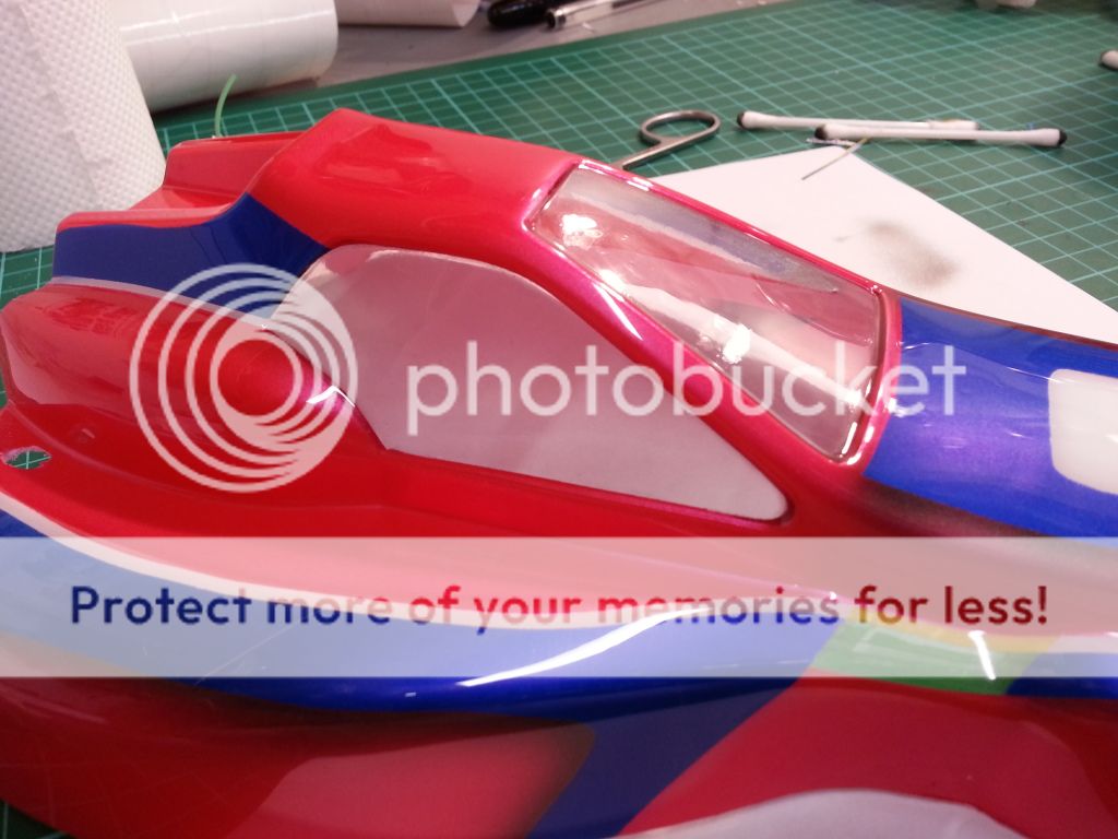

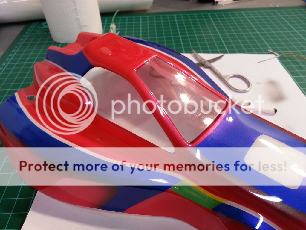

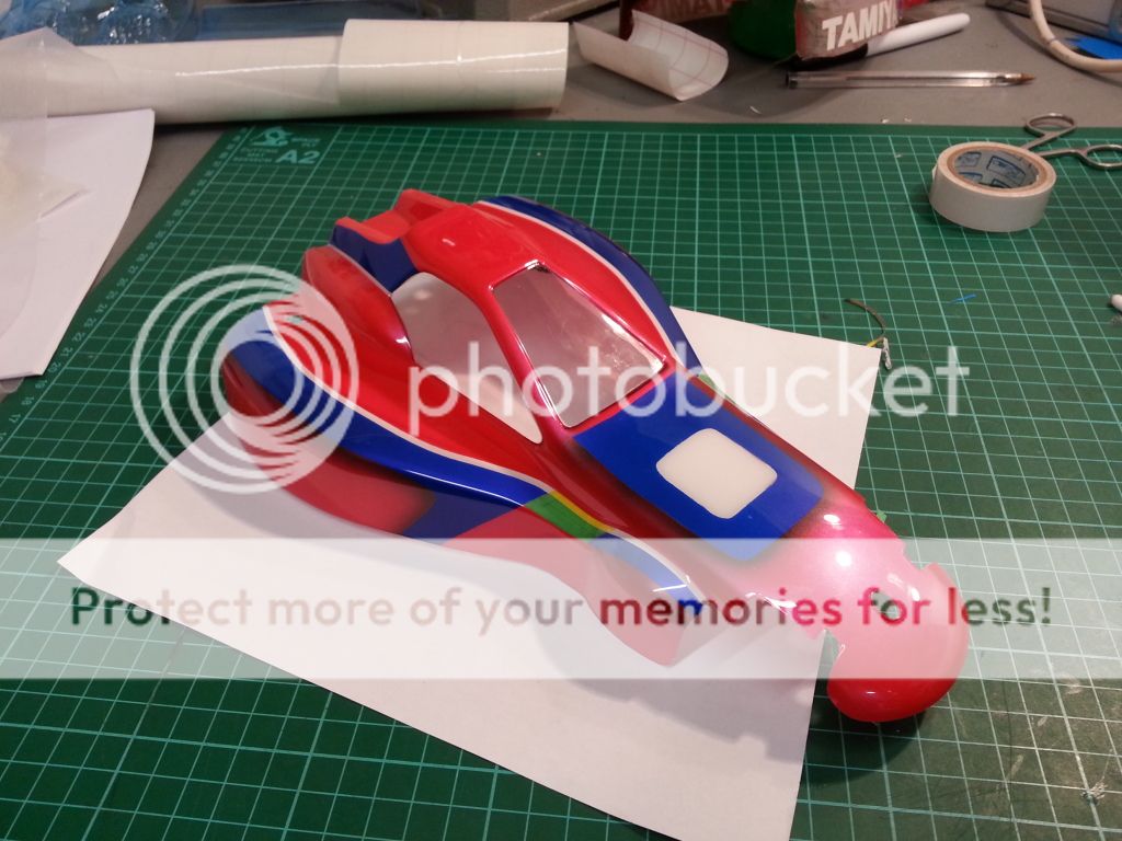

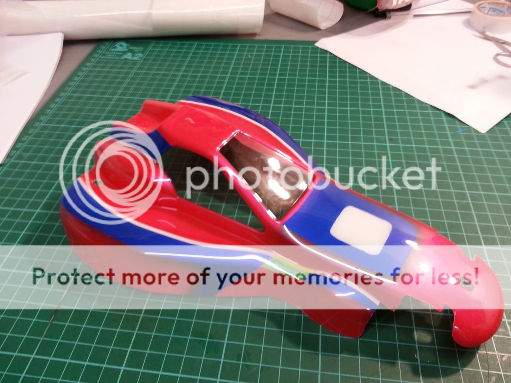

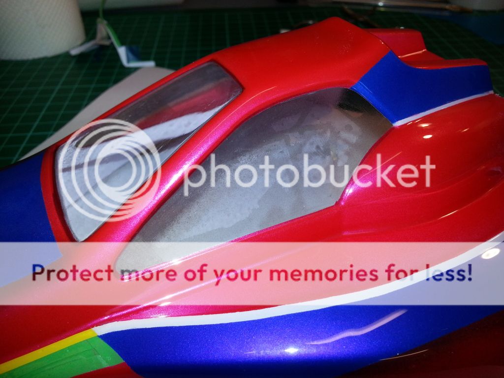

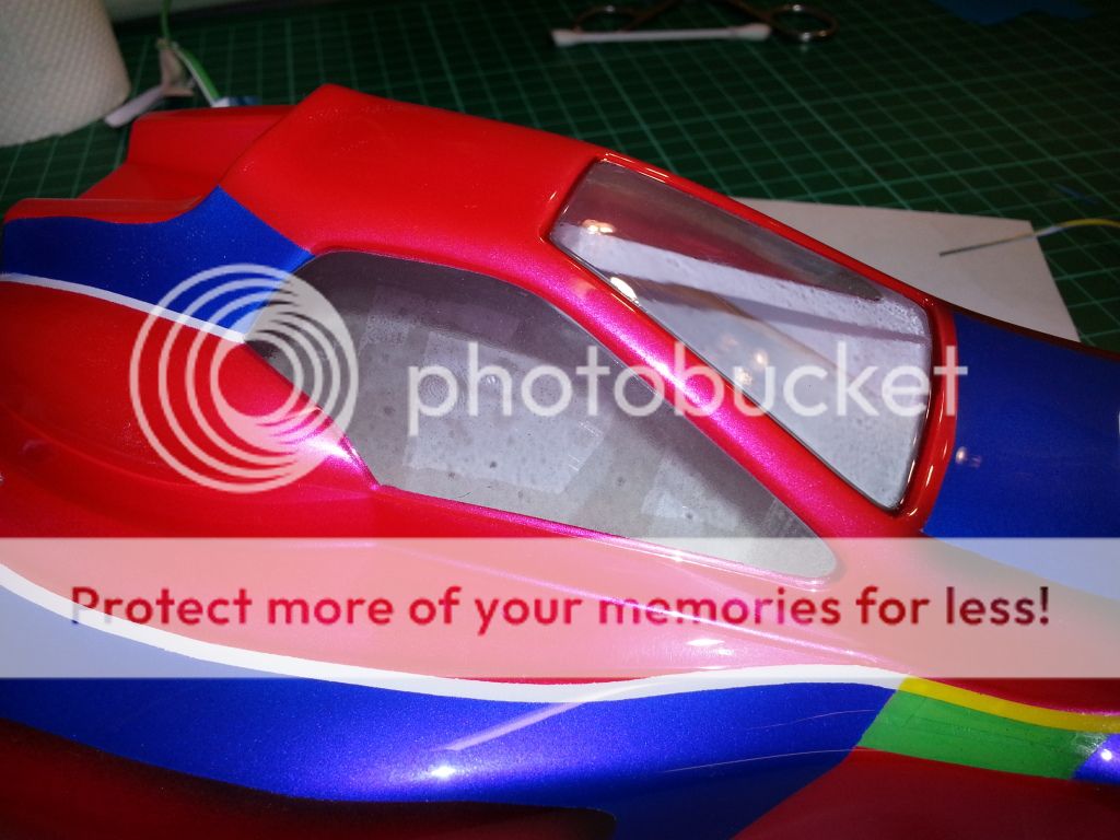

At this stage I've still got the yellow and silver stripes to do but I'm being impatient so I start to removed the window masking. This is where things go wrong. The mask on the windows has done two things, left loads of sticky residue behind (guess the solvents interacted) and removed some of the smoke!
After a bit of ohhh ***% what a waste of time, effort and money I thought I might as well give a repair ago. So with a load of cotton buds and some electrical contact cleaner I set about cleaning the windows.
This was a slow process, the smoke didn't really want to come off and I had to be careful not to damage the red. But after ages it did come back to something like.
The other thing I'm not impressed with is the white square on the front. The edges are really poor, not straight and had a bit a bleed. This was a simple flat area and I thought I wouldn't be an issue So I guess I didn't give it enough attention and concentrated on the hard areas.
Anyway here it is so far. I've still got the yellow and silver to do but I think I might brush these.
Any comments and ideas to improve it very welcome :-)
