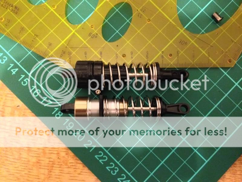

What is the standard length of the CC-01 shocks ?
I wonder how much longer these new ones are ? - if they are 70mm then they'd be ideal for my Wild One project (although I just fitted Topcad internal spring scale units)
I suspect they will be the same length as the kit items to be honest, looking at the pictures anyway. I don't think they would release a hop-up which raised the ride height, I think they are just for better performance (or in my case, a bit of bling...)

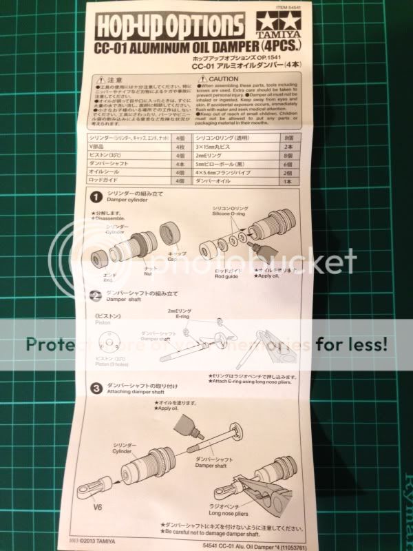

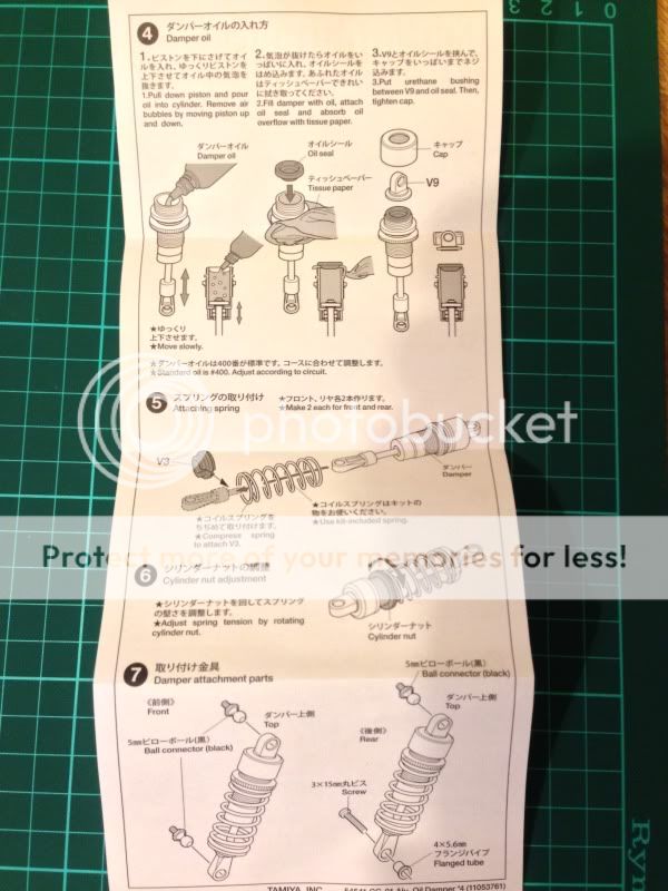

I went ahead with the alloy shock set but passed on the articulation things @£16
The shocks themselves are of good quality, the adjusters are actually black plastic I reckon instead of alloy.

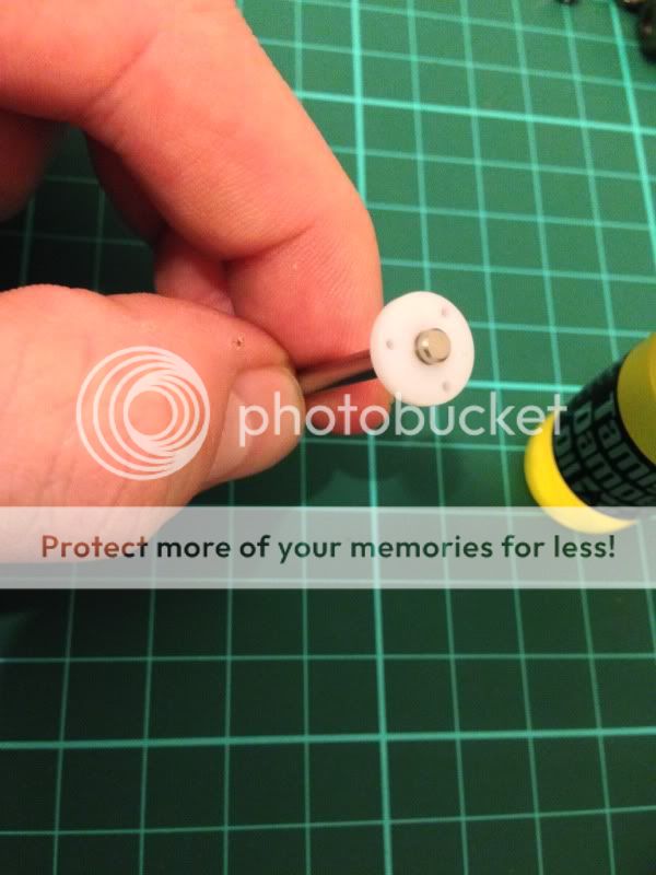

The piston thingy is either moulded in white plastic or is actually nylon (which would make sense as they would generate less friction) depending on how cynical you are, you decide!

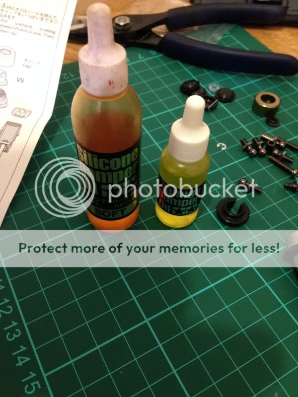

Kit comes with the 400wt yellow silicone oil but I had a big bottle of slightly less viscous 300wt orange stuff.

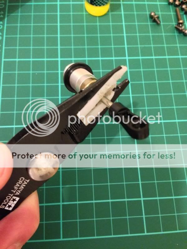

This is the part I hate most about assembling any shocks - fitting the lower connecting adjuster to the piston rod! As a side note, does anyone know if there are replacement plastic 'jaws' for these tamiya pliers? As mine are a bit...broken
Someone asked what length they were too. Standard CC01 on top, new alloy one below. Both approx 71mm eyelet to eyelet.
I snapped the instructions but they are very straightforward to assemble...
