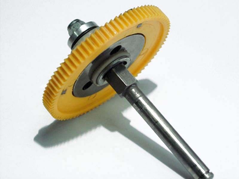

As you can see the gear ratio is very high and I did use a mild motor (17x3) so my car was too slow.
So I decided to made a modification to my TTC spur gear. I cutted away all teeth and replaced the entire spur with a 48P one, in order to find a bigger pinion gear for my car.
