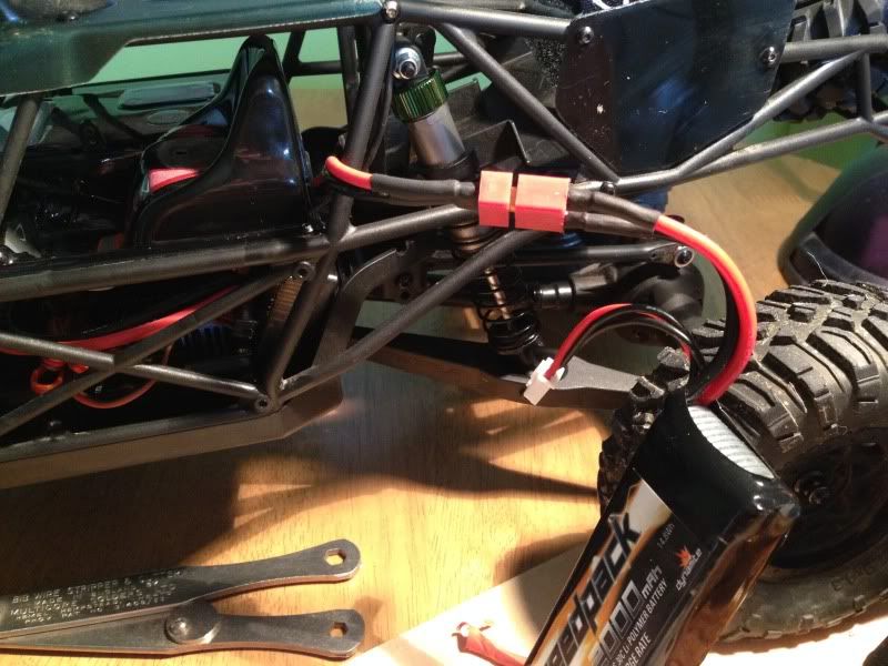

Started fitting the Deans plugs last night and found like some had mentioned they are actually labeled + & - which I hadn't noticed before. Now I'm no soldering expert but it actually went pretty easy. I know some people have issues fitting these so I thought I'd show what I use.
I have an old basic soldering iron that's rated 25w still with its original tip, I must've had this for over 10 years at least. The solder and separate flux is from a store called Clas Olson in the UK. It wasn't cheap but is very good and lasts for ever.
The method I follow is I usually file the surfaces I'm about to solder a little and then wipe them with the flux and heat it on the tip until it burns off. Then add some solder to the tip and bring the surface to it until the solder flows and covers it nicely. Do the same with the wire, removing the insulation and tinning the ends first as described above. Then I add a little more solder to the tip and bring both the wire and surface (in this case) together onto the tip and hold it until I see the solder freely flow into and over both. Careful remove from the tip and watch it cool before letting go and putting any stress on the joint.
I should say between every section I wipe the tip with a damp sponge and I usually clamp the tip in a vice so it's the work that I'm holding. Unless I need to get into somewhere fiddly I find that's the best way for me. Took me about 5 mins to do a complete pair of male and female Deans plugs, taking my time. I even remembered to slide the heat shrink onto the wires first ! And my fingers were only "mildly warmed" by the whole experience :) Now to do the rest of my stash of batteries and ESC's. Actually I'll make up a few Deans to Tamiya conversion leads with some of the connectors I remove, should come in handy.
