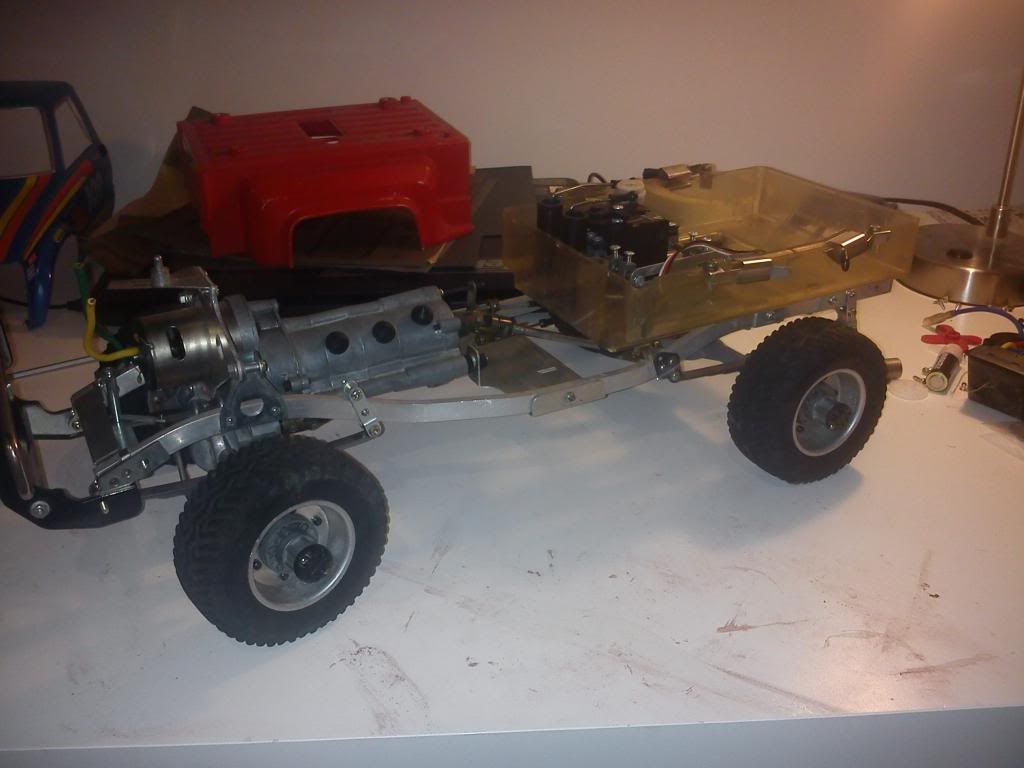

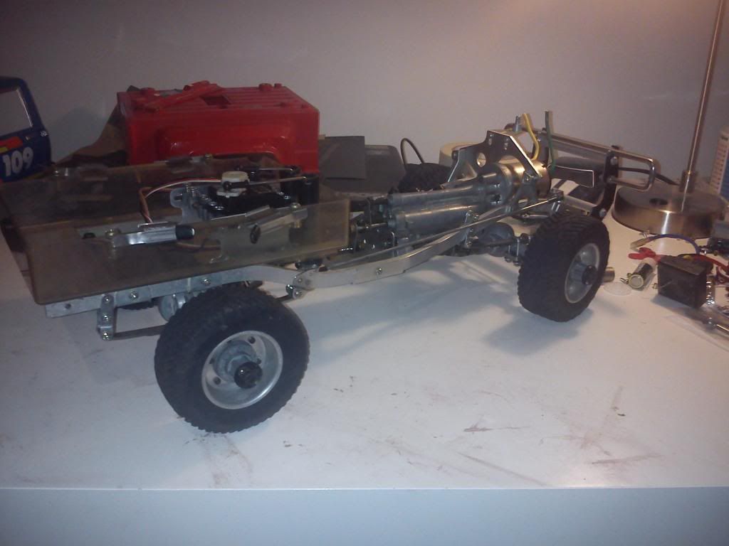

This is how the car looked after the first 3-or-so batches of parts, the first time it was assembled:
Chassis:

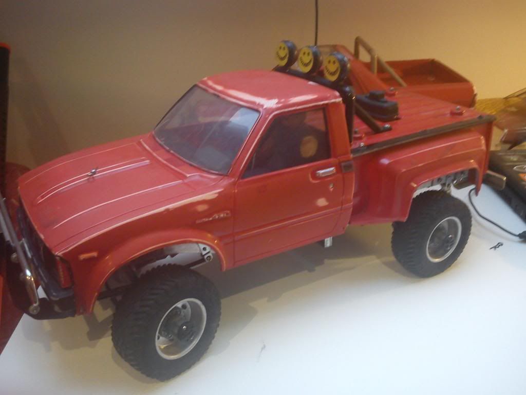

This is how it looks now:
I have had it running, but solely to test the mechanicals. I had to replace the counter gear with the only one available; a brass one. It has no chamfer on the end like the stocker so it does struggle to shift into third while moving, something I need to fix so it doesn't damage the tubular rack that slides over the counter gear.

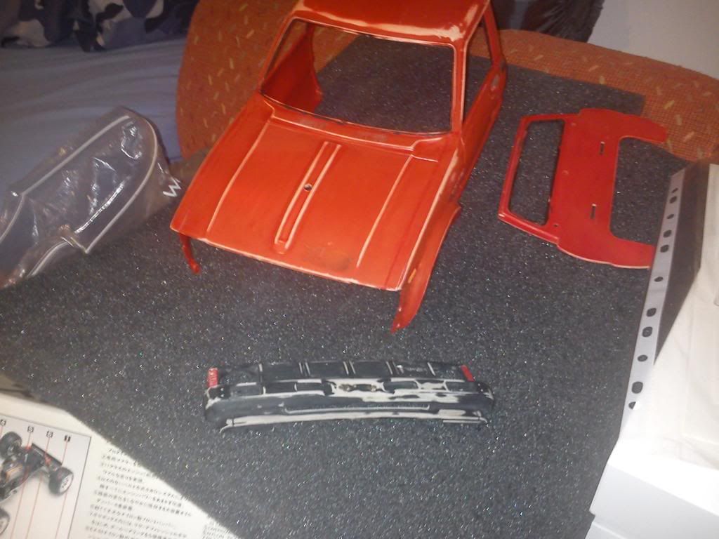

Here's some of the body parts after a little sanding before I repaint them (going with box art red, so don't need to strip it all off. Or do I?)
As you can see, I did end up buying a new cab with a grille as I couldn't find a grille anywhere. Naturally, as soon as I did so a grille became available :rolleyes: . But hey, now I've got another cab. There's a few scuffs and scratches that need filling, and both cab and grille were damaged when I got them, one of the fender lugs and upper mounting post were broken on the grille, and the corresponding mounting post on the shell was also broken. A dab of superglue later and they were good as new:
Should really have got some picture prior to gluing them, but the thought slipped my mind.

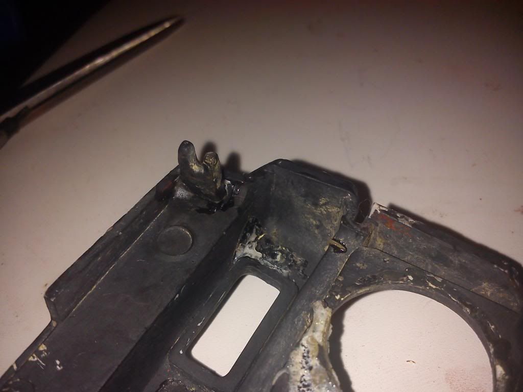

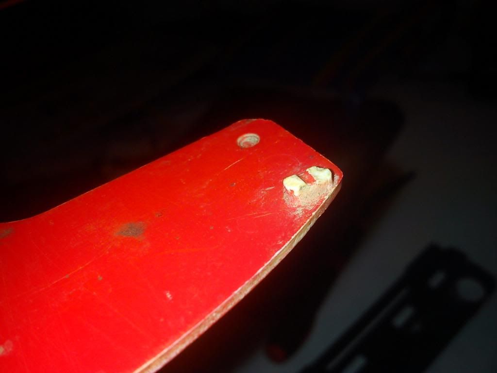

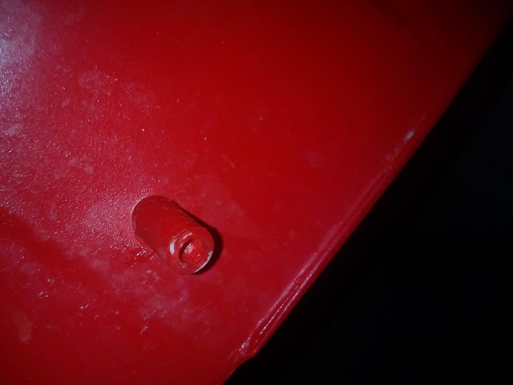

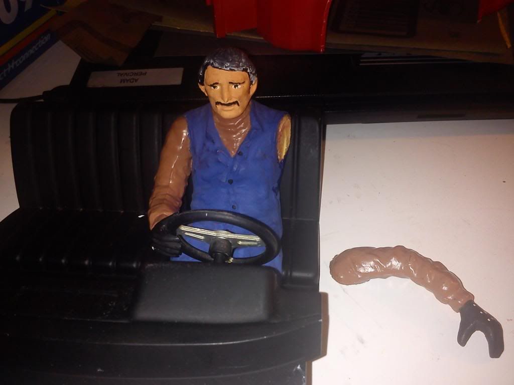

A common problem that I need to rectify with the addition of a little styrene. One of the rings around the holes on the back of the cab back has broken off, and needs replacing too.
Monsieur Tamiya has a light limb related ailment. Nothing a little plastic cement can't fix.

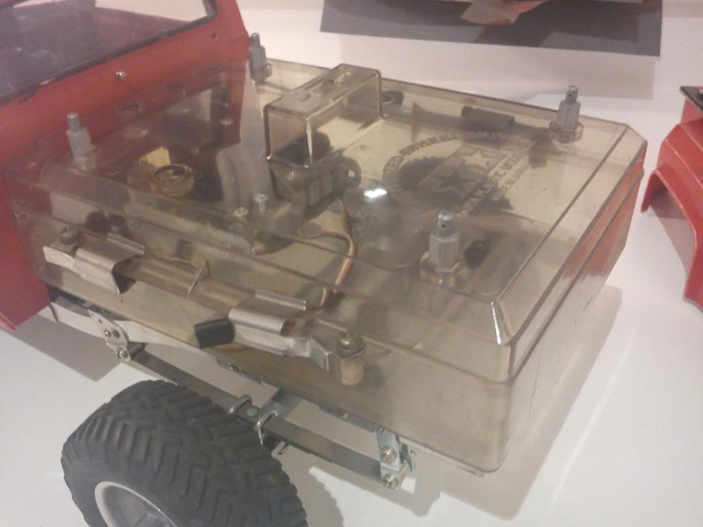

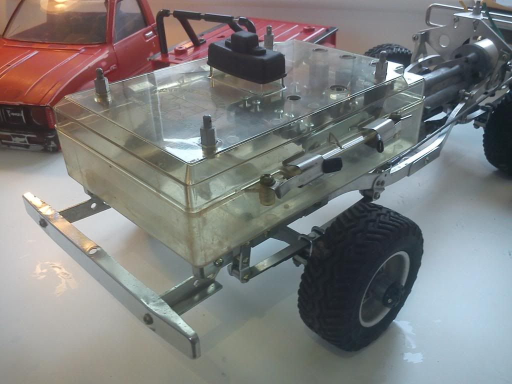

I currently have a new radio box and lid on their way to me, which shall allow me to properly mount the body. The old one along with the blue cab will probably be sold off in a job lot of leftover parts once I'm done. I don't think you can see in any of the pictures, but the window glass I bought has a crack in it. Not sure if I should replace it or try and fix it with glue lots of scratch remover and plastic polish.

With regards to painting, what should I do? just paint over the existing stuff after it's been sanded a little? Strip it all off or go from there? Use primer? I have almost zero experience of painting hard bodies. I do have an old Blackfoot shell to practice on though.
Also, what paint should I use for box art? The manual says X-7 Red, but that's a brush paint and I'd much rather have the superior finish from one of the rattle cans. The closest I have found is TS-8 Italian Red, is that the same colour or do I need to use non-Tamiya paints to get the right colour?
One more thing; what should I use for filling in the deeper scratches? Tamiya do various putties and fillers, but I'm not sure what I ought to use.

Regarding paint, I'd rather take all of the old paint off of it. In the UK you have some products to help, but you can also use break fluid. I usually soak some old towel and cover the body. After a day or two the old enamel will start to lift or turn softer. Then you'd have to use an old toothbrush and/or wooden toothpicks.
Once clean, you can sand it a bit, use some cheap primer and paint it. You can order some original Tamiya paint for it in the UK, although you can always find the other brand, Testors, which is very good and less costly. Now, if you plan to keep restoring old hardbodied Tamiya cars you might consider getting yourself a compressor and a good quality airbrush. That way you can always use the colors you want, not just what's available.
Good luck with the project, and keep those pictures coming!!
On the body, you'll want to strip it down to the bare plastic. Reason being that the new paint you use may not be compatible with the left over old paint on the body and nobody likes a wrinkle finish
There are other ways to remove paint but my favorite is yellow can easy off oven cleaner which is basically caustic soda.
I use body glazing putty from Bondo to fill in scratches.
Make sure to prime the body with a primer from the same brand as your color coats. You'll need it to fill in the minute scratches and give an even body color. The color of the primer will affect how the red will look so try to use white color primer.

Questions aside, my new-ish, undamaged and lid-bearing radio box arrived today, as did the bed rails and number plate. Did a quick mock up assembly to see how she looks now that I can actually mount the cab properly.
Sorry about the focus here, phone camera doesn't quite cut it in low light environments. This is the best I got. Headlight (singular) is being held in with masking tape. ;)

The, paint, primer and putty linked are correct. The brake fluid suggested by others is the standard DOT 3 fluid can be bought at any auto parts store. I have stripped with brake fluid but I prefer the Easy Off oven cleaner. I know this is a US product so look for for a heavy duty oven cleaner at your grocery store
Don't skip the primer coat regardless of how well the body paint strips otherwise the paint will run and pull away in the body lines.
You will need at least two cans of color coat. For Italian red you might want to spray a base of pink.

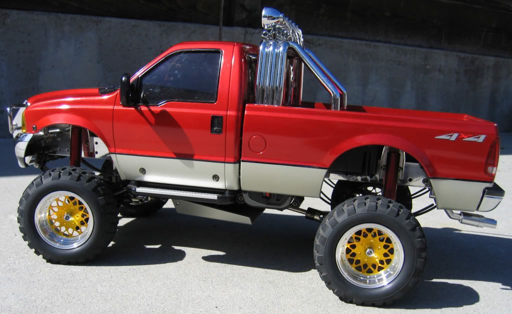

You're starting with a far better body than I had. My Hilux came from Canada and it was extensively damaged in shipment. The transmitter stick had its way with the cab and punched a few holes in it. I stripped the body down best I could. Then I glued the pieces I found in the bottom of the box back into the body with a product called plastiweld. Then I used the bondo glazing putty to smooth out any imperfections. Then came the primer. I smoothed the primer with 1000 grit sand paper then shot another coat or two. Basically you want the surface to be as butter smooth as possible and consistent in color. The non metal flake TS paints tend to be on the thin side so several light coats are better than a few thick ones. You might get paint runs, don't freak out. Just leave it alone to fully dry and sand them out. When I'm satisfied with the paint job I give it one last wet sand with 1500 grit paper and spray one final color coat. Let that dry then spray some clear coats to give it a deep shine. I cannot stress enough to take your time. As for color, you could go with the Italian red and have your truck look just like the other 50+ one here on TC. If it were me, I'd go with Mica red as it's an awesome color
Example of mica red.
Here is my Hilux
Here is my Hilux
Thanks for the advice! Which of the mica reds is that, since Tamiya do two? TS-39 or TS-85?
Still considering what colour to go for. The more I look at that F-350, the more the colour grows on me. But I'm also thinking about blue, like the one in the old TV commercial. Decisions, decisions ;) .

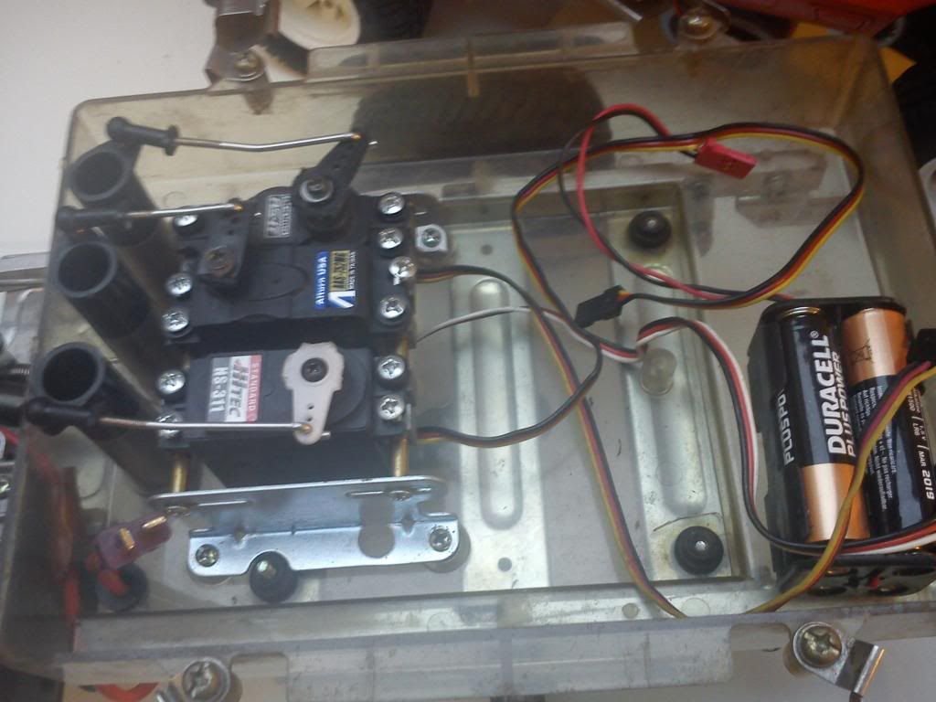

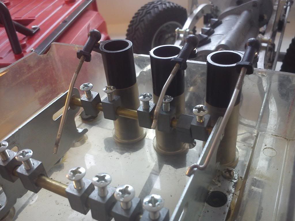

Anyway, some more stuff arrived today. Phone camera got better pics this time as I was taking them in good light.
Another servo control column to operate the in-transit TSC:
(Little grubby in there, plus I noticed one of the servo mount blocks has fractured and I need another. I als know that two of the columns are the wrong way around according to the manual)

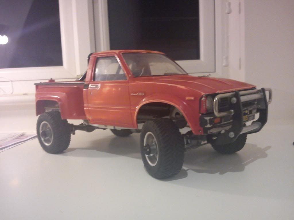

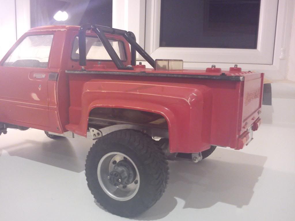

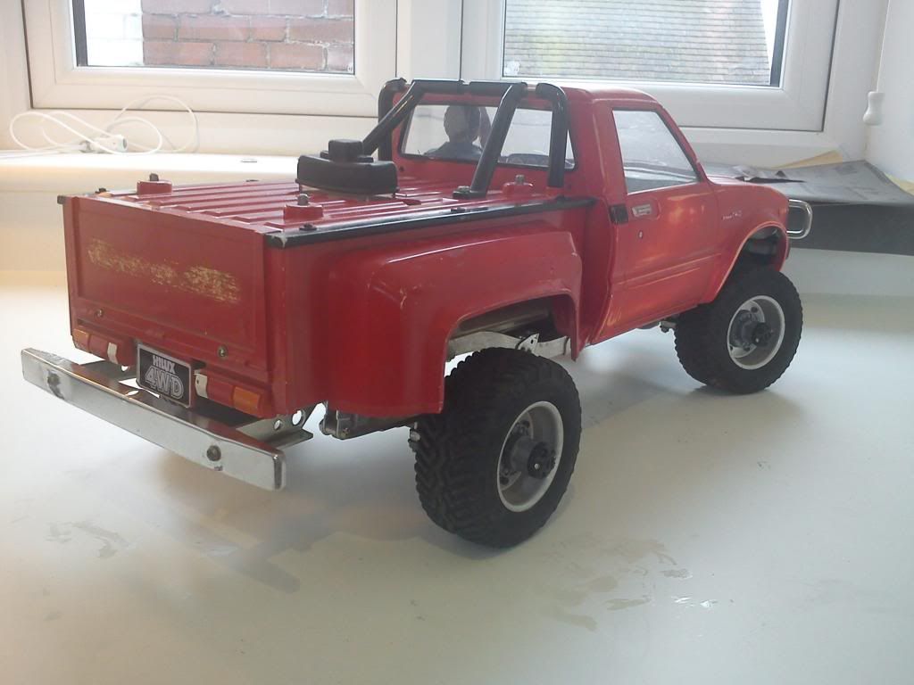

Sorry I haven't posted any more pics recently, been busy with school. Anyway, here's the latest:
A nice roll bar complete with 'daylighter' roof lights
A lovely piece of kit this. Works like a charm, and nice and clean too.
The nice orderly radio box. :rolleyes:
Got these at Christmas. 3 cheap waterproof Altern servos. Used em before, never broken one. They're my top servo for low cost/ low power applications, such as most Tamiyas. The ones that are in the tray right now are borrowed from other cars just to get the Hilux running. It's a good car to run, very lifelike. And once you get all the weight in there, the flex improves a pit.

Sweet truck indeed. Totally inspiring!
