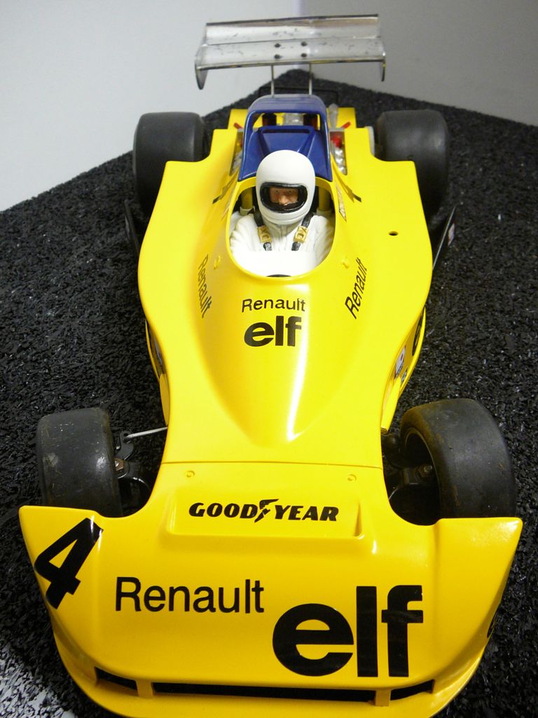

Vinyl cut lettering is what I prefer on my restores, as you can get bright and durable colours, see pic below. You also don't need illustrator, there is dedicated vinyl cutting software like Signblazer and Artcut (I think many of the cheap ones on ebay come with art cut, its not great, but does the job). They are not really as powerful as illustrator overall, but many have advantages for sign making such as good converters when dealing with bitmaps and the ability to separate colours as well. Also check out coreldraw (thats what I use), its not cheap, but even an older copy would do.
