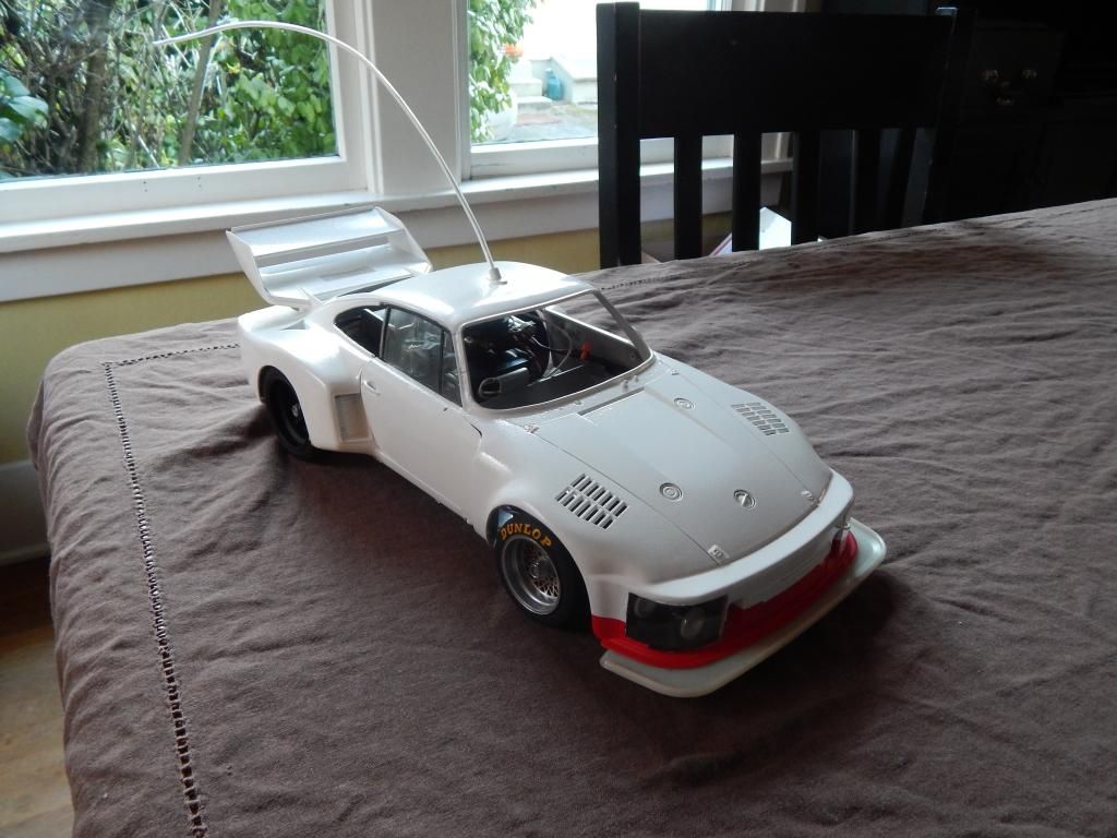

Completely tore apart the rear end and drive train tonight. Pulled the rear axle off and put it in a drill and sanded it smooth. Cleaned up the rear diff and greased everything. MUCH smoother now. Polished more of the chassis tonight, had to rebuild the A-pillar to line up correctly with the passenger door glass (the only original glass piece left), which is why it looks funky in this photo from earlier today and before it was all sanded smooth and puttied. Honestly, it looks like garbage in this photo compared to now. Will reshoot Gloss White once I get the replacement Glass in and everything lines up correctly. All the tires now have lettering done on them. :) I used the Pactra lexan paint from recommendations from others.

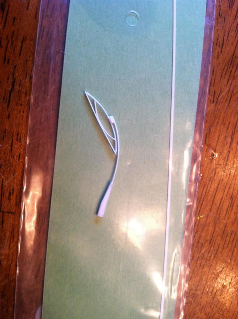

Building a new wiper arm and blade from Evergreen strip and rod styrene. Got to tweak it a bit and add a couple more things but pretty happy thus far.

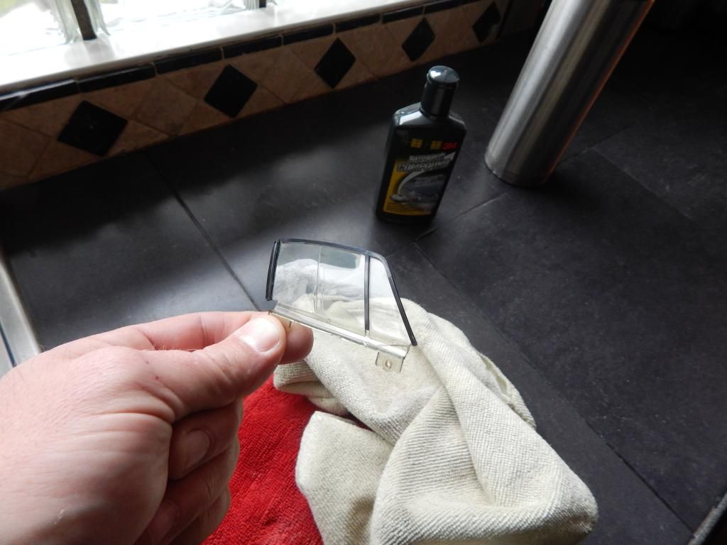

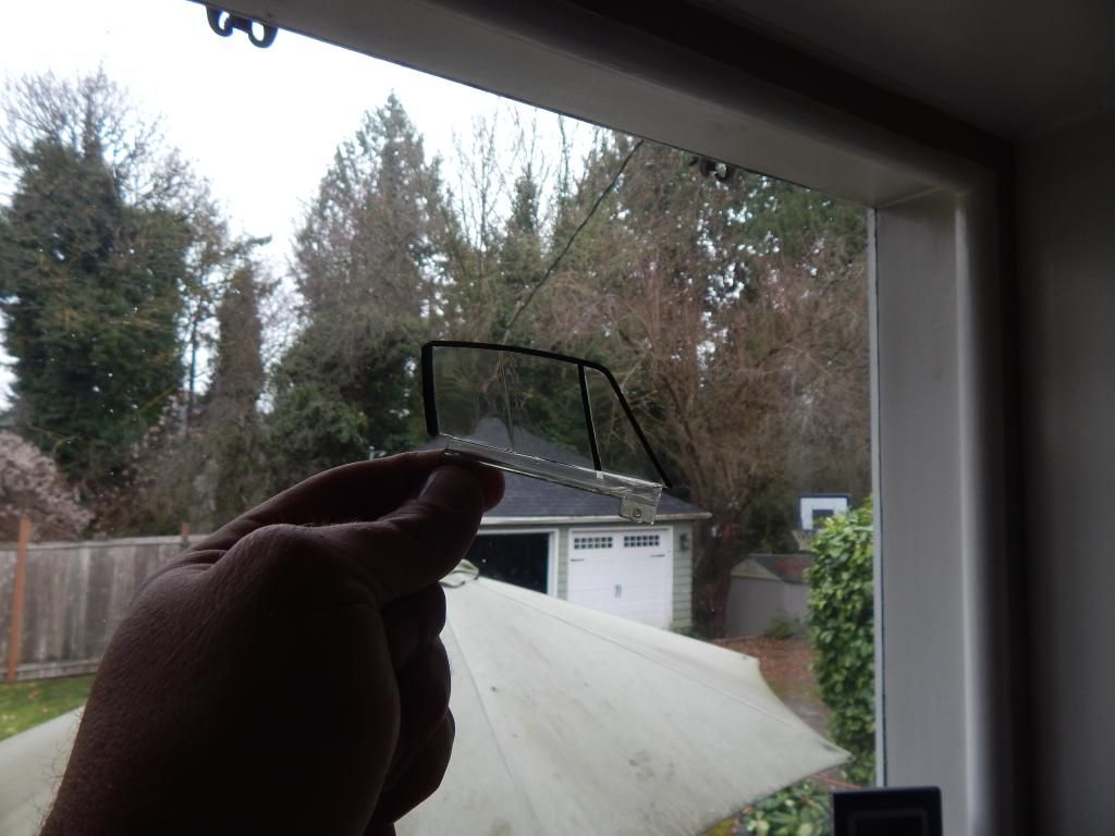

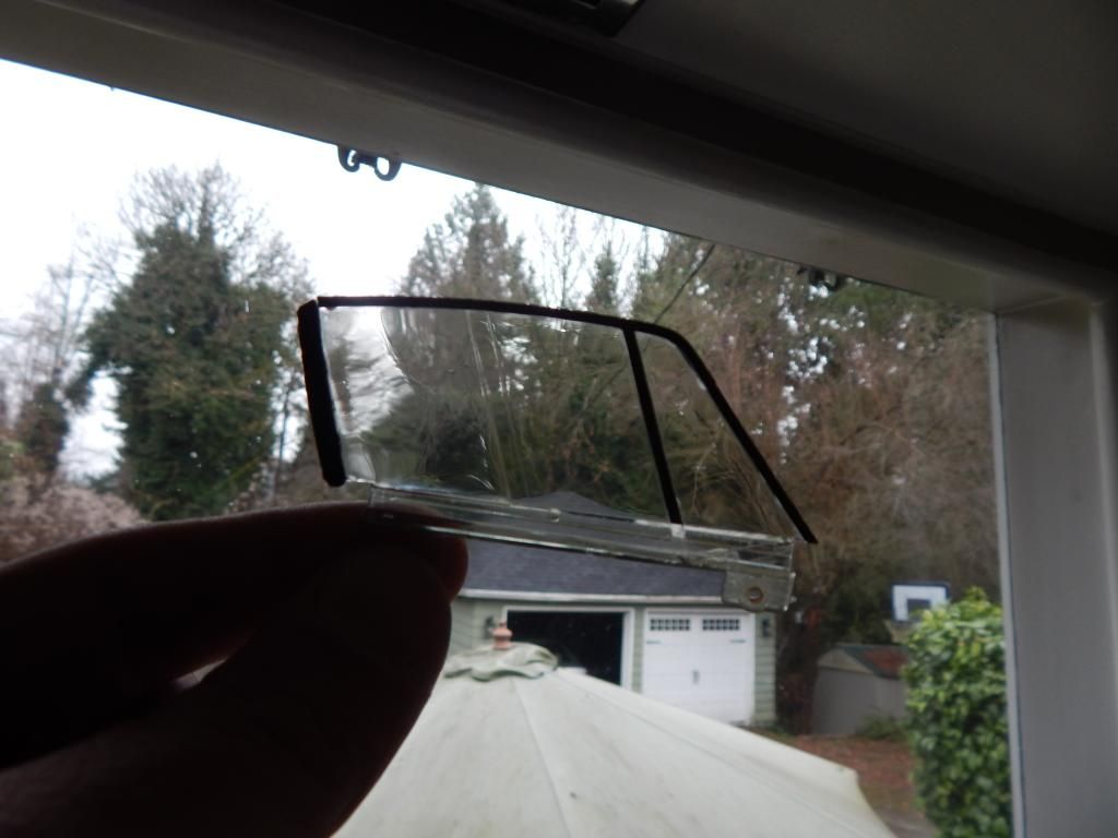

Decided to polish out the only remaining original piece of glass, the passenger window. The piece was HEAVILY scratched and discolored. I took some 3M Rubbing Compound (for headlights) and hand polished the piece for roughly 30 minutes, going over it roughly four times on each side. Darned impressed with the 3M stuff and how it turned out.

Glass should be coming in this afternoon and will posts some pics up tonight. A HUGE THANKS to a TC member for their generosity ;) New 2mm screws and nuts coming into today also.

I was able to finally detach the roof mounted antenna base and sand down the glue. Also picked up some 3000 grit sandpaper to start wetsanding the body this evening.

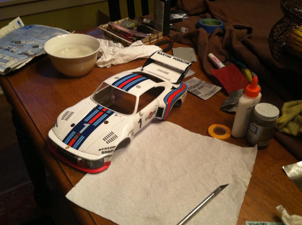

Going to have to trim and few here and there, but I do love the quality of Tamiya vinyl decals

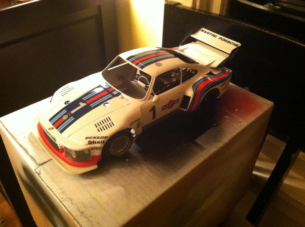

I few niggles here and there, especially with the compound curves of the rear fender and about .5cm short on the door. A wrinkle or two on the fender and some weird stuff under the rear brake air intake (due to the new Tamtech body being Lexan). But she's looking fantastic.
And yes, that's the original manual to the upper left :D
Thanks Bulldog!
Little bit more to go. Got to shoot several coats of clear, install the glass and paint the mouldings, get the B-pillars finalized and new grills for the rear and other bits.
