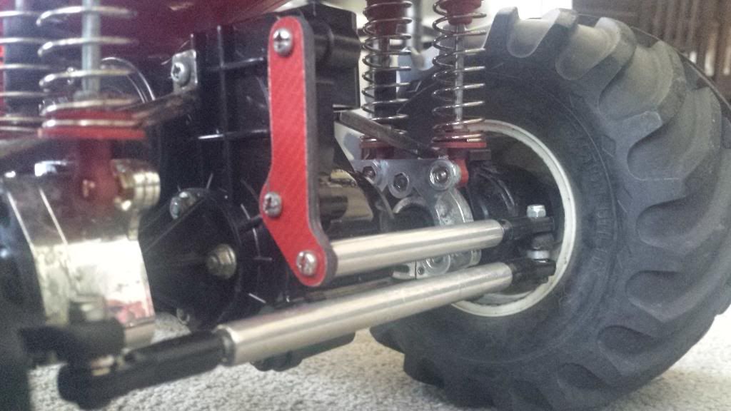

Well I tested my CPE build in this video only for a few min not beating on it or nothing..do you see me beating on it in this video? and the CPE rear steering lock out system caused my steering hub to break.. Why well first of all I don't know who thinks of these things but it is made in such a way that when either wheel gets tapped with force the unit then sends the shock into the steering arm by twisting it causing it to snap because there is only one side one rod on the left locking it out... so what happens if you push a wheel in or outwards on the rod ends it makes the bolt going through get twisted to the ball joints limits and then twists the steering arm where it's bolted on causing it to snap off!!
easy fix how these kits should be Is (SEE PHOTO) in the red that should be another rod end fixed like the one on the left this way when a wheel gets forced by a bump or hit the rod ends won't be able to make the end links on the plastic steering arm twist from force of the tires getting hit.... simple thing If it was like this I guarantee my steering arm would not have snapped!

Yep the steering lockout you have is worthless. I used these.and it is really a simple and excellent pair of pieces.
http://www.crawfordperformanceengineering.com/product_info.php?products_id=589
