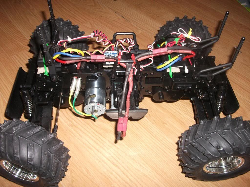

Here's where I am,
I bought the blackfoot 3 kit with the intention of making it 4WD, kit was £110, ( but it comes with the hard blackfoot body. nice. :) )
Stainless steel wheel axle £4.50 posted
WR-02 gearbox £14.95 posted
20x 1150 bearings £10.00
Driveshafts/ dogbones £7.99
Gearbox joint set £4.99
0.6 mod 18 T steel pinion x2 £9.00
I had a couple of "o rings" in spares.
£52 We'll round it down in case the Mrs reads this, :lol: £160 total spend so far. Now I've just looked on modelsport at 4wd drive monster trucks and there is nothing at 1/10 scale at that price range. So I don't think it was overpriced at all. :)
I was going to do a build thread of the whole kit but I am the most rubbish photographer ever, and coupled with a basic camera, it would be like torture for your eyeballs.
I have used two 104 BK ESC's ( the kit came with the 105 but I had a spare 104 so that they match)
During testing, with a bit of reverse then forwards the receiver cuts out acts like it has no signal but soon returns to normal, I hear you all shouting UBEC at me with the 104 ESC, but I have never had this problem before???
I know it's a bit of a mess with the wires, I will tidy it up when I work out what I will use for power.
The way it's set up with 2 ESC's I have have FWD or 4WD at the flick of a switch,
or RWD or 4WD after swapping a wire. :)

I can't say I have ever had any brown-out problems either, but then my setup is a bit different, with two TEU101BK ESCs rather than the 104s you are using.
Are you using a 2.4GHz system or 27MHz?
I had no end of trouble with my 2.4GHz system on my Twin Detonator until I fitted an ESC that had a built in BEC.
