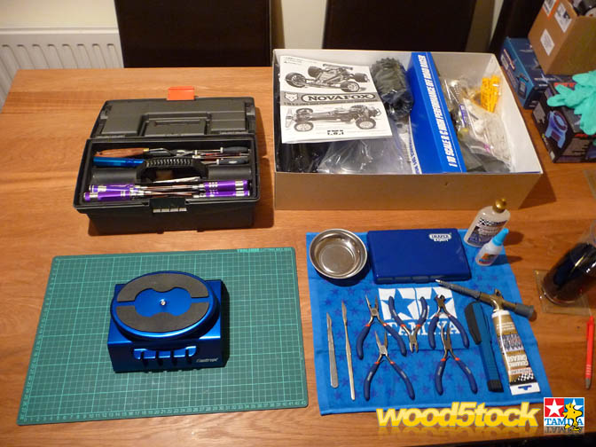

First the lid comes off to reveal the goodness within

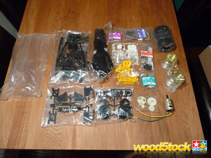

All the kit components
New and old tools arranged, let the game begin…

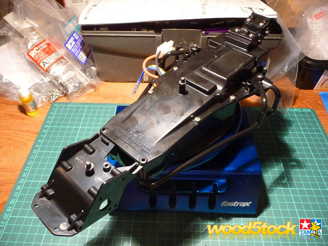

First off going through the manual to check all the parts were present then it was on to mating the two parts of the tub

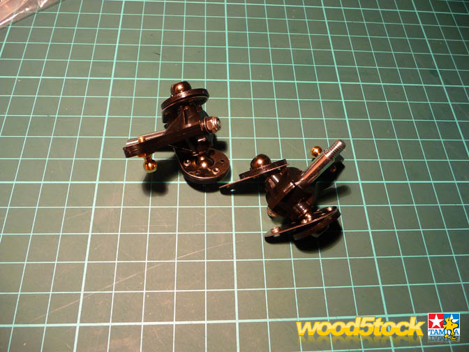

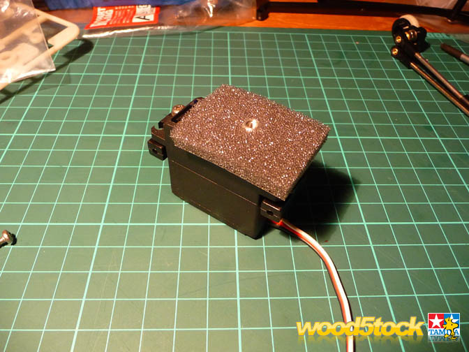

Then sorting the steering servo out
Nice shinny metal-geared ‘high speed’ steering servo

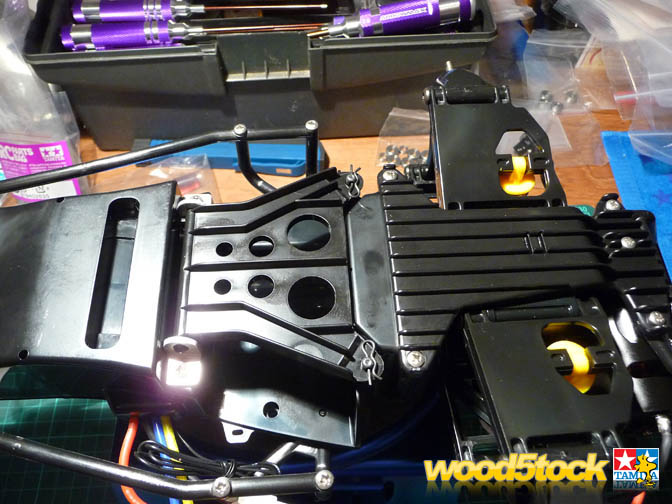

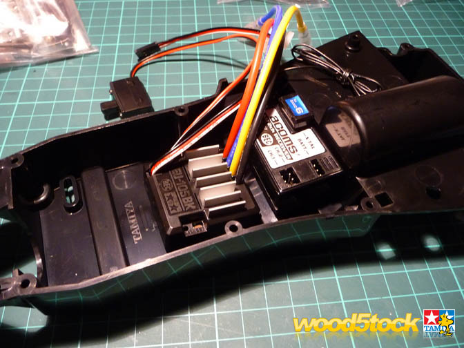

In goes the electrics, a mixture of new ESC technology with a bit of old school cool with the Acoms receiver with a blue band 6 crystal for a bit of colour coding

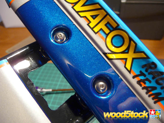

Tub together with other fastenings. As with all my projects I try to swap out as many standard fasteners as possible in favor of stainless ones.

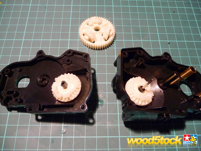

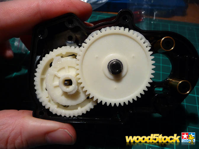

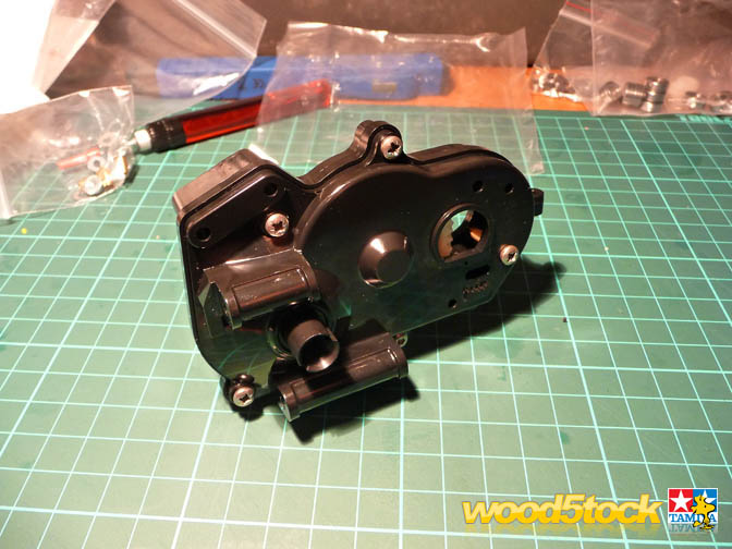

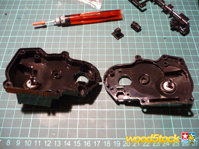

Assembling the gearbox halves with proper bearings
In go the gears with a nice dobb of ceramic grease

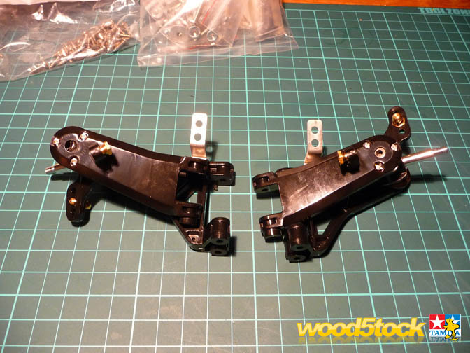

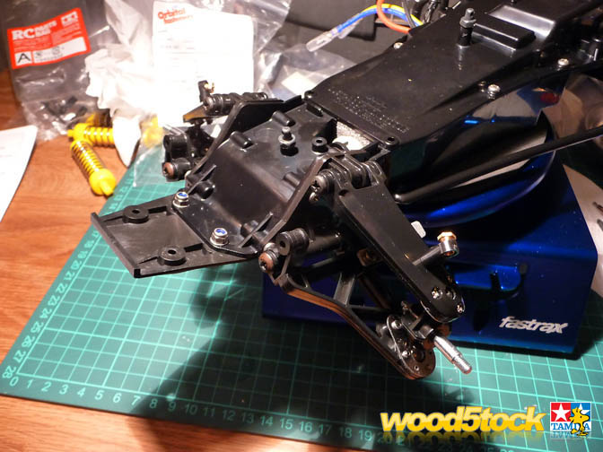

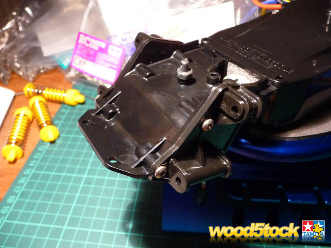

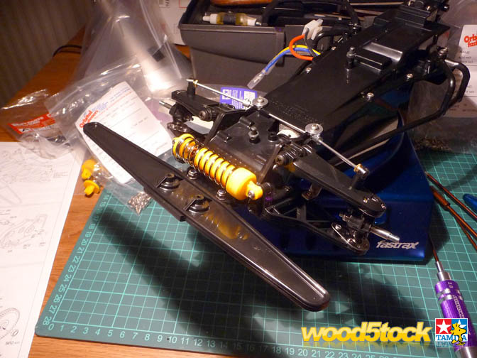

Rear suspension components fitted to the gearbox case

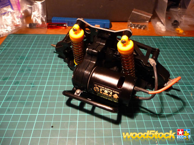

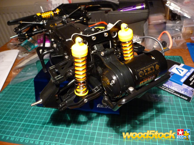

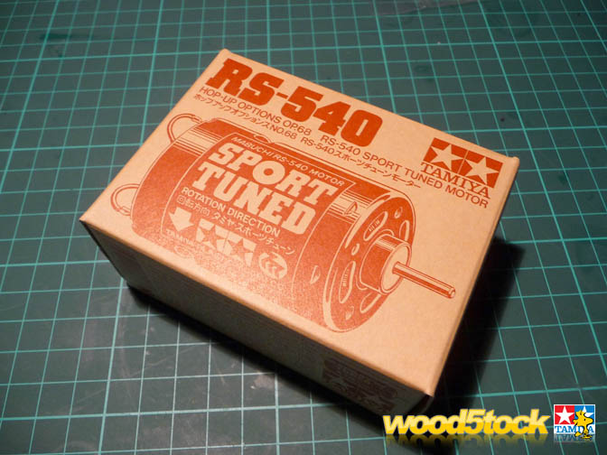

I decided to swap out the standard motor for a ‘Sport Tuned’ one

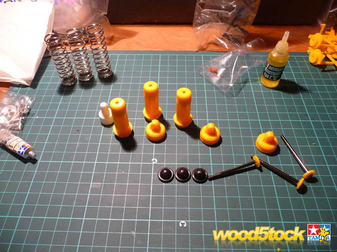

Dampers and motor fitted

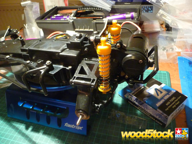

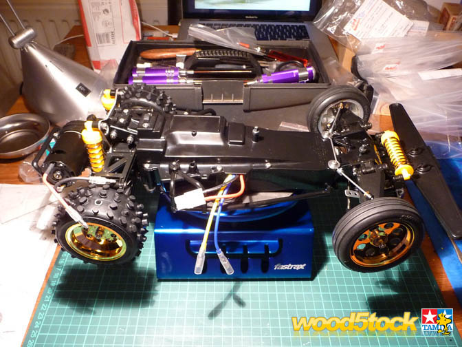

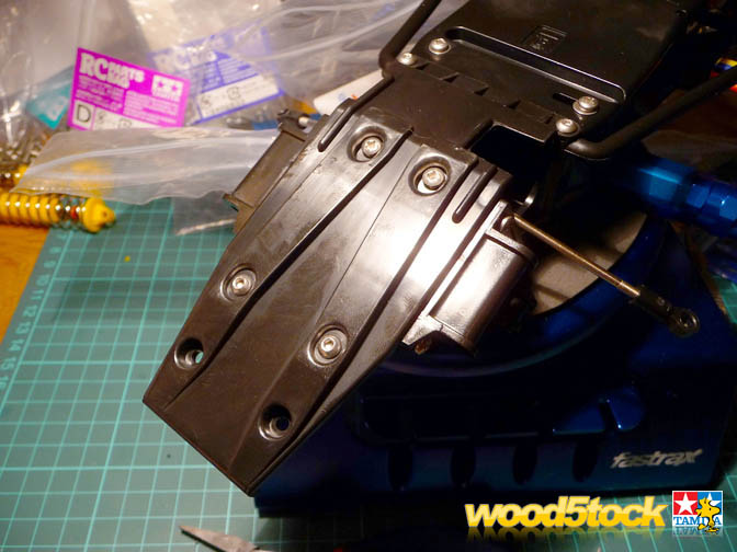

Rear end fitted and battery tray fitted
Rear end completed

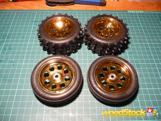

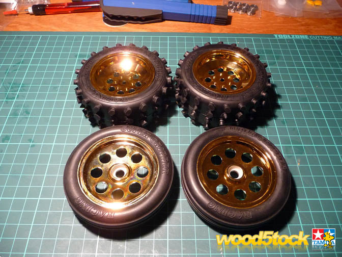

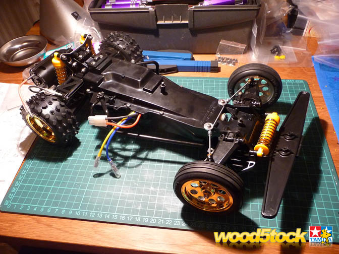

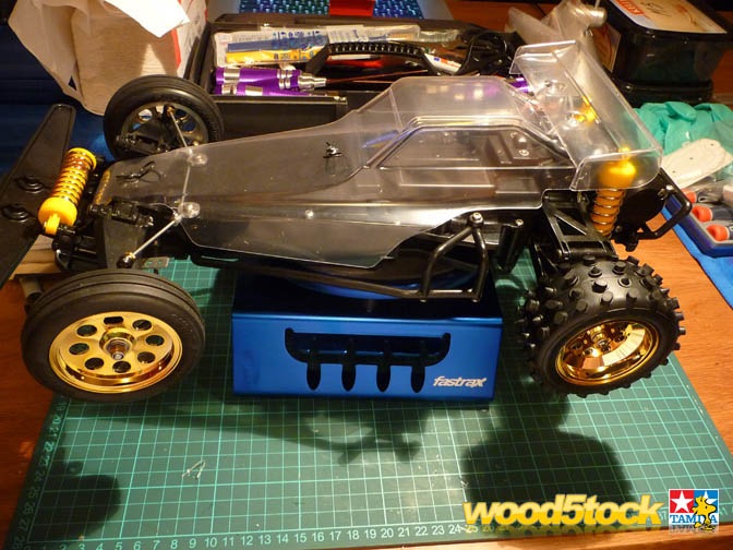

The last of the bearings and tyres fitted to the wheels

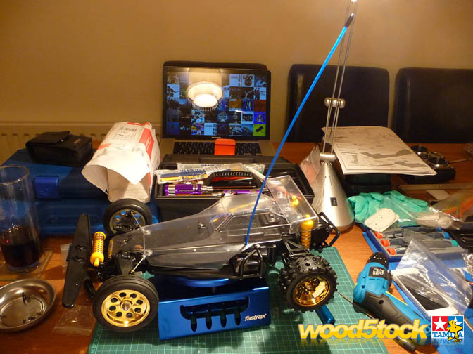

There you have it one rolling chassis

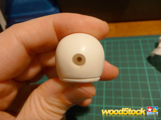

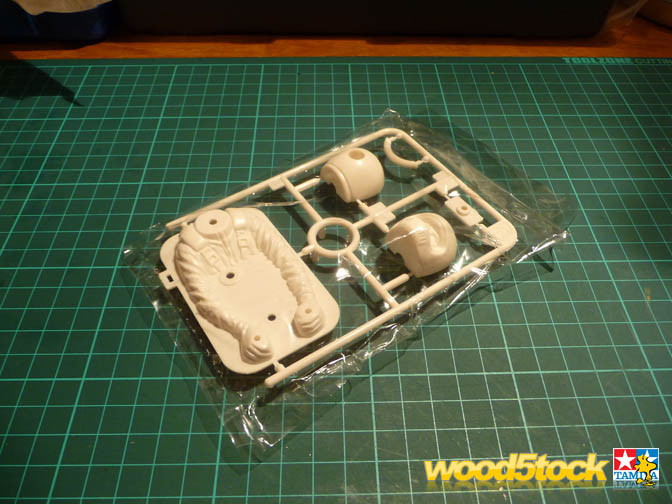

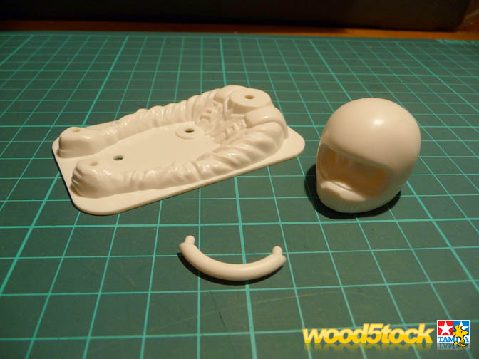

I decided to not go conventional on the driver’s helmet instead opting for a totally smooth finish rather than the screw in the back of the head and the uneven join lines.
I just used the screw to hold the two halves together whilst the liquid poly set I then removed the screw ready for filling. It’s vital you do this if you decide to do the same as the application of filler makes an air bubble which, depending on the amount of filler in the hole can cause grief by pushing the filler back out similar to when you fill screw holes in a piece of wood. Take the screw out before and the air can escape back into the driver’s head cavity… As it were… :ph34r:

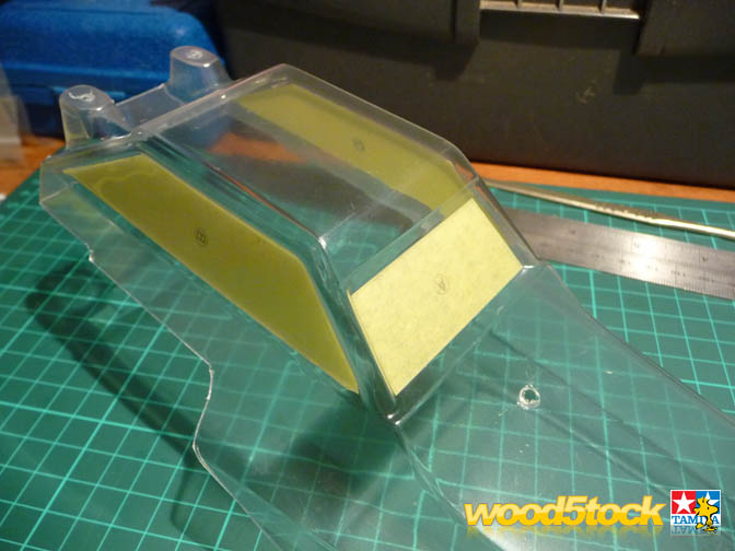

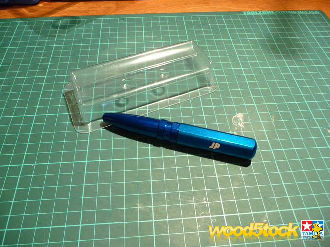

Whilst that was setting off I got on with the Body. It’s been I while since I have done this, but the proper body reamer and a set of lexan scissors both curved and straight made it dead easy.
A quick sand of the edges and the rear wing on a quick trial fit was done

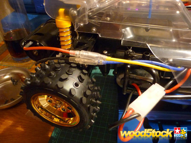

Note the colour coded aerial tube :)
Also the Sport Tuned motor comes with standard length of wire so I shall have to make up some new, longer ones and solder them on. Japanese male and female bullet terminals ordered ;)

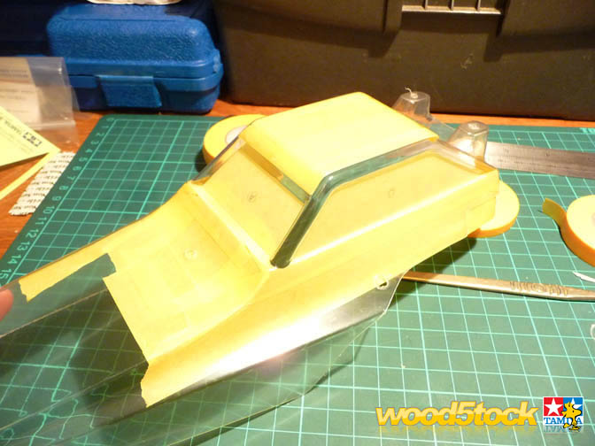

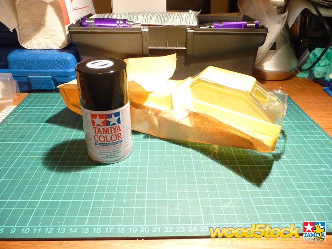

Now the painting, well the preparation anyway
Looking at the manual and the decal sheet it seams that the black paint is only applied to the back section of the body surrounding the switch hole. With the black of the roll cage made with black decals.

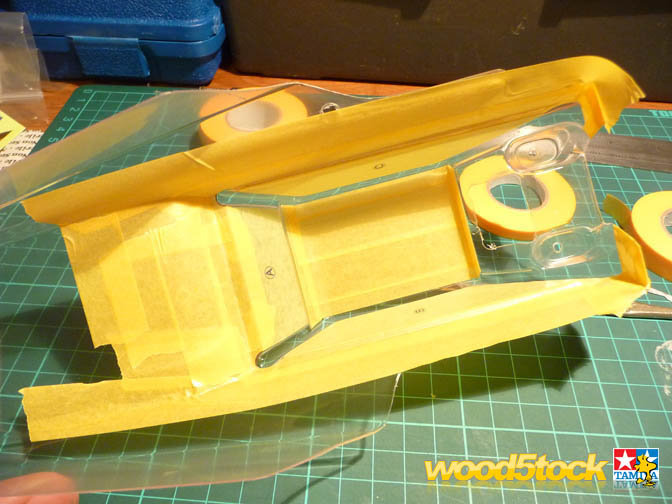

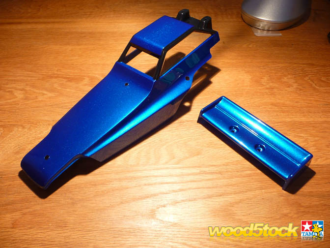

I didn’t like this way of doing it as I felt the decals could have a good chance of lifting after time. I decided therefor to go all out and mask the roll cage etc and do the lot with paint.
Time to apply some colour

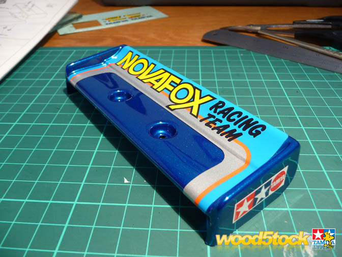

I also started to paint the rear wing whilst I was at it
Really pleased with the outcome of the roll cage. I particularly like the way the curved ends came out. I know it’s sad but there you go :rolleyes:
Rear wing done

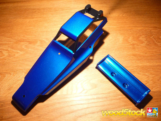

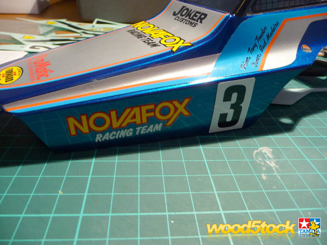

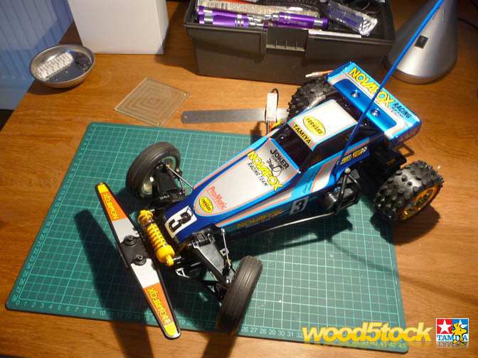

And finally all painted up a mixture of PS16 metallic blue backed with PS4 box art blue. This gives the PS16 a deeper luster I found.

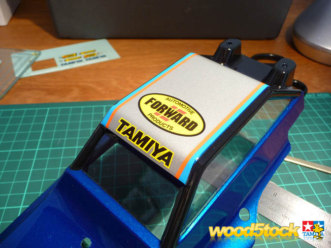

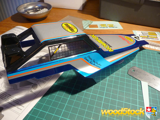

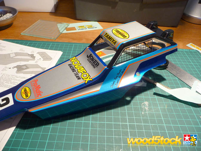

Now for the decals, first off the rear wing

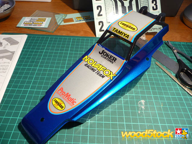

I have modified the roof decal removing the PS4 blue strip from the front as it would look odd against the PS16. I also removed the black strips down the edges and back because of the black paint
Decals on and rear wing fitted with nice stainless set screws
Almost there now very happy with the way it’s coming out so far :)

nice paint job. the ps16 needs something behind it to make it pop.
Yes it does, was a little worried about the blue blue combo would do what I wanted but it did. In the flesh its awesome, and that's not even in sunlight... As we haven't got any here :wacko::wacko::wacko:
Thanks for the comment. Yeah I just couldn't do it the way Tamiya intended this time, and it will make this part of the shell a little more aesthetically durable, when/if it flips this will be the area that gets it and the stickers would just look pants after a while IMO :)
