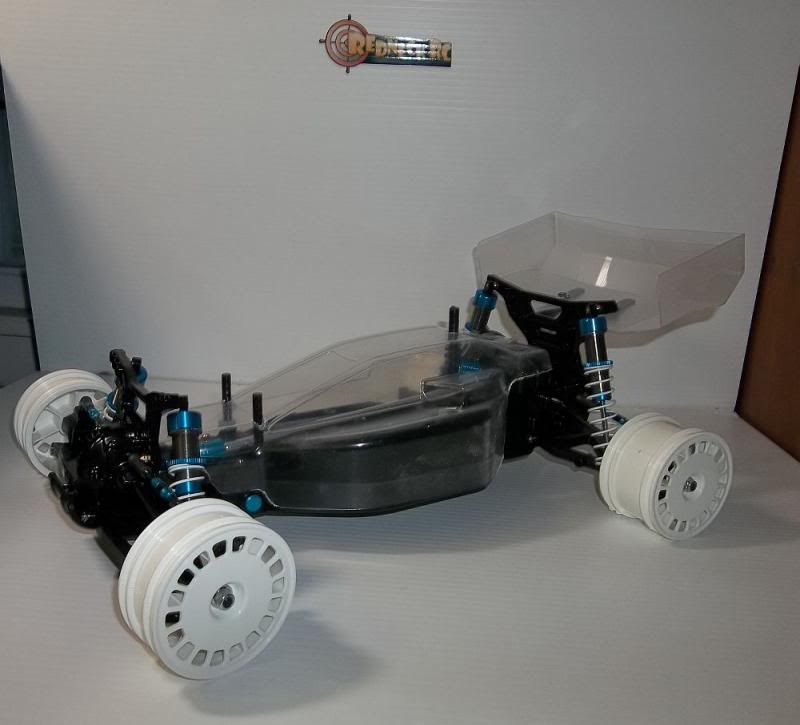

i got the pack to fit. i just had to do some slight dremiling for the wheels. i also bought a lower aluminum front gear box and some proline rubber for the track. i have a duratrax DE10 ESC with programer as well. im debating on what motor to put in at the moment, oh and i have a nice associated XP servo to go in for steering duties.
this will be all in the article series iam doing but im not sure if its ok to talk about it here or put links up?
this is how the car sits now:

I use a TrakPower Lipo and it fits, just. I did have to Dremel a notch so the lead could plug in to the battery, also I needed to solder one lead to a 90 degree angle to clear the prop shaft.
The only upgrades on mine are 3Racing graphite shock towers front and rear, front graphite brace, rear aluminum brace for the gear box and one for the suspension.
I tried the 3Racing steering knuckles but they bent literally on the first tumble, 30 seconds into use.
Novak Havoc 3s/Ballistic 8.5T stuffed in there

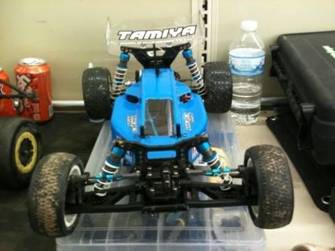

well i took the DF-03 to the track with me while i went racing last night. i didnt race it but i did take it out for some practice laps. the car has potential. it bottemed out pretty bad with 45 and 40wt in the shocks so i need to go up in wt. i dont know if i like the oneway or not. i also managed to pop out a dog bone and i blame that on flex in the shock tower where the camber link attaches. some hop ups are needed.
well heres a blurry cell phone pic of it after practice.
