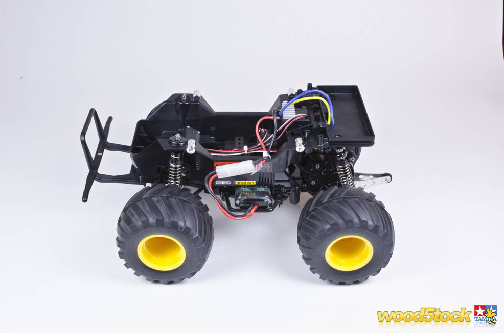

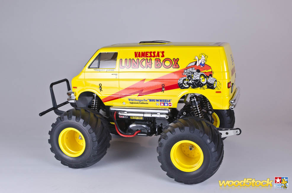

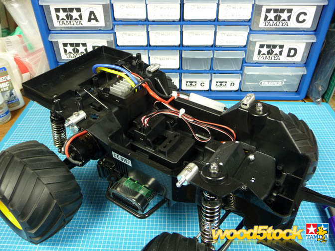

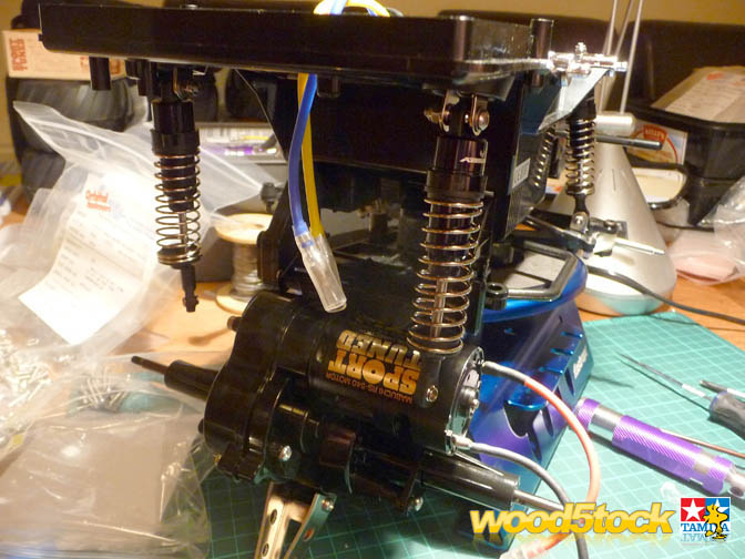

Using the CVA top mounts you get in the kit along with stainless fastenings from stores :)

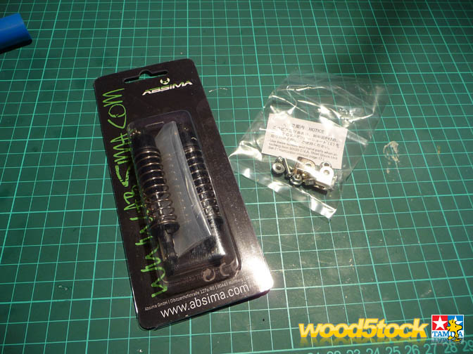

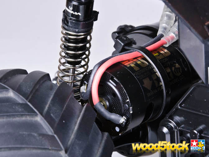

These are the damper units I am fitting Absima Alu sets from MotorsportUK
The ride height is about 5mm lower (no weight) using the 75mm shocks advised by MSUK so will lower the COG a little ;)

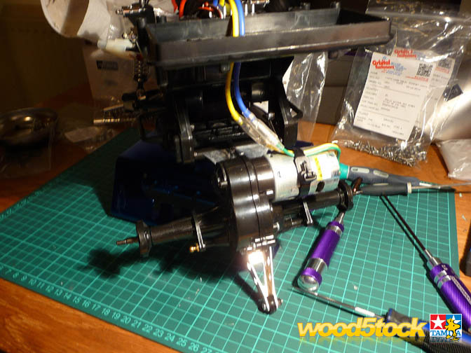

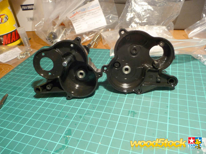

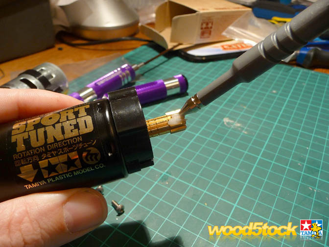

Whilst the gearbox was out it was time to fit the bearing kit and Sport Tuned motor :D

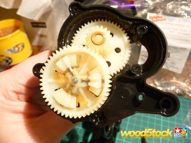

Ready to split the gear case
Bearings ready for the gearbox, forgot the fifth one for the photo DOH! :lol:
Bearings fitted

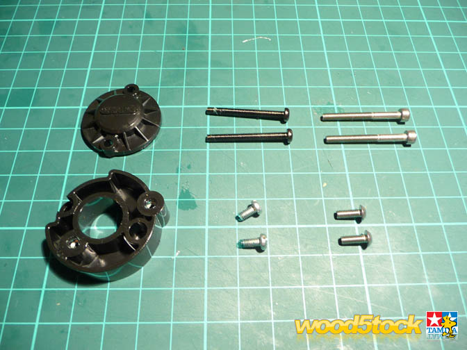

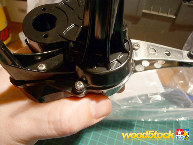

Standard screws swapped out for stainless
Standard screws (left) stainless goodness (right)

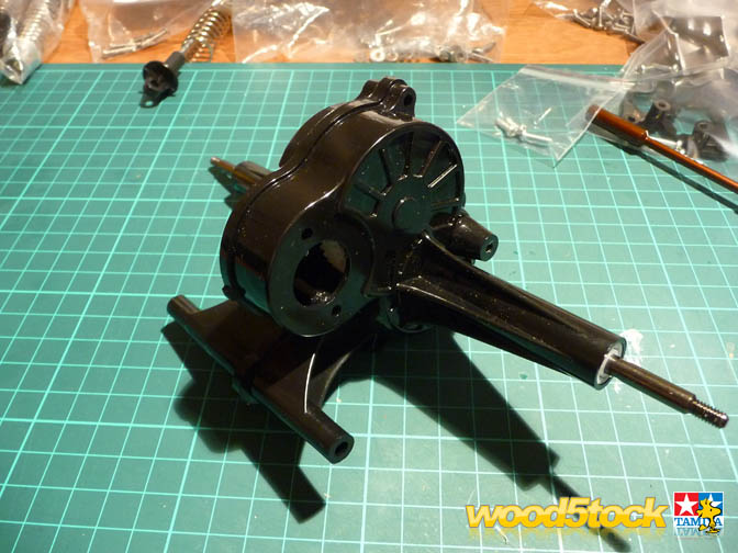

Good dob of grease on the pinion. The internal gears where also cleaned and re-greased
Gearbox done :)
All the standard screws taken out have been swapped out for stainless :)

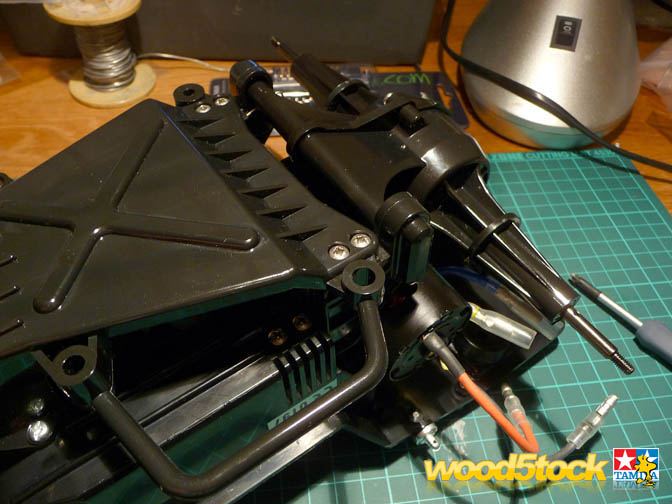

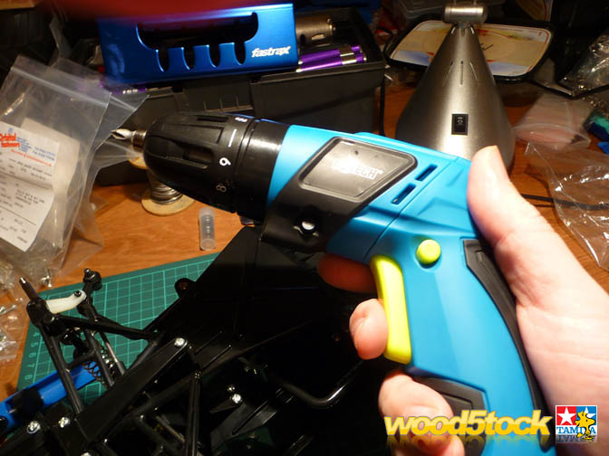

Can anyone spot the deliberate mistake :blink::blink::blink:
I am so glad when I mess up I got one of these for Christmas ;)
All back together and the right way round this time :rolleyes:
Same as the fronts Absima Alu dampers, and the little packet from the kit for the CVA top mounts

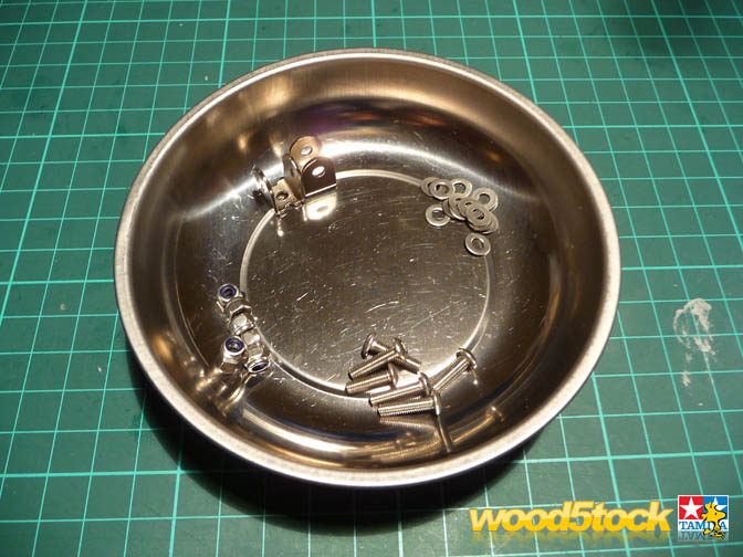

All the stainless fastenings ready for the job
Top mounts done
Back together... Almost

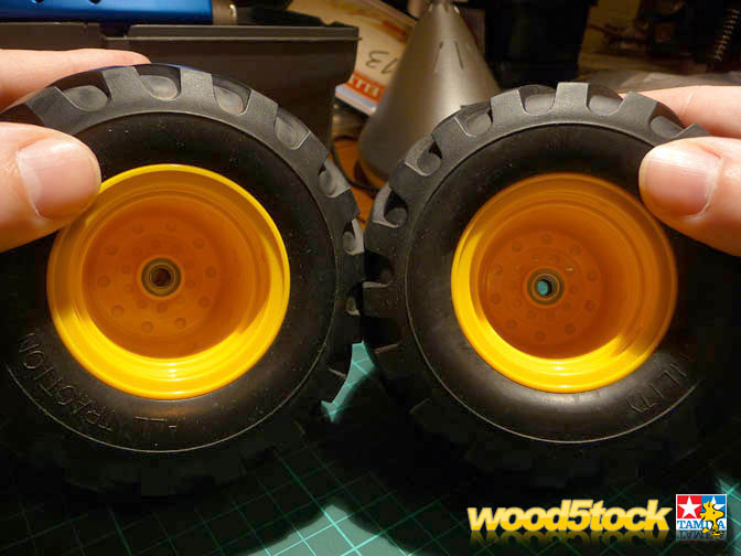

Last but not least front wheel bearings
Fitted

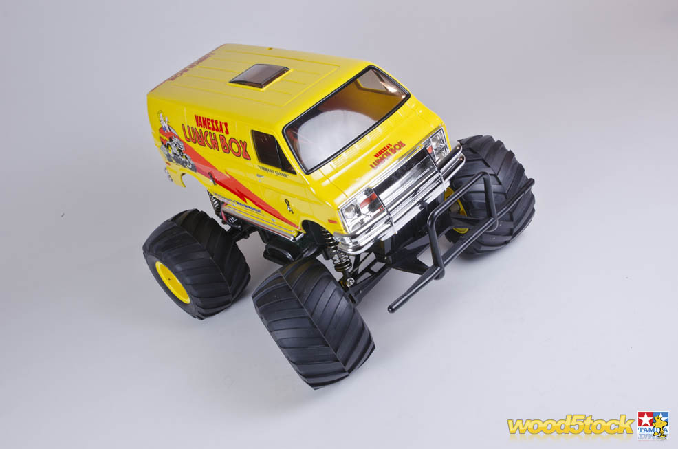

I love it! And the shock mod!
I see where you got the shocks, but where can I get those mounts? You mentioned they came with the rere Lunchbox? I guess I could try to find that parts bag on eBay?

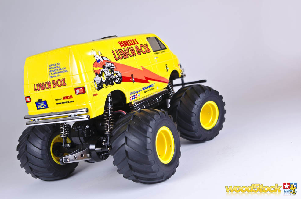

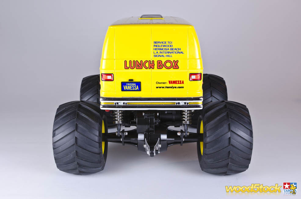

Funny... I had no idea they listed all my neighboring cities on the back. (Inglewood, Hermosa Beach, Signal Hill etc). I also noticed on the Vintage San Scorcher some decals about Southern CA. Oh and on the Vintage Clodbuster it mentions "White Lightening Inc. Manhattan Beach"
Was Tamiyas American base here in Southern California?
They come in a little bag along with the screws etc for upgrading to a Tamiya CVA setup. I think I still have the rest of the back etc. once I am at the bench I will dig it out and rake a photo ;)
Not sure about Tamiad US base you would need a proper Tamiya expert to answer that :lol: : lol: :lol:
Being a vanessa lover with a yellow box art and a gold edition ,I'm a fan of yours also I like the shock mod
I've gone for the rear ally wheel hex huds on mines as the plastic ones perished sitting on the shelf.
I will be doing the allt body mounts soon then the shocks will follow

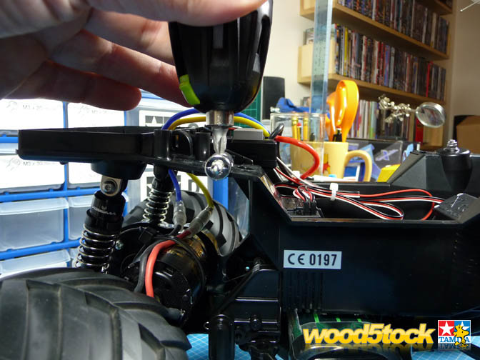

Decided to get my new aluminium body mounts on to day :)
Off with the old (well old new :blink: )
These will go into stores

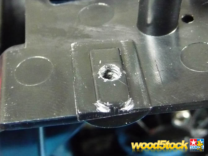

I tried a test fit with replacement stainless self tappers but the mounts weren't that secure so I have decided to through-bolt them with stainless M3 socket heads ;)
The next problem was the new post would not sit level on the tub when the holes were in-line
This was because the slot milled into the underside is round at the end where the bit stops, whilst the mouldings on the tub are square. Thus make the mount sit proud
With the mount in place I pushed it down on to the plastic...
...This then created witness marks...
...Which I could then cut with a scalple :)
Perfect fit :D
I cut a nice tight M3 thread where the self tapper used to be but decided to have Nylocs on the end for more strength
Finished :D

i like those shocks look a lot better than the originals.
