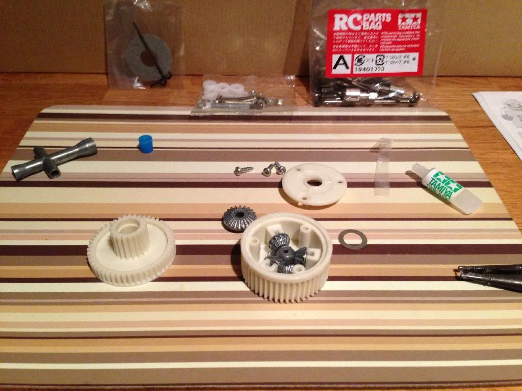

C216BCD1-9F9B-4E2A-9D02-F4358D5AE11C_zps
E8982DCF-F7AB-4285-80FF-EF44329A085B_zps

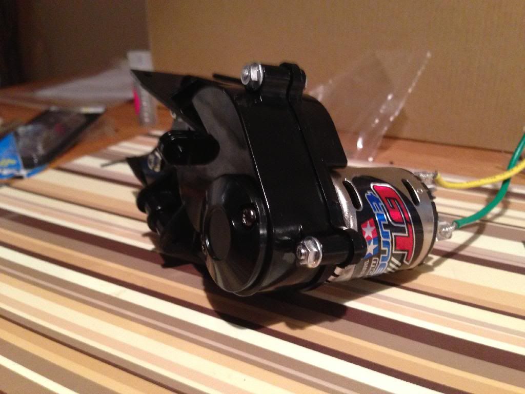

Then it was time to fit the motor, firstly it was going to be powered by a GT tuned motor
40E97110-006E-46CE-B9E7-96E88CCE5AF8_zps

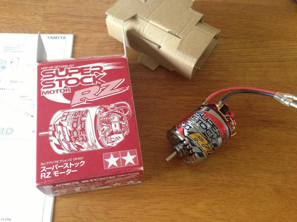

But then I spotted this on ebay :wub:
3A1EE503-5135-4637-BF49-3E3C030368DD_zps
A couple of clicks later and it was mine...

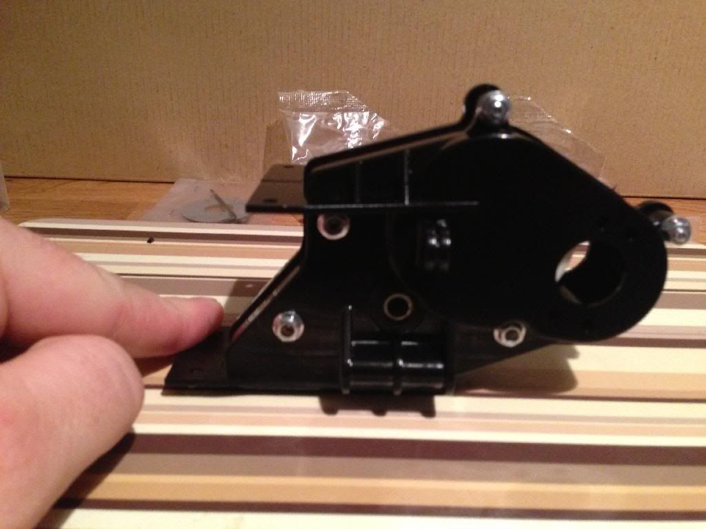

But firstly it was time to attach the rear wishbones,
8286C95E-E274-4E4F-B353-7FD4C1CADCB2_zps

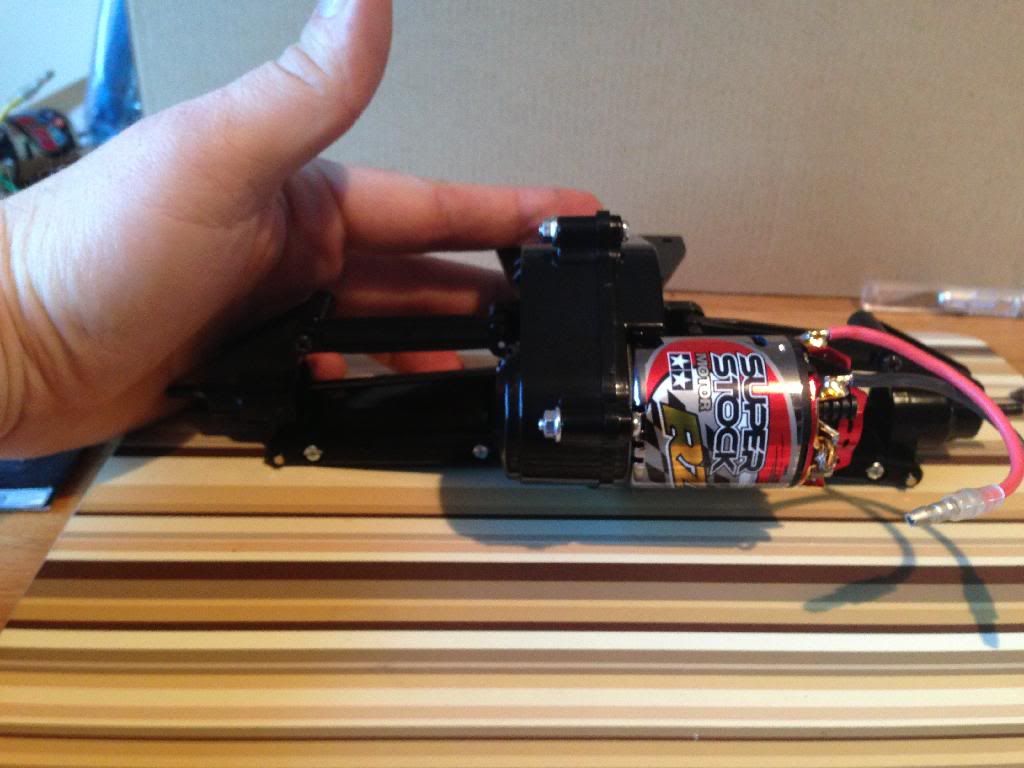

New motor fitted :wub:
83162F73-DEA6-466E-9699-C8AD199C4A00_zps

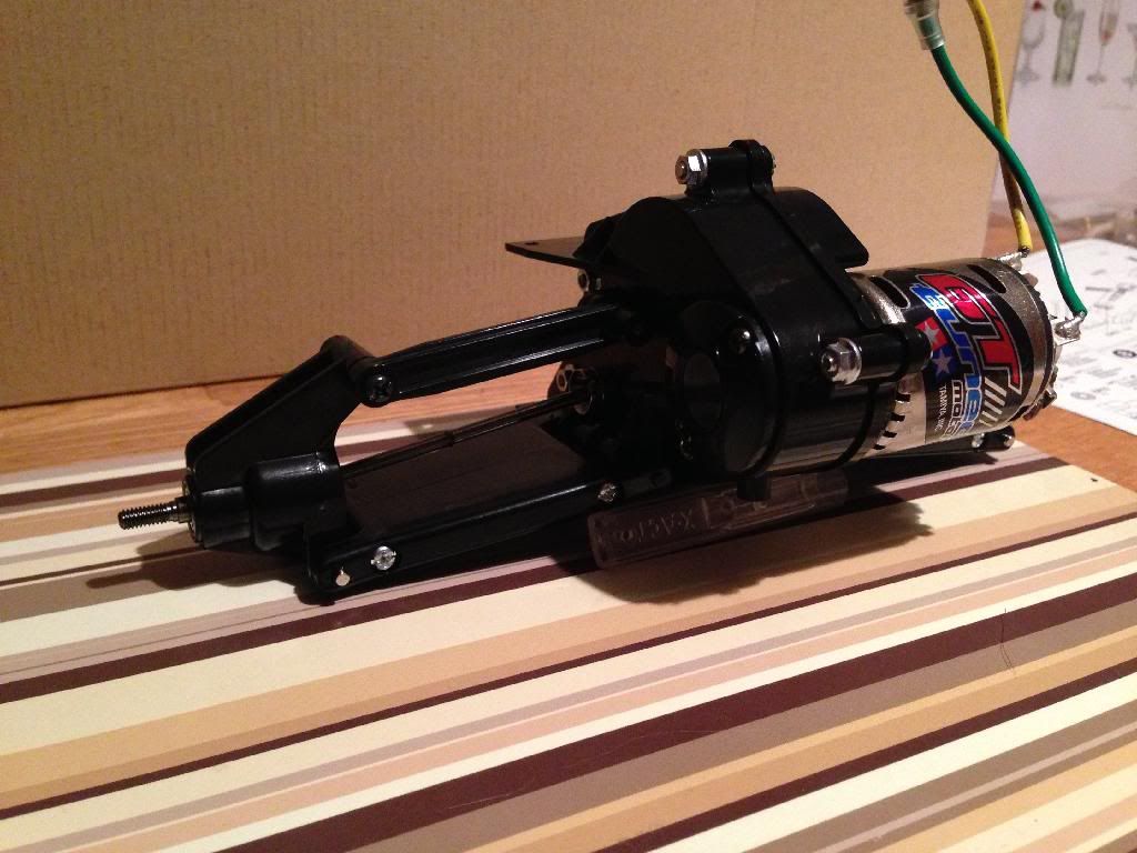

Time to fit the gearbox to the chassis and install the servo,
CA22653F-A741-48A7-A106-40901F43CAC3_zps

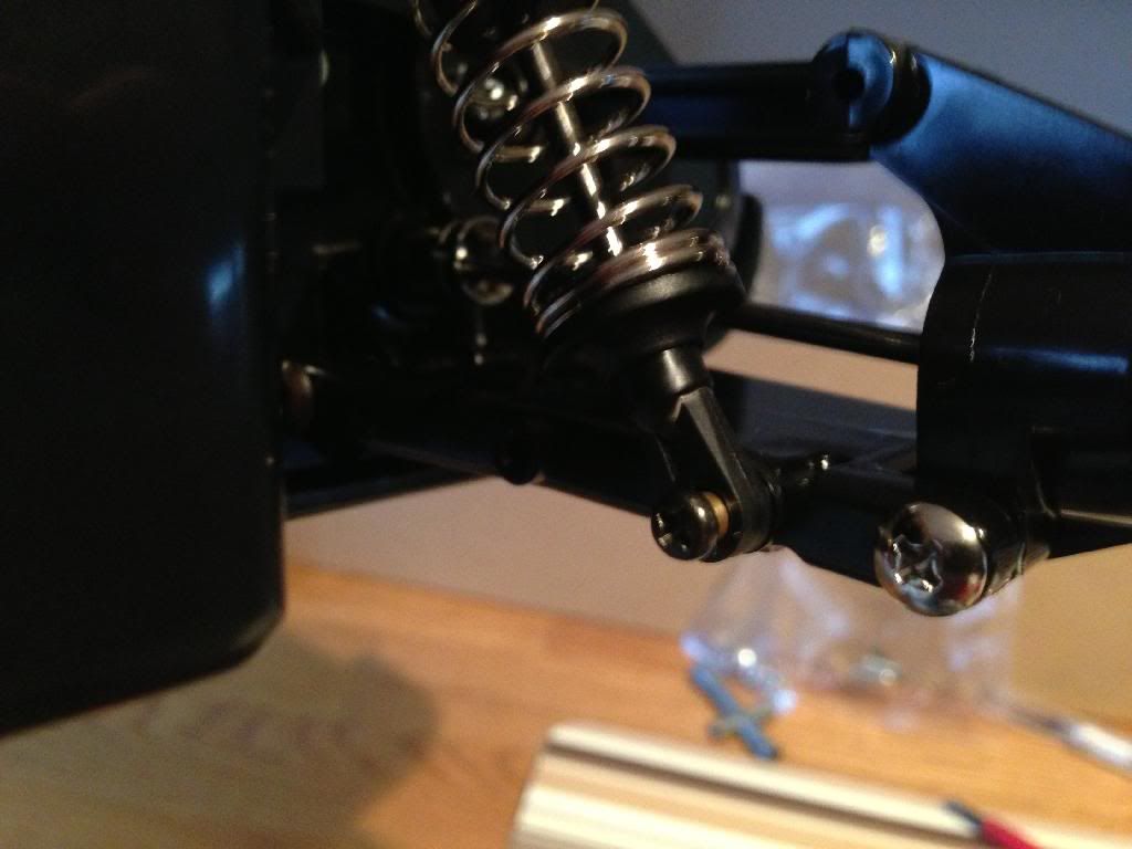

Then its time to build up the oil filled dampers, sadly I did not take detail photos of this but I am sure most of you have built more CVA's than I have had hot dinners, this is where I had my first little nightmare...
I could not get the lower mounts on the rear dampers to tap on far enough and there was too much exposed thread on the shaft. So I thought if I found the correct screw size with the same thread length it would be easier to pre tap the lower mounts...
And it was, sadly the result is this :(
66D99B3C-AE9A-4B61-932D-0EBB3143AB0A_zps
A nice stress mark on both sides :wacko: They do feel quite sturdy but I have already ordered two replacements in case these let go.

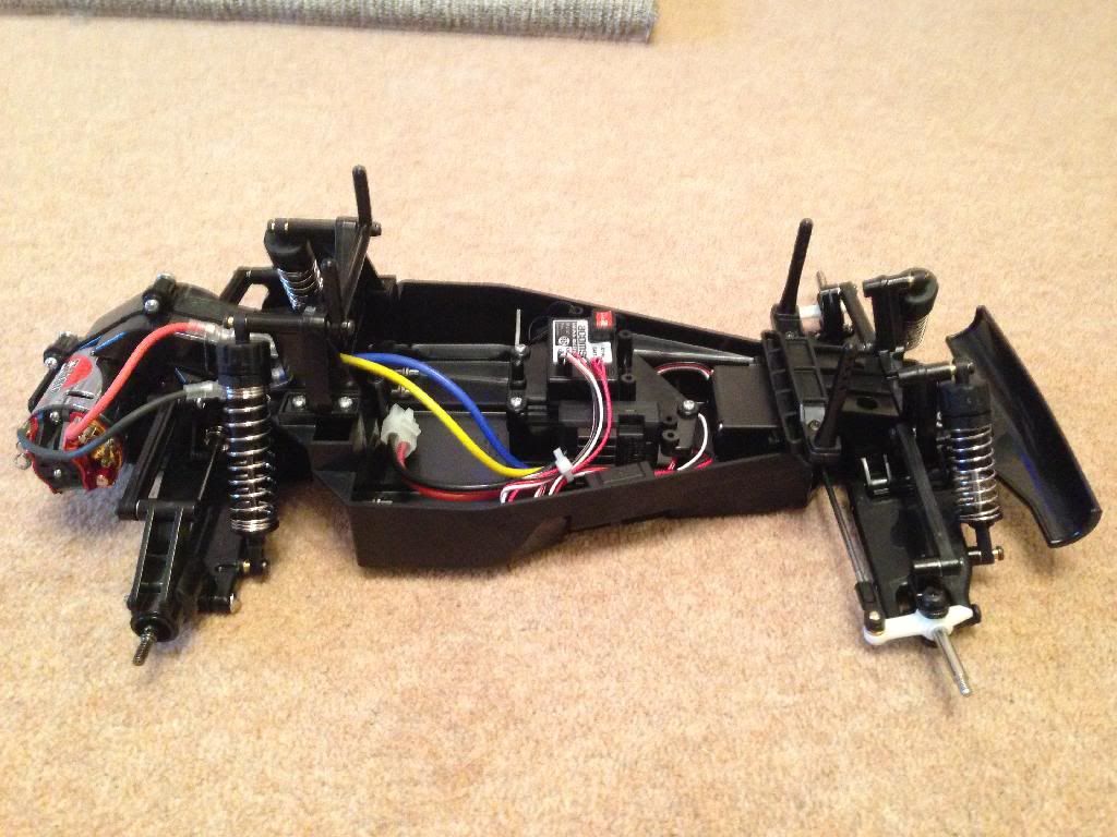

Here is a picture of the complete tub and dampers :)
7300EFEC-C350-4E35-BA8E-B454A7C7E8EB_zps

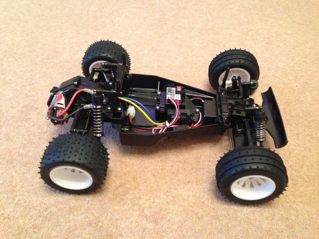

With wheels
D0CF9A41-1030-4691-A565-CC762DB43BD5_zps

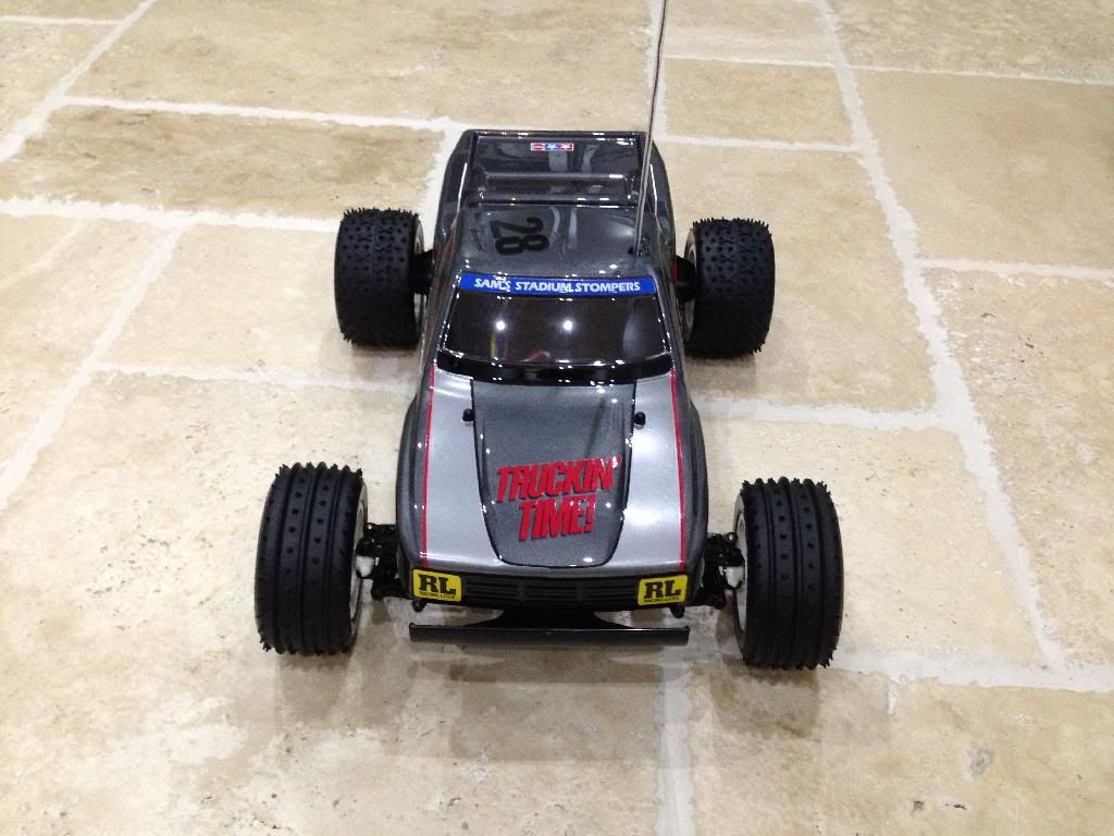

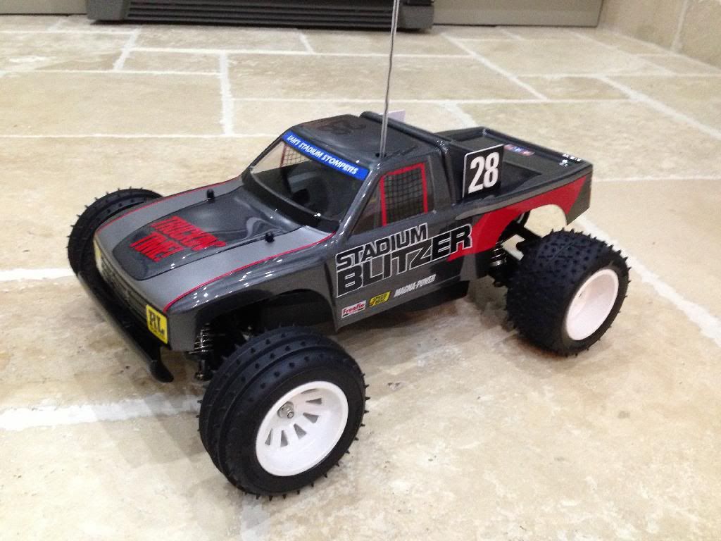

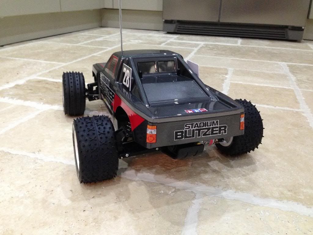

So then it was time to paint, I was all ready to go box art white until I spotted a TC members showroom then the decision to go PS23 gunmetal was an easy one :wub:
CFF7A076-EE33-423B-8C45-20B8CA2D1E42_zps
ABFFD6A4-7F19-4F6F-B4F4-65481E990B5B_zps
C2B3640C-78D0-4E09-BC94-E18310A6F455_zps
01D6D66E-A0D0-4AF7-913D-3C28EA68DE2C_zps
I think it gives a really great finish and looks much less toy like than the white, I also decided to use fewer stickers on the theory that less is more. :lol:

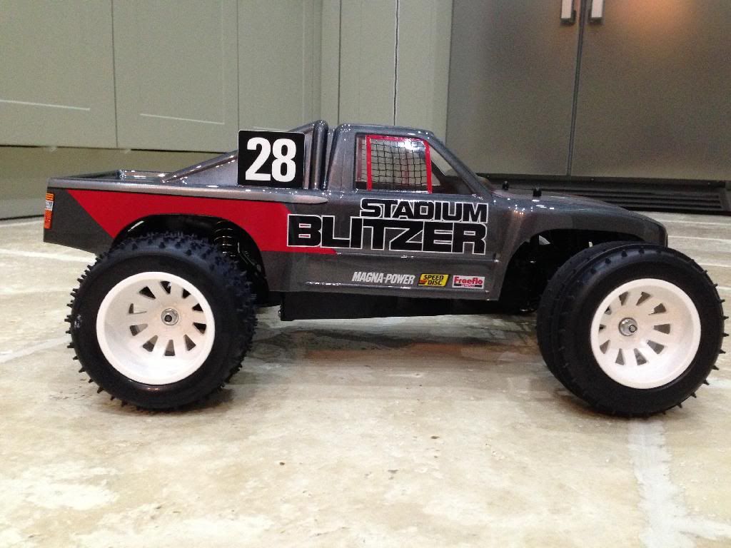

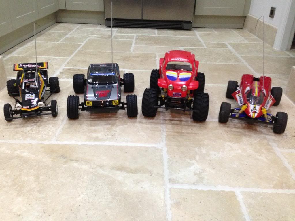

I hope you like it, here is a picture with my other tamiya.
5103755D-D6A0-4ECE-B5F9-D9650D0A7FC4_zps

Nice!! reverse the left side steering knuckle to the right side and make the ball joints at the bottom of the steering knuckles you will get way less bump steer when you compress the front suspension down and it will work much better.
Thanks guys, I will take a look at swapping those over next week, will I need to extend the steering arms if I swap them round? It looks like I will need to looking at the distances.
Nope nothing needed at all all stock parts work just fine when doing the old switch aroo!
Another very worthwhile modification is to replace the top links with adjustable ones . This allows you to dial in some camber and it rally makes a big difference to the handling .
