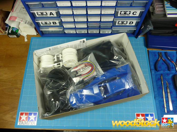

So after a bit of research and info from XV I decided to get myself a NIB 58416 Rising Fighter to form the basis to the project as it is essentially a Supper Hornet/Grass Hopper 2 sharing about 75% of the mouldings.
So lets crack on with the build. I shall build it more or less standard then start looking at hop-ups and mods etc.
Some of the usual suspects for the build
Got a brand new SH shell for the build :)
Time to open the box
Also first time to use my 'Quandry" boxes to see if they work
Standard silver can goes straight into the spares box, getting a bit of a collection now :rolleyes:

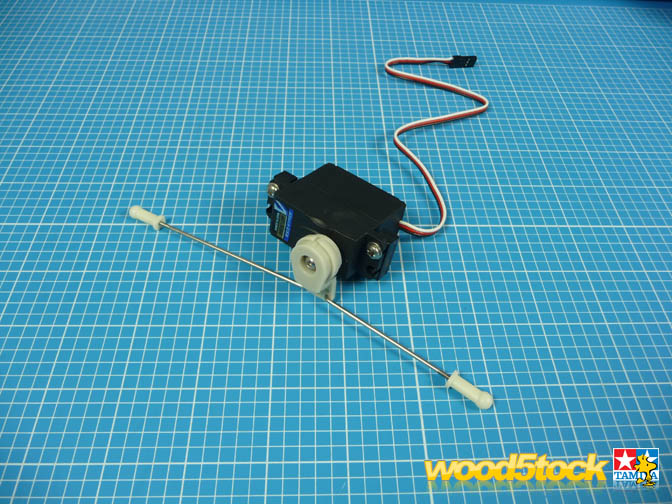

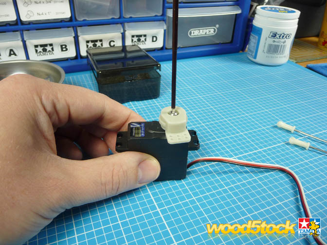

Set up servo saver

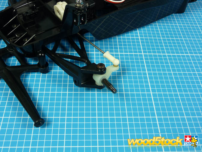

Attaching steering rods

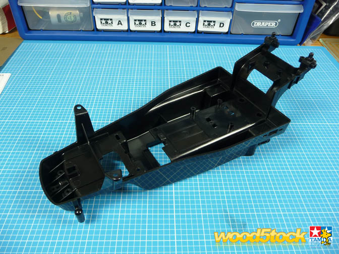

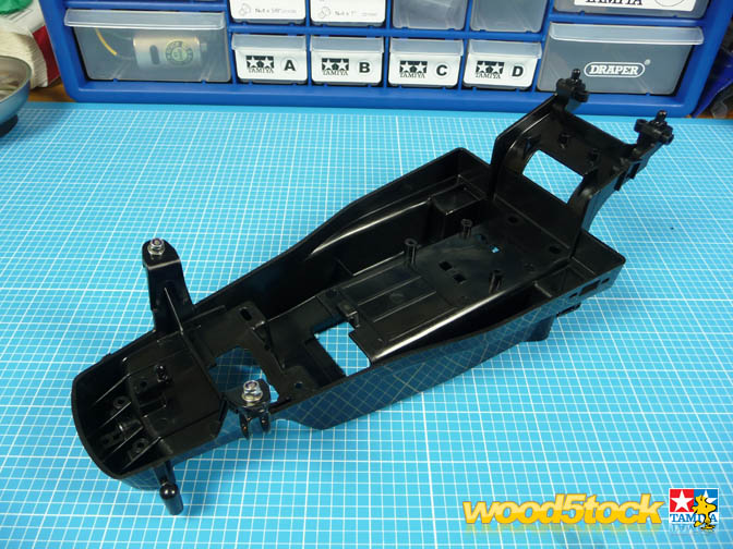

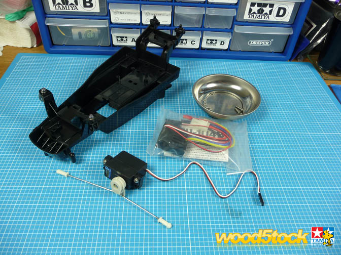

The tub

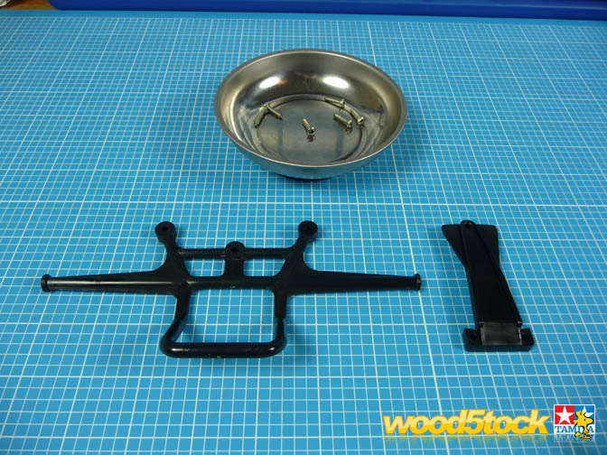

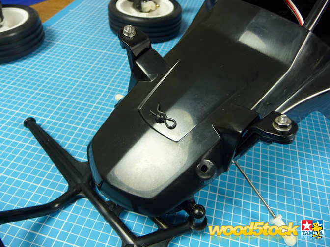

First deviation from the manual, swapping the front body mount for the traditional 'R-Clip' version, the RF body uses a screw here

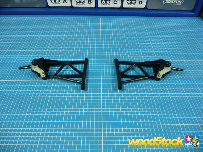

These are a nice addition over the old set-up. Suspension top mount strengthening pieces

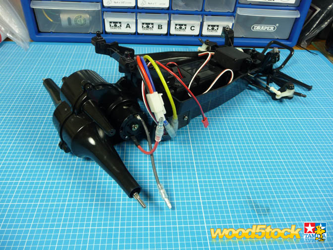

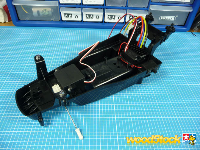

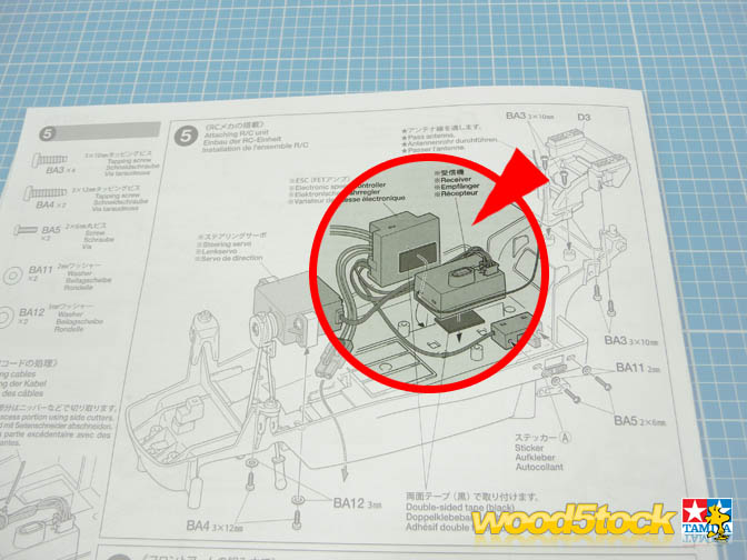

Adding the electrics
Another deviation, as I want to use the full driver from the original kit I need to place some of the electric slightly differently. Basically using the same layout as I have used in the SH as I know it works

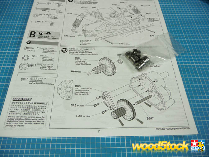

On to the gearbox, using proper bearings
Left hand gear case
Right gear case and drive shafts

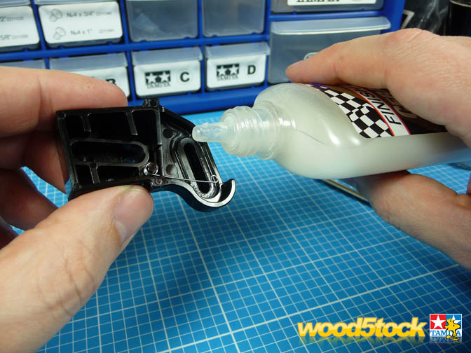

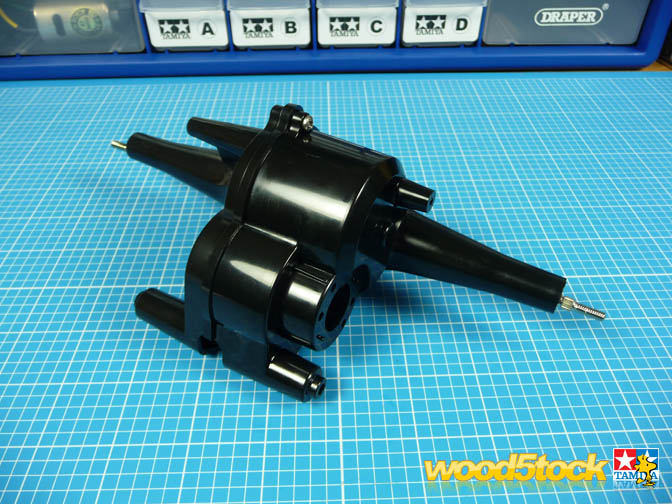

Finally putting the two cases to geather
Looking great so far! Did you grease-seal the two gearbox halves when putting them together? If not, I would recommend it, especially around the motor, where there is a small gap that can let in dirt otherwise.
No I didn't :o thanks for the heads up, I shall investigate the gap and sort out the seal too. Cheers bud ;)

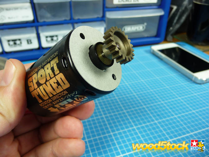

As I am I bit of a pinion numpty, what difference will the 19 tooth pinion make? It looks much bigger than the stock one. Which leads to the next question, how does it fit? is the motor mound adjustable?

Here we have the almost complete chassis, Also happy to report that leaving the sub assembly from the RF that fits over the original SH resistor position hasn't caused any grief so far :)

First off bending the ends to the new 'R-Clips'

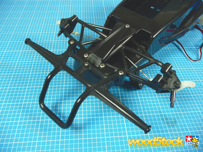

Test fitting the new SH body reveals the first minor problem, it simply doesn't fit at the front. I did a bit of head scratching at first as I was sure both the original shell and the blue RF shell are identical, apart from the rear wing and front screw mount. I narrowed the problem down to the front suspension scollops, the RF ones have been cut back 3mm either side to accept the strengthening pieces.

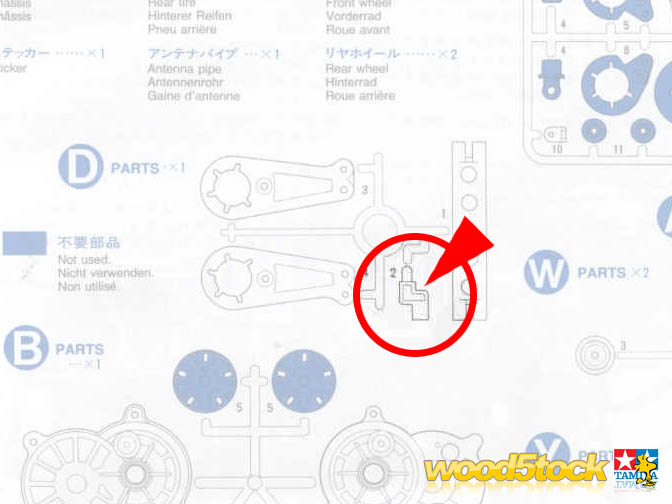

Another problem I have also found is the front mount is the wrong one and is too short. Then I remembered once comparing the one off of my SH, this part is on the SH 'D' parts sprue and alas doee not come in the new RF kit, so I will be keeping an eagle eye on aBay, but I have seen that Tamico have them in stock so i may have to make up an order :ph34r::ph34r::ph34r:
Andy
You and me both mate :lol:
I just wanted to start fully understanding pinion changes for myself to be honest. I knew that steel would be better wear wise but as far as the sizes, pitches and teeth I wanted to note the real life difference myself, The choice in this case was made easy for me to start with as it's the one ModelSport UK suggested.
In answer to your second question the mount is not so much adjustable as it has a second set of holes to rotate the motor effectively moving the motor away from the counter gear

I also did a bit more testing of the SH body shell fitting at the front. Now I don't really want to get rid of the strengtheners as I feel they are a welcome addition but I also don't want to chop a brand new shell about either.
Another test fit with the proper front body mount stolen from my SH reveals that once fitted with an 'R-Clip' there is only about 3mm of deflection so I only need to remove a light skim of the scollops. Result! No need to chop it about after all.

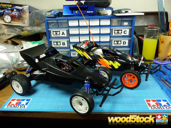

With everything buttoned up tonight a quick comparison of the two beasties :)
And both with the bodies on :D
One little problem has presented it's self and one I have hear about and now witnessed or rather heard. The awful gearbox back lash from the front mount when going forwards IT'S PANTS!!! So I will be looking into sorting a third shock out but first I want to play with the original side plates to see if these will work as the original SH suffers no back lash.
Hi Wood5tock great thread. A quick question if you are in the uk where did you get your pinion from I need a new one for my madbull and they appear to have the same gearbox as your buggy.
another fine build.
as for you pinion. a bigger pinion will give you more top speed, a smaller one will give you better acceleration.
Cheers bud, should be a big of a giggle then :)
