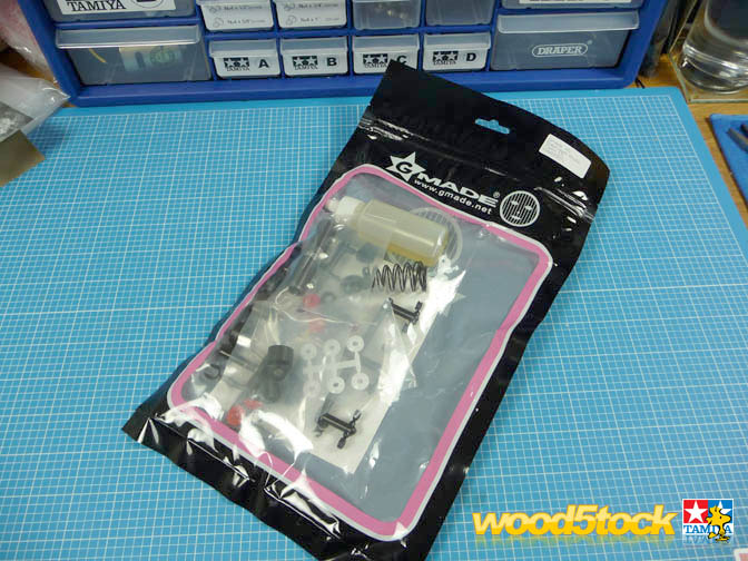

Got my Tamico order home yesterday with some much needed supplies for the Super Hornet II.

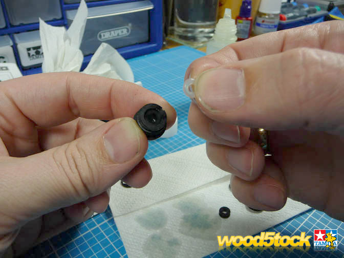

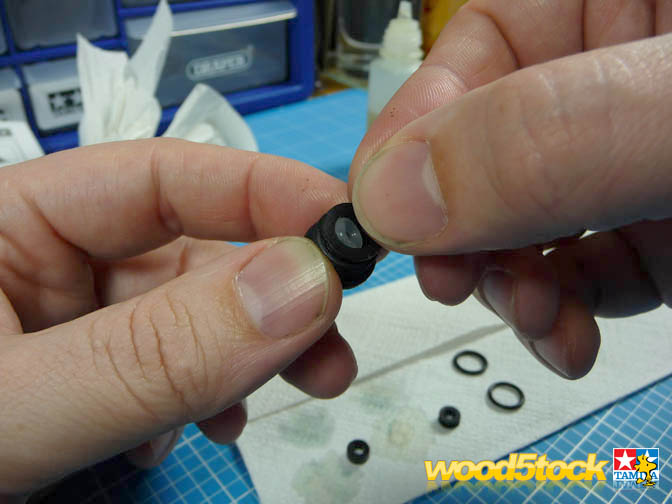

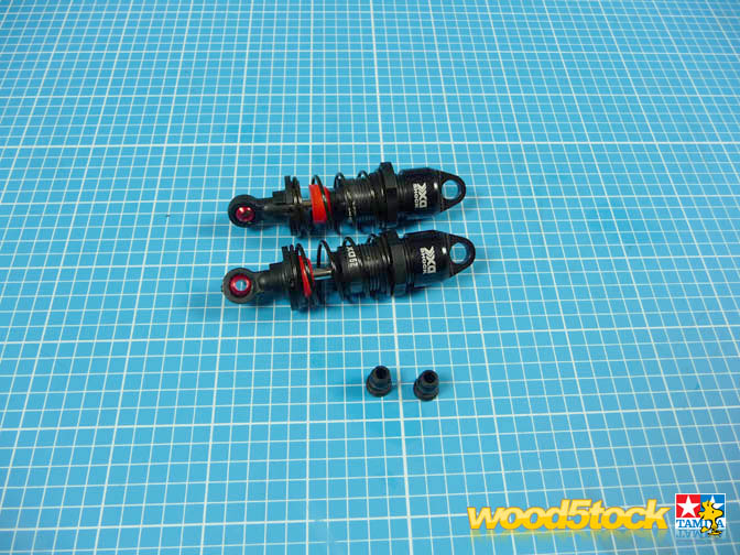

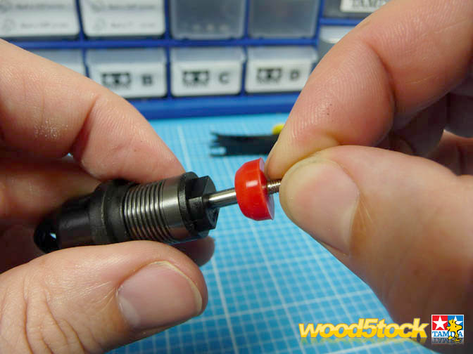

Got a set of G-Made shocks which I put together last night. So far I am really pleased with them, they look great and work smoothly with a easily adjustable preload ring on the spring.

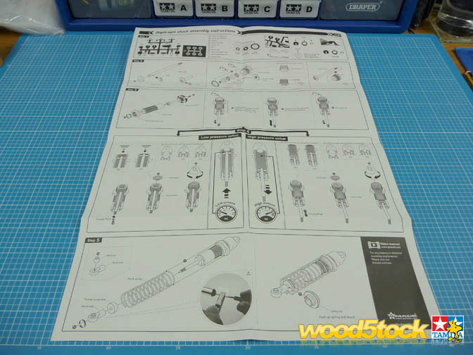

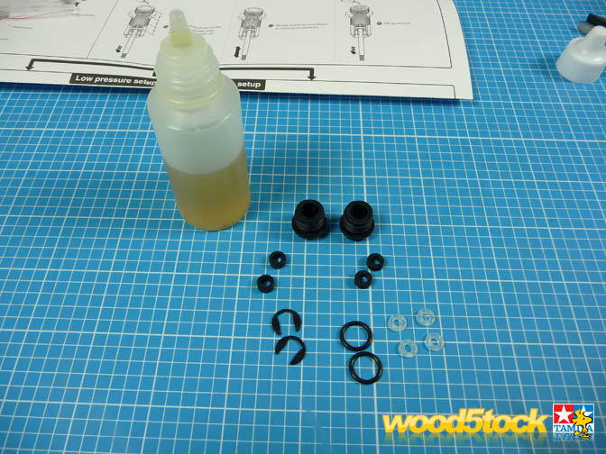

The instructions are nice, clear and intuitive
On to the rears, assembly is exactly the same so no need to go through the same thing again ;)

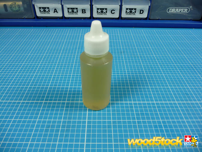

One of the many things I like with these sets is the amount of oil you get, look with the left overs I have got a whole new bottle :D
Not like the Tamiya oil we get where every time you think, will it, will it, will it, and there's just enough. Or is that just me then :blink:

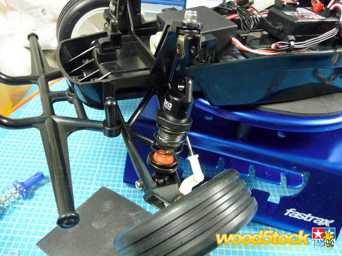

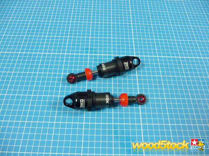

Finished full set of shocker for the use of
I didn't think they would fit first of all, as they are a little chunky, but they did perfectly
Front end done :D

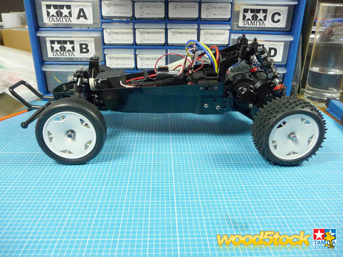

Rear end done
All finished. I didn't have time last night to have a good go over ride heights etc.

Looking great - you might need to remove the bump stops to increase the available stroke on the shocks - otherwise they'll be bottoming out and putting all the impact forces into the uprights on the plastic chassis.
Cheers bud ;)
Yes I think so as well certainly on the front as the travel is limited, they are rather trick though :D
That looks great! You certainly are putting the 'Super' into Super Hornet II!
Glad you like it, bearing in mind you're the instigator of this project ;)
Wow those shocks are really nice, will deffo have to keep them in mind. Where did you get them from?

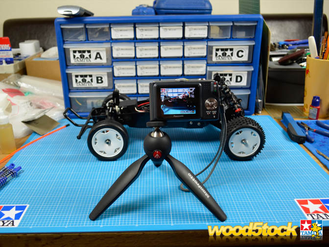

Also how are you taking photos when both hands are in the photo?
maybe he has a mutant arm. :blink: that might explain the speed Wood5tock is getting through his builds.

Those shocks look superb, much nicer then the Ansman ones I have on mine. You'll have to let us know how well they perform, might have to upgrade again!
Cheers mate, I will keep you all posted

Actually I balance the camera on the end of my... No stop it
I use my table top tripod a Manfrotto Pixi, yours from eBay for under £20 delivered. I then stick my little compact camera on top and pop the shutter on the timer ;)
And if anyones intrested I'm surrounded by these bad boys, I have found my photography lamps are not only great for photos (duh!) but as they are daylight balanced they are perfect for lighting up my work area.
As they are Cool Lites, I don't fry underneath them and they don't rack up the leccy bill :D

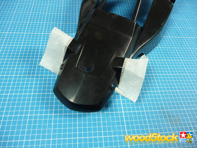

Modified the front suspension scollops on the body shell today, as you may remember when I first started putting the car together I found the strengthening pieces introduced to the top mounts necessitated Tamiya to re-model the scollops to allow adequate clearance.
I found 12.5mm from the inside of the top where it meets the body to be the magic number so this was measured and masking tape used to show the area that needed to be removed

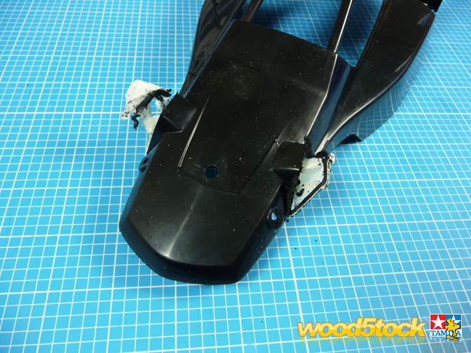

Then out with my Dremel look-alike by Draper and a fresh cutting disc
A quick offer up shows a little more needs to come off the sides
Perfect! :D
All the rough edges removed and a full fit with 'R-Clips' reveals the suspension towers have now got all the clearance they need ;)
And finally the whole shell gets flatted back with 3M Scotch Brite. then fully de-greased, washed and put into the 'purpose built' Tamiya drying cabinet. Otherwise known as the cupboard my boiler lives in :lol::lol::lol:
