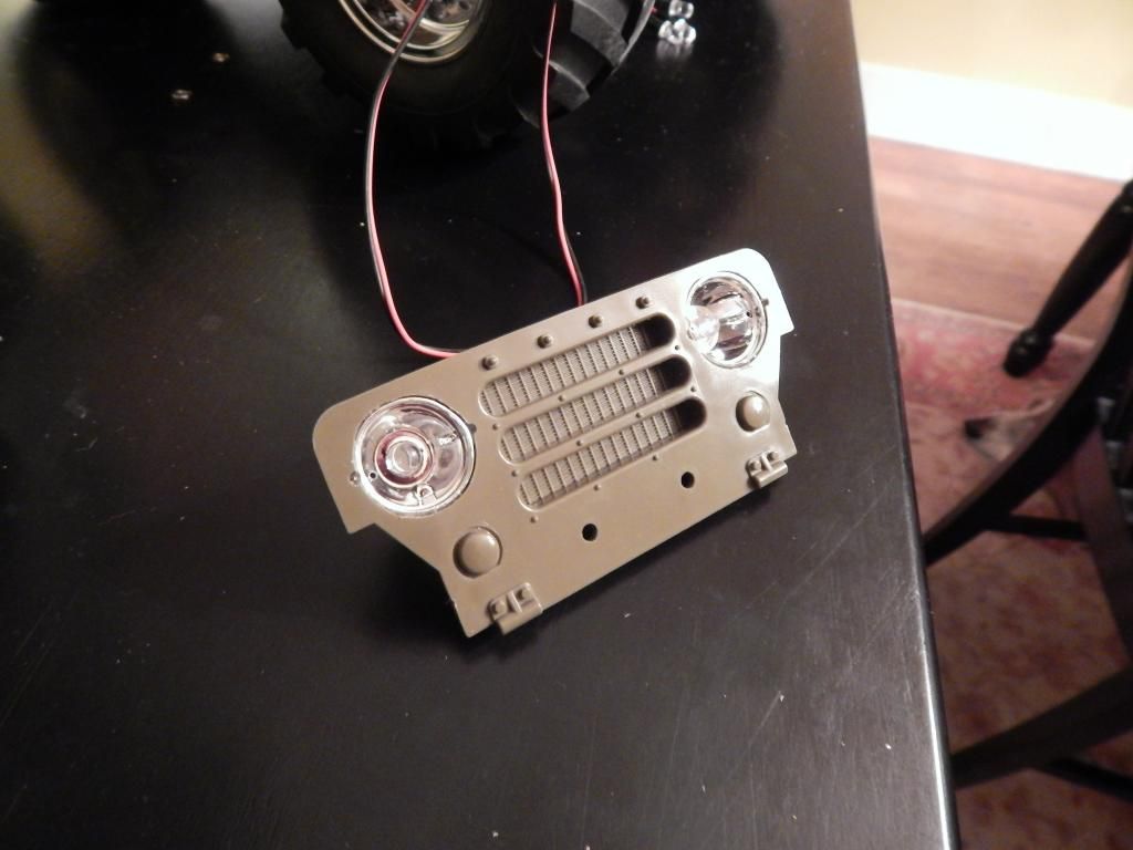

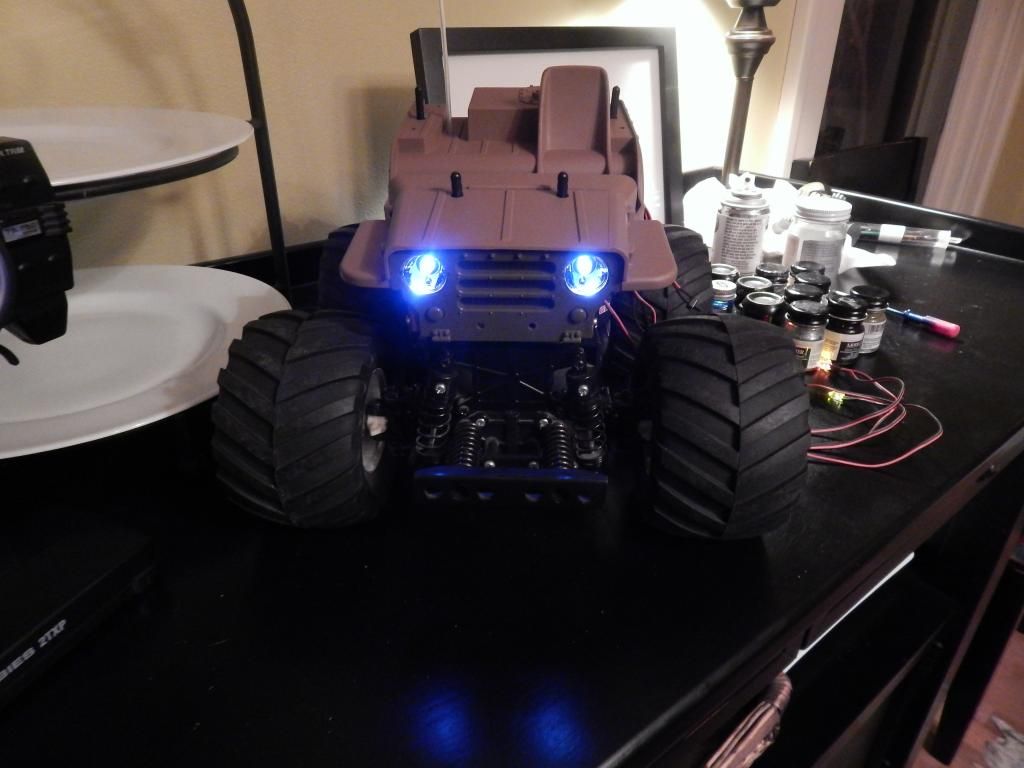

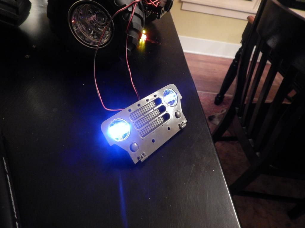

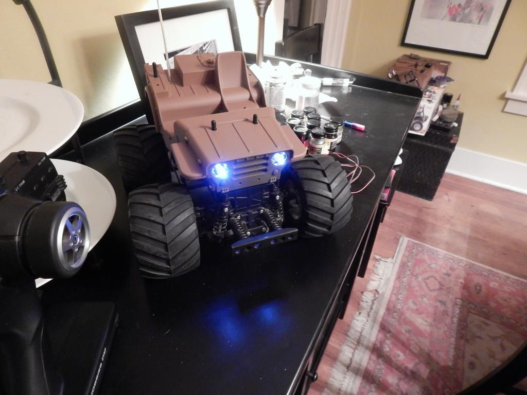

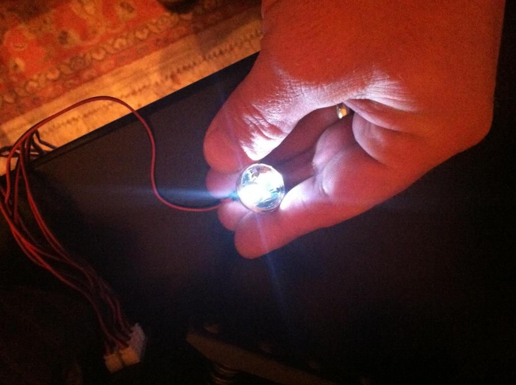

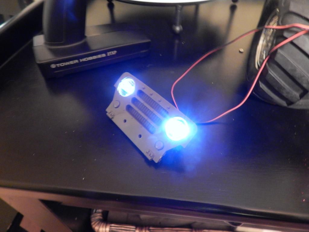

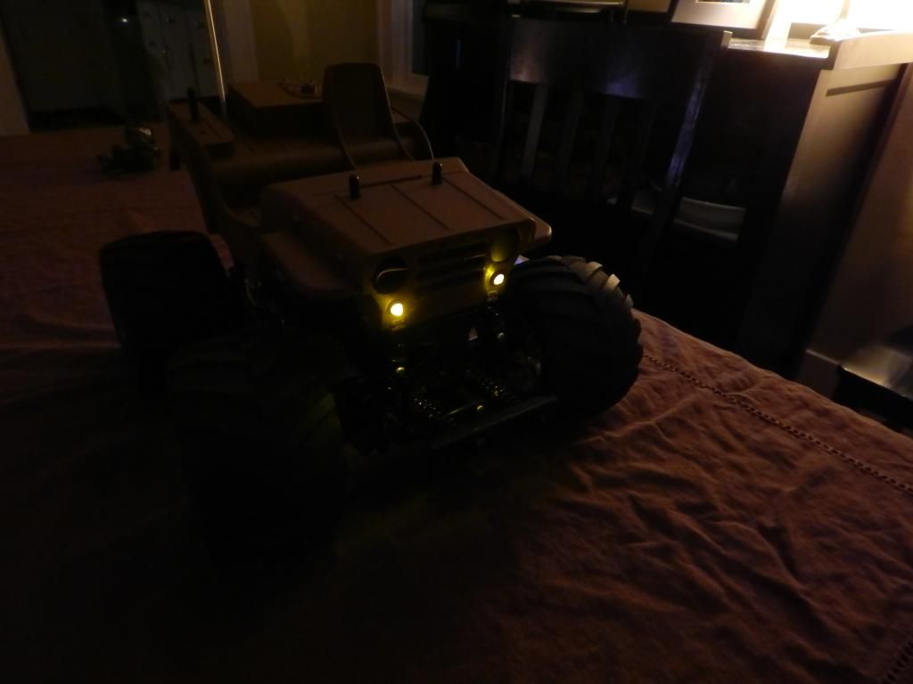

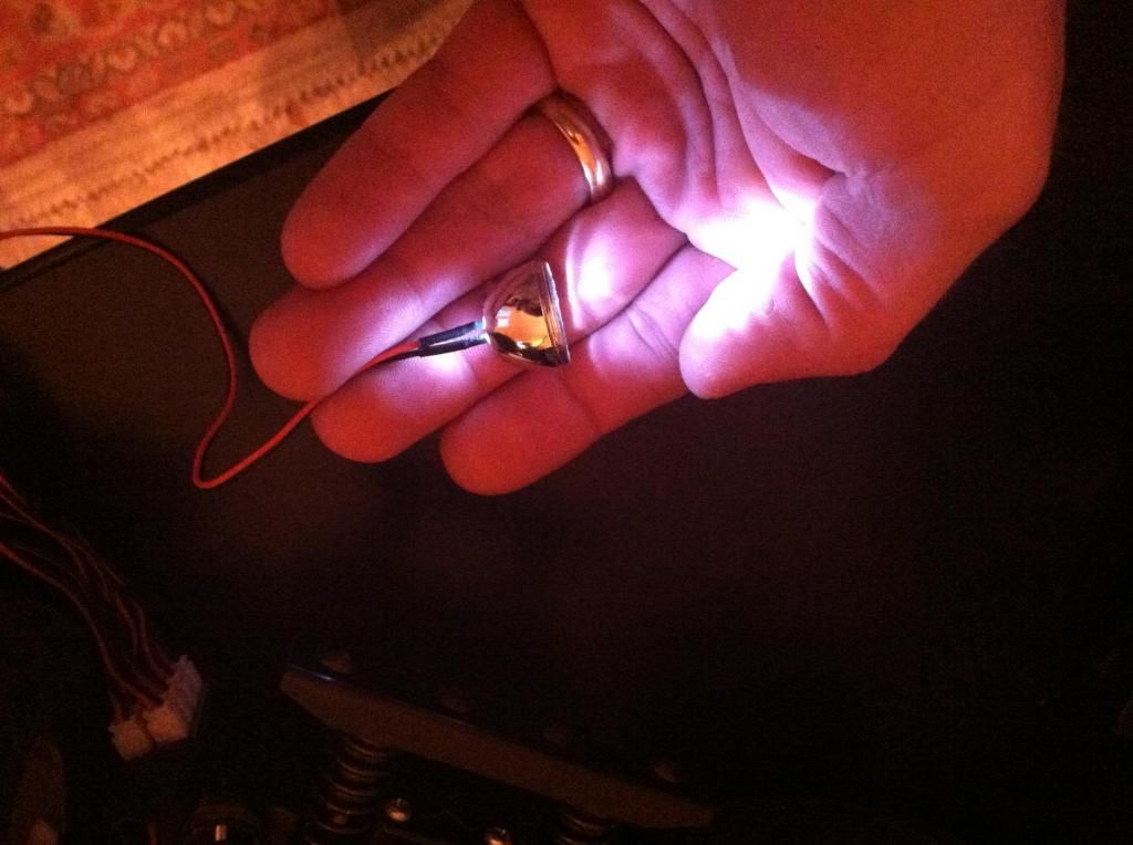

Utilizing ToyKid's method, I measured the fog light housings, centered everything up and traced the outline. Drilling a pilot hole and then all the way up to my biggest bit, I then took my Dremel to the grill to finish the job. The body mounts on the body itself had to be removed, but I will glue this sucker on once it's down. Mounted up the housings, ran the LED's and screw the housing backs on to keep the LED's from coming loose.
Success! He's got lights baby!

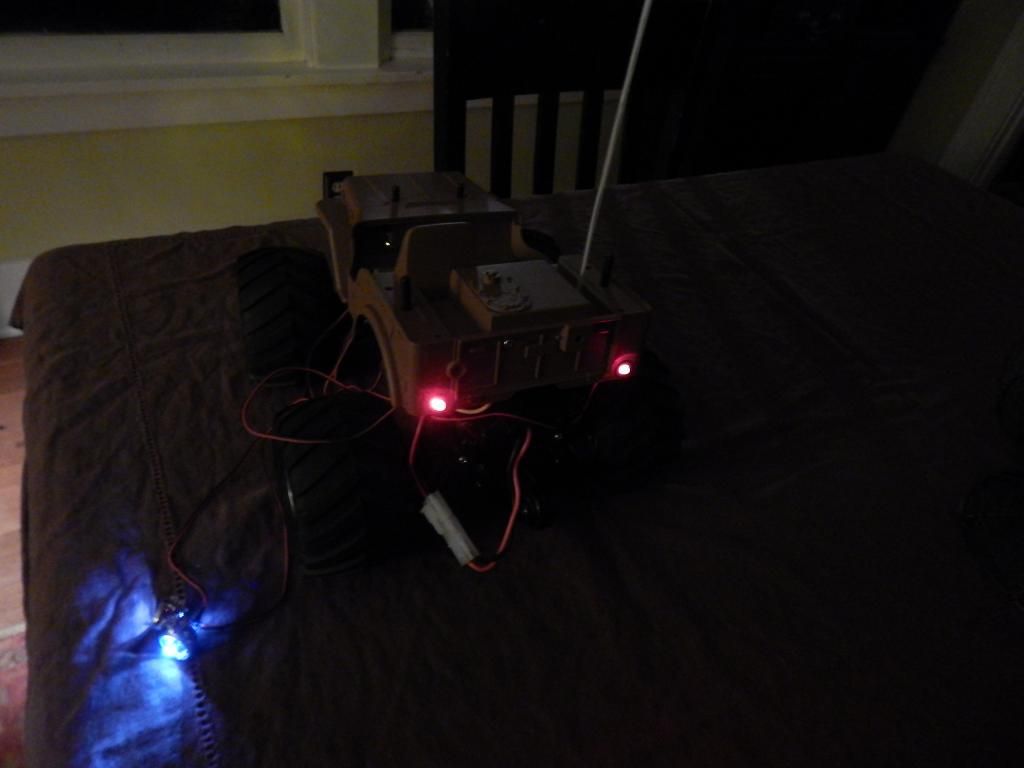

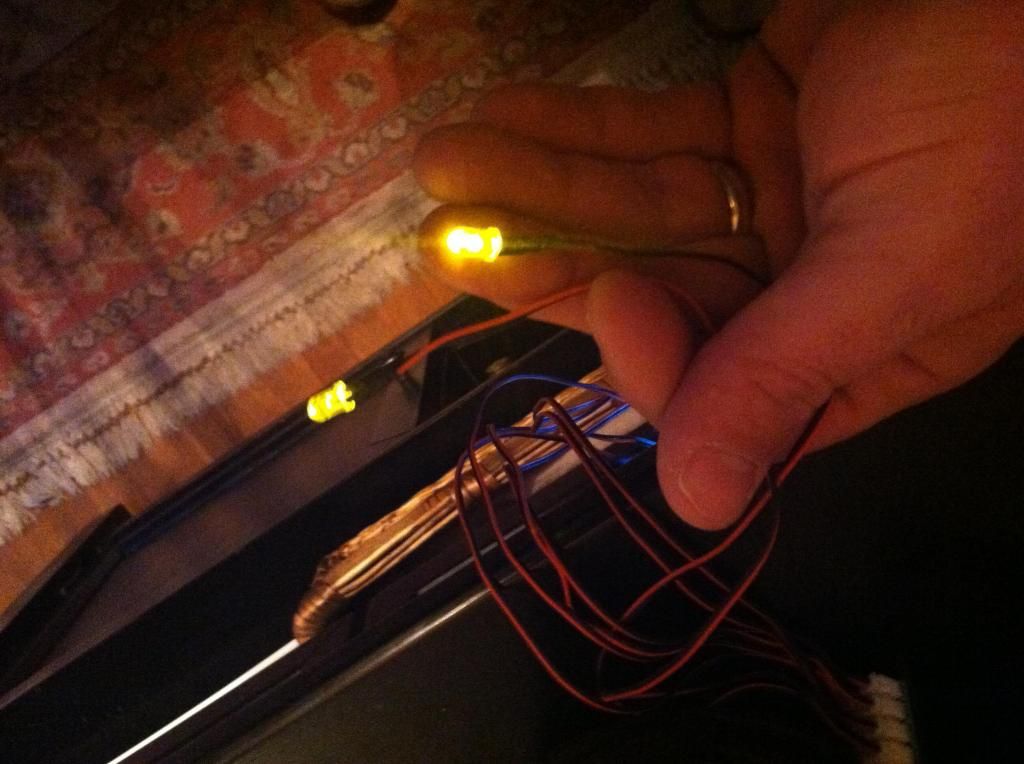

Since I took the pictures an hour or so ago, I've already drilled out the turn signal indicators and laid down the first coat of paint on the grill.
[EDIT] Added two photos of the turn signals and tail lights. Nothing's glued in at this point. Hope to start shooting the camo pattern tomorrow evening.

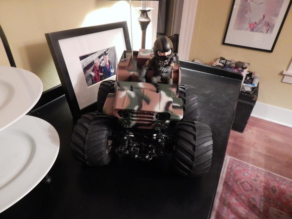

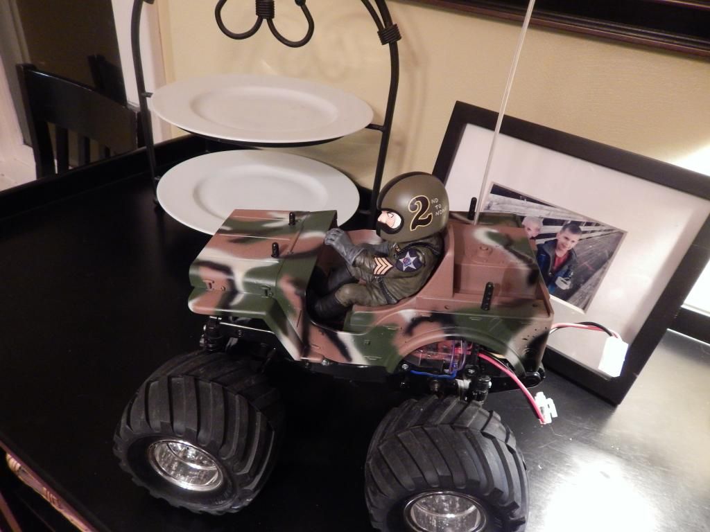

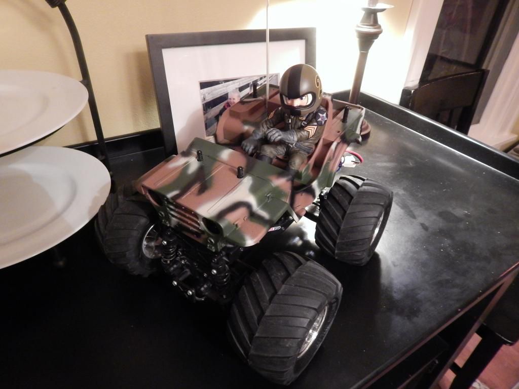

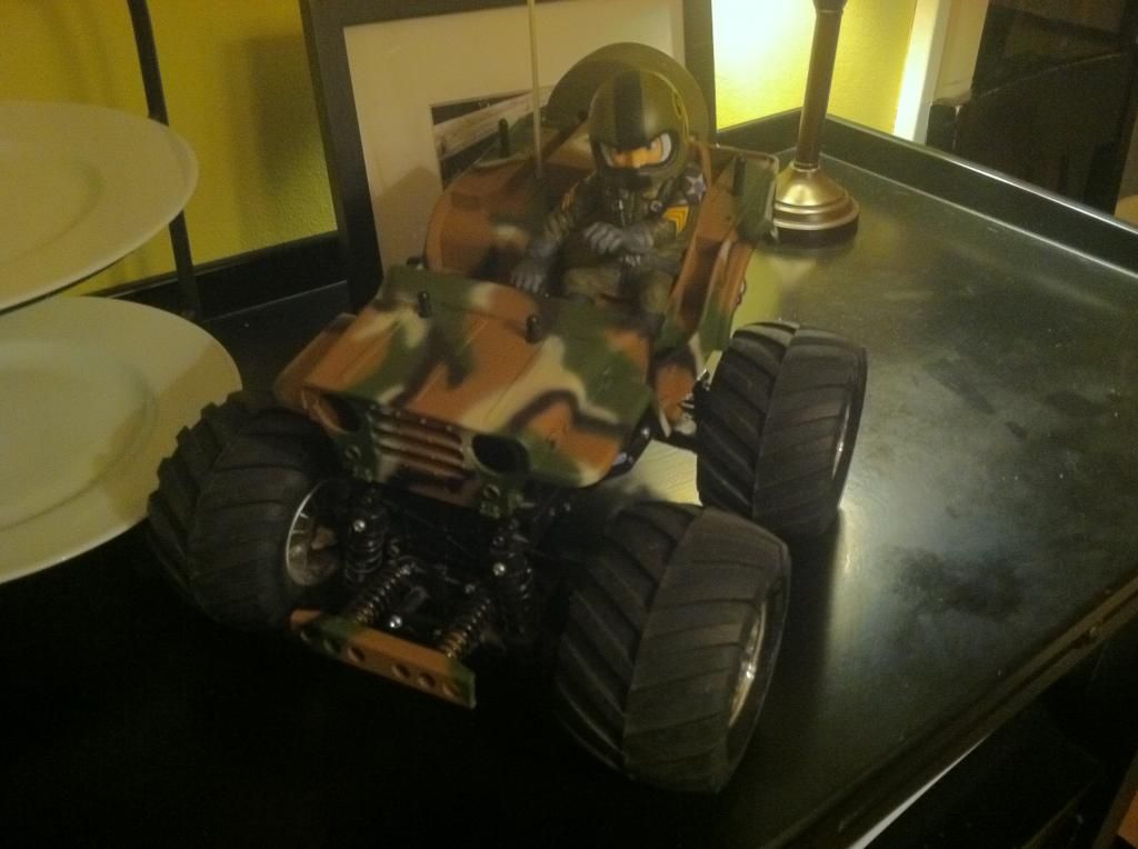

Willy gets some paint.
Lots of mistakes, lots to fix and the lines not crisp enough. But....a lot of these flaws will get fixed once I do the pastels, weathering, chipped paint and acrylic wash and other small components added.
I had the same initial reaction with my Heng Long Tiger I at first and as the build progressed, I was very stoked with the final finish.

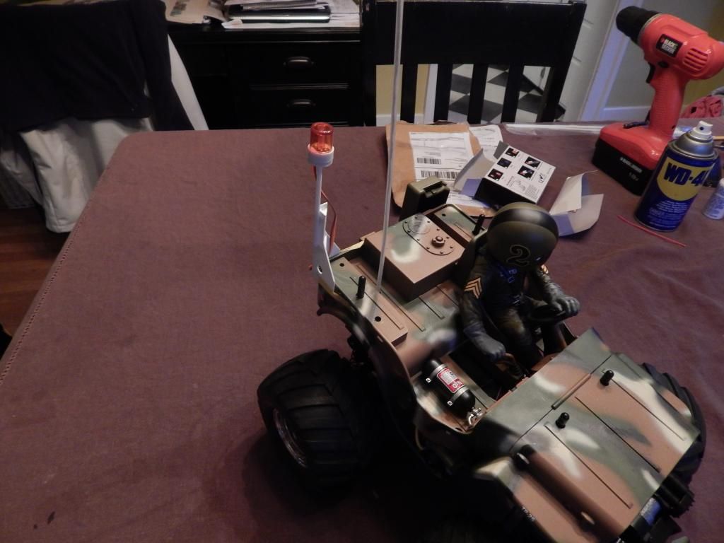

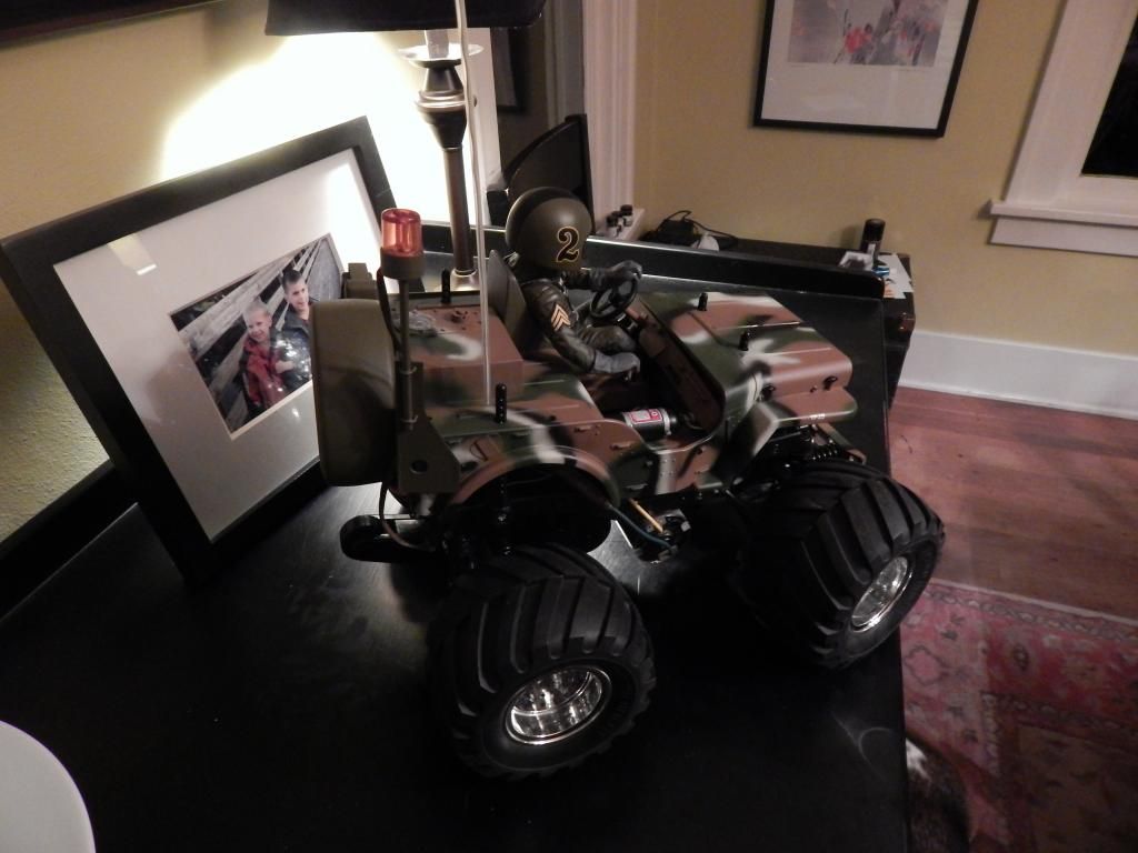

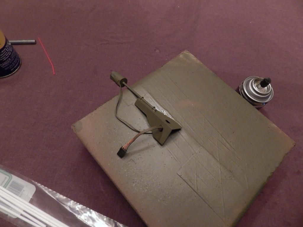

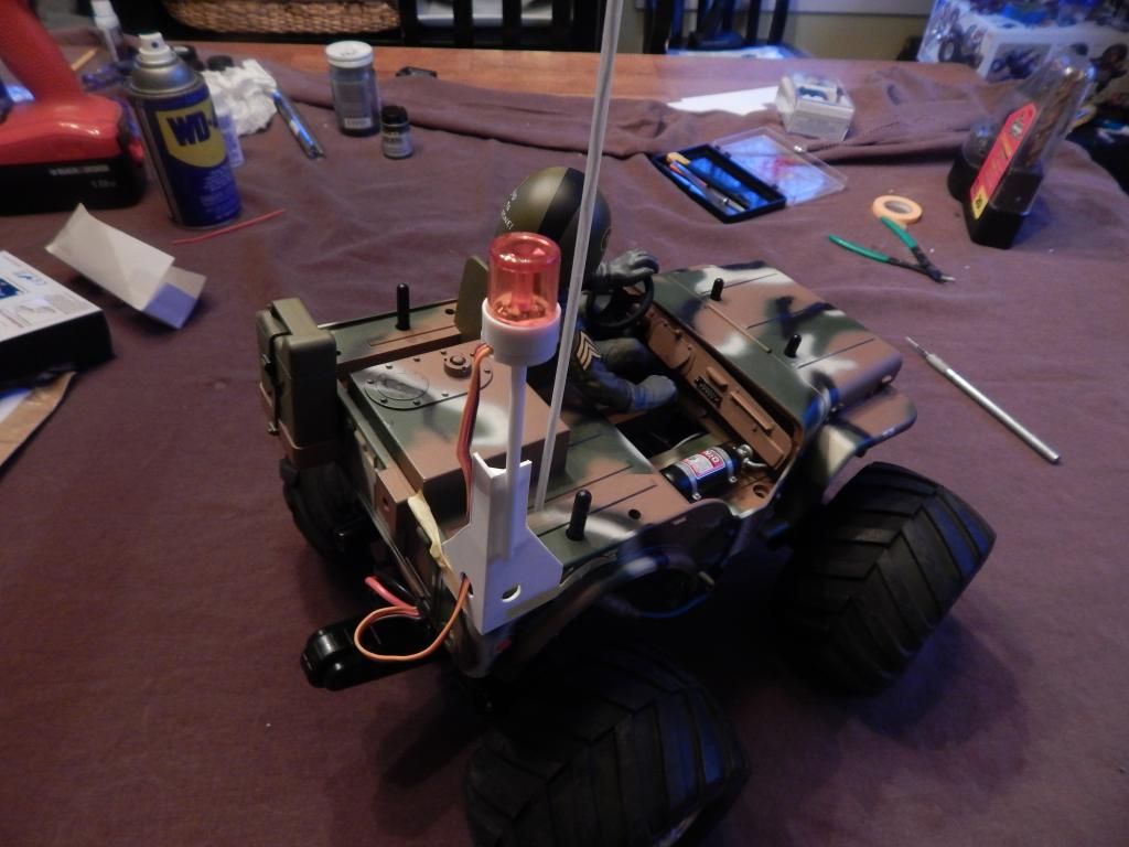

LED Orange Beacon came today, so I used some Evergreen Sheet styrene to fabricate a mount. Also utilized solder for ring braces. This is getting fun :D Filled in the ejector mark holes in the rear spare. Going to use a small removal cap to cover the screw hole and get it prepped for the Tiger mural. Installed the NOS Bottle, Willy, steering column and painted his seat Olive Drab. Waiting on a new decal sheet to arrive for the instrument panel and then glue it in place.
Also, it looks like I can start on the template for the canvas top tonight. I have an extra US Army issue shelter half that is the perfect material.
