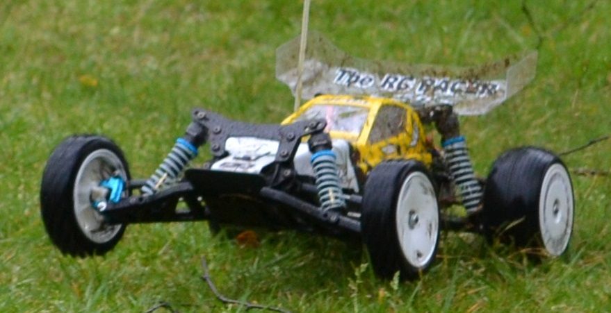

I have been building today B)
Tomorrow I will paint the body shell and get the build pictures and my thoughts up on here.
It just so happens I am going racing this Sunday with the first run of my 502, I shall take the DT03 with me and see how it handles on track. :ph34r:
I have put a total of 20 :o Hop Ups on the DT03 :blink: and its brushless :P
What are the part #s for the hop-up axles/shafts?
So far I have ordered:
54560 Lightweight gear shaft
54561 Stabilizer set
54562 Carbon damper stay (front)
54563 Carbon damper stay (rear)
54564 Aluminum battery bar
54565 Aluminum servo mount
54566 Aluminum gearbox bridge
54572 Full turnbuckle set
I have all of those above Hop Ups on mine.
I also have these
TRF aeration dampers,
Tamiya Ball Diff,
3 Racing universal drive shafts,
5 stars Alloy rear hubs
3 Racing alloy front C hubs
TRF201 rear wing
54205 Aluminium Damper bushings
54257 Reinforced gray adjusters
54503 Damper Aluminium Suspension balls
54396 DT02 Front damper attachment pins
54395 3 x 22mm Low friction Suspension shaft
Alloy drive hexes
DF03 rear wheels
Schumacher yellow mini spikes all round with tubby inserts
RW pinion.
:D:D:D:D

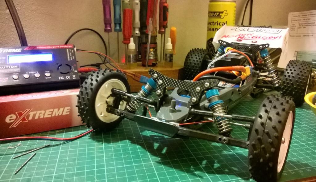

Hi, thanks for the answer, noob question but is the 5mm not the head then but the threaded area? I've not had to mess around with these previously so don't know what i'm looking at. A set of 5mm Tamiya ones are available for not a lot of $$ so I can grab them. The posts sadly didn't come with any info just with allen head screws included. I wonder if they do them in pink? :) [Edit, work in progress below]
its the ball diameter , there are long and short versions , the short ones may cause the upper arm to rub on the damper springs so go for the long type , they also come in stud type ( the screw portion is attached to the ball ) and ball nut connector type ( which are the ones you want as they are far stronger ) , here is a pic of mine with the tamiya items ,aecd2435-ecd9-4e45-a711-c489106d162d_zps 3 racing do the ball studs in pink , just search for 3racing sakura ball connector
i think i have my wires crossed , you have the 3 racing shock towers not upper suspension arms ! , you will need 5mm ball connectors for the Tamiya dampers
