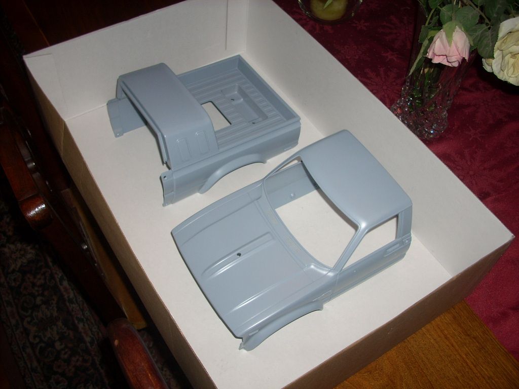

This is how I go, doing each side at a time. I use a piece of an old cotton t-shirt and cover that with brake fluid. Then I wait some hours, maybe one day, and I take the plastic and t-shirt piece off, and remove the paint rubbing the body with a piece of wood. I found out this doesn't affect the bodyshell and so it ends up nice and shiny, just like new. It's a good method because it doesn't requires gallons and gallons of expensive brake-fluid.

Thanks, mate. As I said, the method works good, but requires some work. The fluid softens the paint and you just take it off with a sharp piece of wood. I'll take a picture of that tonight to show you how it's done. The wood bit doesn't scratch the plastic and once you clean it all off it looks just like new! :)

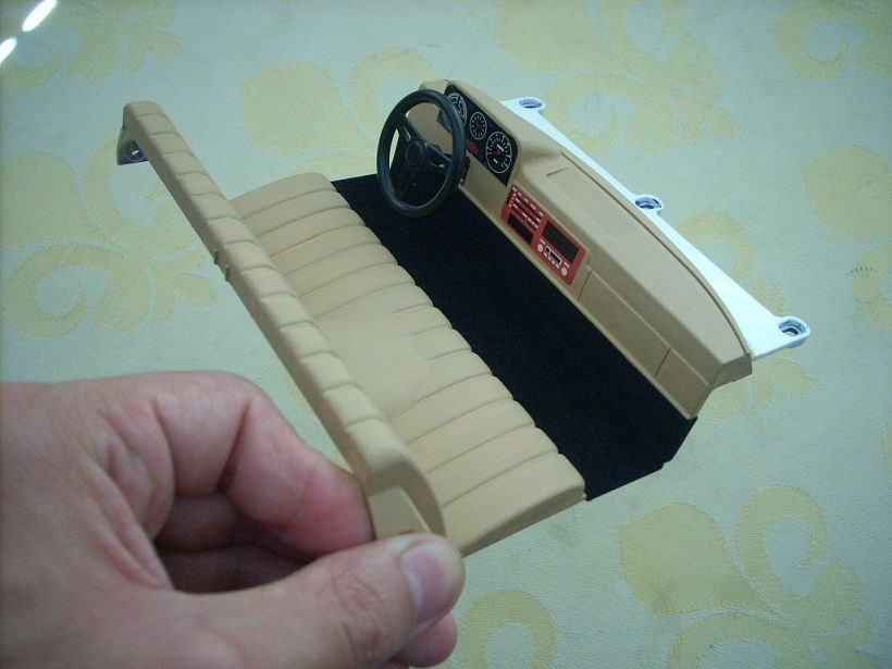

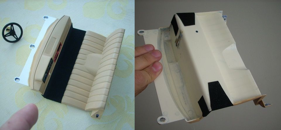

Sometimes, just sometimes, painting with brush adds an extra something to whatever you're working on. See? Also, that's the self-adhesive black velour that I got from a nice Jewish family from just across the street. It's made in the Netherlands and works excellent. It's neat looking, and it adds depth to the interior, making it look more realistic. Love it!
That's how the self-adhesive goes.
Almost ready to go!

Here's one more photo of the body before spraying the primer and the color. I did this with just one third of a small glass of brakefluid. ;)
