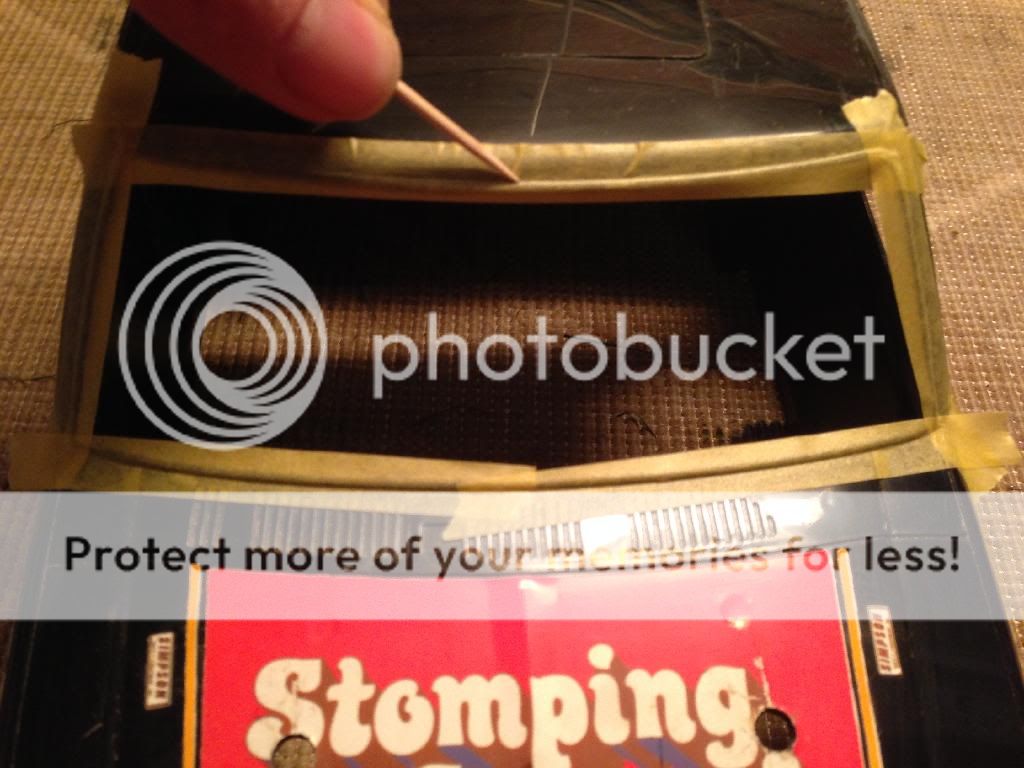

First, apply masking tape over the rubbers ensuring to overlap the body all the way round and draw round the rubbers with a cocktail stick:

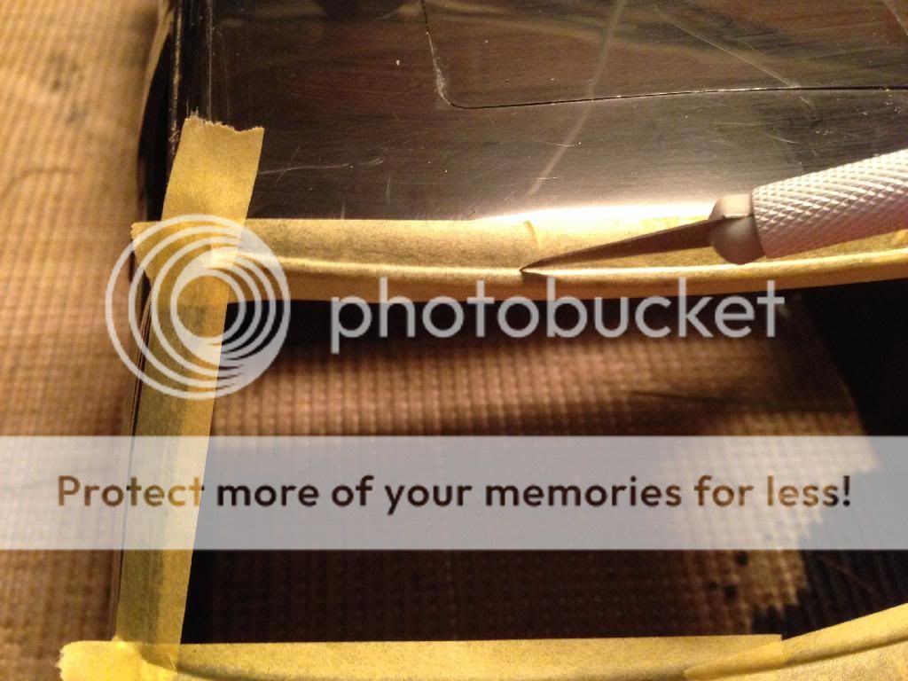

Next, gently cut along the groove you just made with a modelling knife:
Posted Image

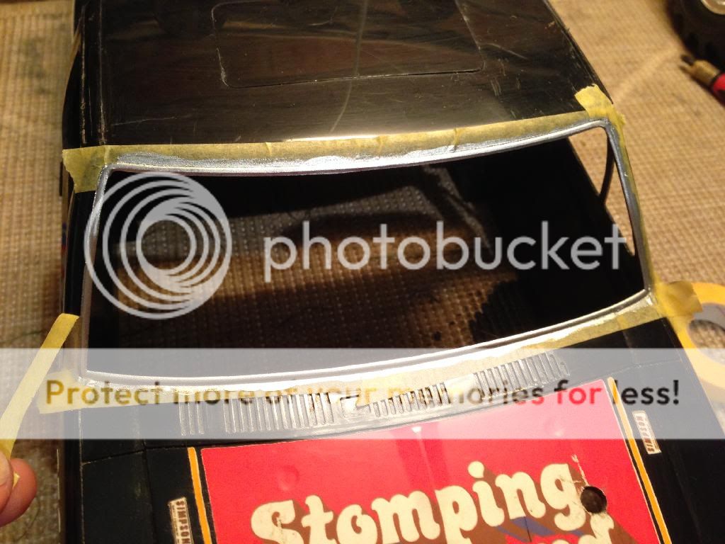

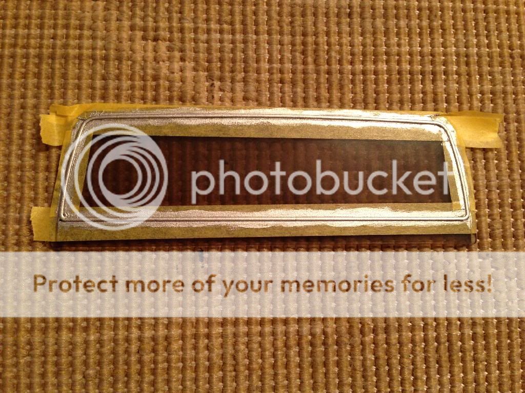

Then, peel off the masking tape that was on the rubbers:
Posted Image
Posted Image
Then, go round the edge with the cocktail stick to ensure it is well stuck down:

Next, apply the paint:
Posted Image

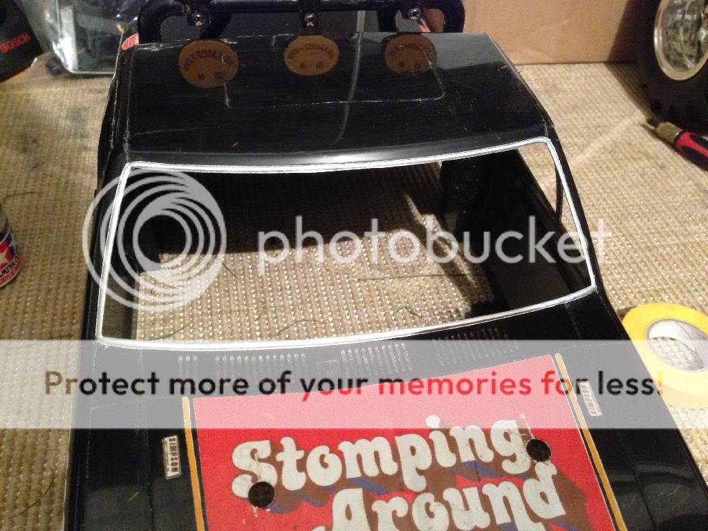

And finally peel off the masking and admire your work:
Posted Image
Posted Image

Depending on the paint used for the window trim, you can use the same toothpick and scratch off any excess paint that bled/leaked around the tape after the tape is removed.
You can wrap a paper towel around the toothpick in order to ensure a clean tip (keep adjusting the paper towel so the tip of the toothpick is wrapped with a clean part after each scrape).
Usually works best after the window trim paint is somewhat/mostly dry. There is a stage where the paint isn't wet, but is still pliable/flexible (at least for acrylics).
I've had some success with flat black on my Sand Scorcher window trim.... it rubbed off leaving the body color paint untouched underneath, thus removing the "fuzzy" look that sometimes happens after removing the tape (if the tape edge wasn't perfectly sealed against the body).
See that tiny triangular silver spot on the lower-left part of the window trim on the bottom picture above. If that black body paint is well-set (ie: many weeks old or older) then the toothpick probably won't rub it off and just the silver will come off. Note that sometimes the new paint can react with the old paint and cause problems, so be careful not to make it worse. Obviously you can use a fine tip brush to touch up any problem areas if the toothpick takes away too much paint during this procedure.

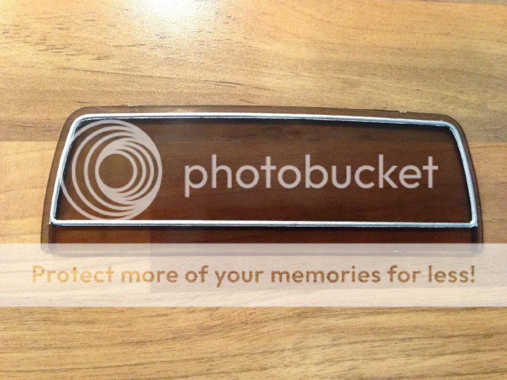

Just done this again on my shelfer resto Blackfoot and it came out well:
Posted Image
I also used it on the trickier rear window and that also worked a treat, am really pleased!
Posted Image
Posted Image
Posted Image
