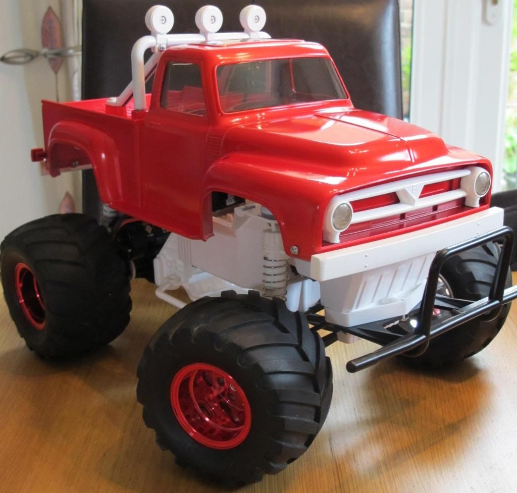

Said shocks are now installed on my pumpkin project - I would say the front shocks compress ca 2mm once the body is fitted (no battery).
After pressing the chassis down, the shocks do return most of the way to their static position - in a running situation i'd expect them to fully return as the weight would be transferred to the rear on acceleration.
I didn't compare the spring to the supershot one sorry - mine seem to be as i'd expect so no reason to compare really.
Whether mine are different due to how i built them, or the different shock oil , or just different spring quality control I don't know.
Edit - having read back on the thread one important point is that you are not using any preload adjusters, which will have an impact on the spring rate / ride height....
6977d1d6-dc3d-4746-8092-ec3a46ca6c61_zps

No thread Scott - as usual I buy one project and it turns into two. The shell above came from a used pumpkin. The wheels and TS-39 paint were in the spares box as were the white cvas. I just saw an opportunity to build up a white chassis, especially with HK prices for the chassis tub and d parts.
The old pumpkin chassis have been 'aged' and us having a different body fitted, one which is requiring some adjustments ;)
