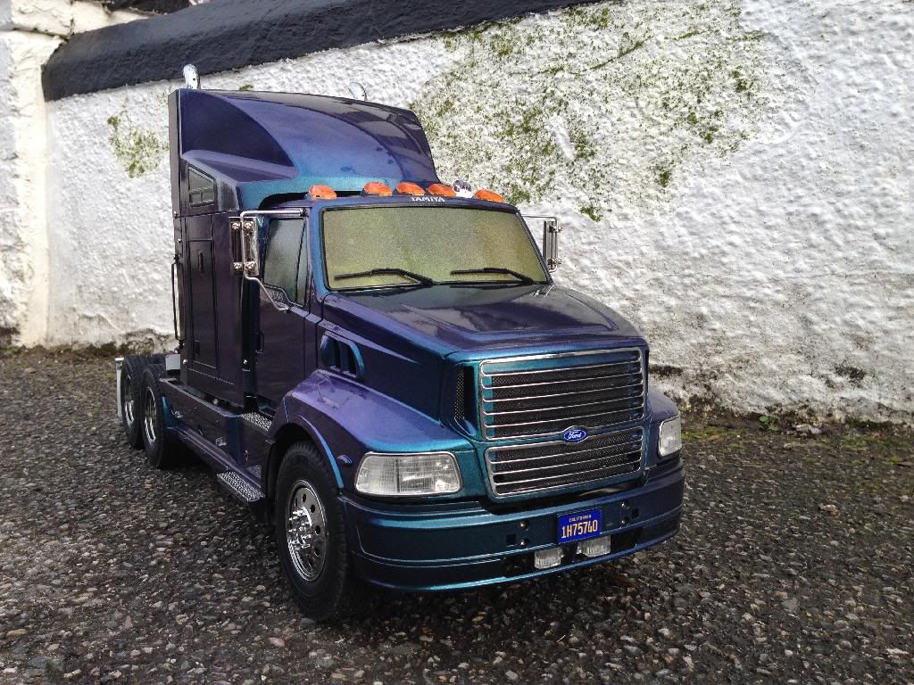

Cheap and fast LOL... Dont get me wrong I would not paint my harley like that but its an RC car :wub:
Thanks for the plug on my guide. Take your time and let the paint cure. So many good paint jobs are messed up from not being patient. On my Landy below I let to paint cure two days before taping off the roof and fender trims. Trust me, I wanted to keep going on it but you just have to be patient
