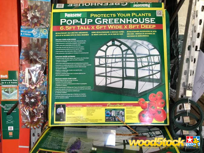

Quoted Bromvw's post re DIY spray booth at 9:15, next thing I find myself in B&Q at 10:20 having bought this
:lol::lol::lol:
All yours for £7.48

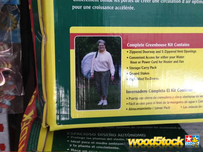

Or if you have a spare £99 you could go for the delux walk in Tamiya spray booth :lol::lol::lol:
Portable too, :D
I do actually own one of these and they are very good :ph34r:;)
Sorry VR but that's a load of testicals so long as your in a well vented area . I assume everyone has the common sense to not use a booth in a enclose garage or shed :blink:
I should have said that I use the big-un as an actual green house growing veg and flowers :lol::lol::lol:
