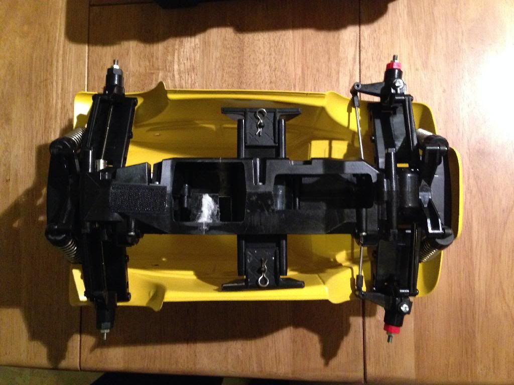

Or you could shorten a TL01 chassis like I've done to fit this Kamtec Baja body.
AE1FF70E-506E-4B77-BD11-8E8B836B4147_zps
It gives you the choice of RWD, FWD or 4x4 all in one package that's easy to swap around. I'm just waiting for the standard TL01 arms to arrive to replace these longer "B" arms.

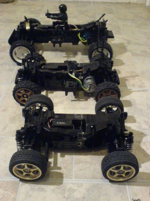

yes as its the only part your able to cut out without major mods needed. It is also a good place to add chassis braces either side to re strengthen the chassis.
James
Yep it's the obvious point to remove and leaves you with plenty of material to rebond the chassis halfs again. In the below pic I've got a standard length TL01B in the background, a 210mm wheelbase TL chassis in the middle that still retains it's battery location and a super short 170mm wheelbase chassis that fits the Wild Willy body. That one needed to loose the battery holder to shorten it enough.
With the chassis I just shortened for the Beetle body I only needed to remove 15mm so was even able to retain the shelf in the "electronics bay" :)
