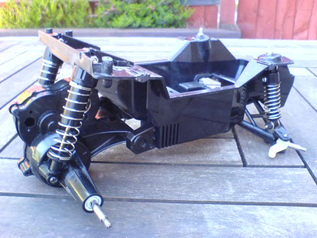

I like the look of a tamiya pajero 58044.
I got a new lunchbox chassis and left over rear axle and front arms, m-05 friction shocks. It wont be authentic model but close enough.
I am wondering what parts from what Tamiya cars? to hold rear axle in place. axle gearbox holder. it seem to me is fixed hole instead of slot type.
which Tamiya car that has those parts ?

Tamiya 84365 CW01 CVA Yellow Short Shock Damper Unit
or
Tamiya 84347 CW-01 C.V.A. Short Shock Unit Set II White Style
instead of mucking about with M05 leftovers, high chance they'll be too short
(in the CVA lineup, Std > Short > Mini > SuperMini)

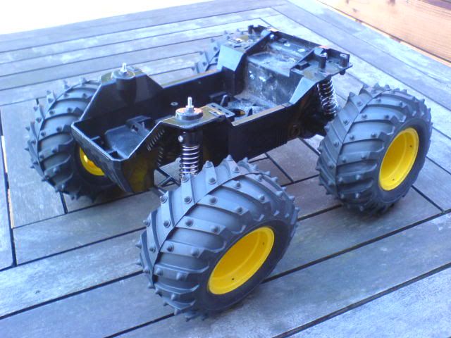

It was restoring an old Lunchbox that got me back into Tamiya 5-6 years ago. I'd replaced so much of the old chassis I was able to use the bits to mock up the Montero chassis before I ever knew it existed. If I'd known I would've fitted the Brat wheels but as it is I used some MB wheels.
That's CVA short shocks on the rear but the previous owner had removed the "battery shelf", think they are touring car friction shocks that were a little too long for the front end. Lots of fun and with the larger wheels it would back flip when you nailed the throttle :) but a challenge to find a body that fitted. I was going to build a Monster Mini but ended up giving it to my nephew.
Nice! Im starting this build.. ordered grasshopper gearbox part tree... I have lot of stuff to order.. like complete gears set, and all those small gearbox bits.

I want to build a conversion of the Monterointo the Pajero to.
I have a boxed "Wheelie Montero" and the mini C.V.A.s in White (also have (short C.V.A.s in whithe because i was not shure about the lengh).
what else would i be needing?
1.) The Brat rims & wheels -> check! i will get them
2.) screws & nuts for the wheels -> hm i don`t know what screwbag i have to get....
3.) the front wheelaxles -> i don´t know if i can use the Lunchbox (have the already at home) ones or if i have to get Grasshopper ones (maybe i also have them already at home -> must check)
Is there anything else i have to get?
PS:
I don`t want an original Pajero, i want a lookalilike Pajero with oilshocks and a "pivot gearbox" like the Lunchbox or the Hornet.....
I´m happy about every recomendations and tipps, i`m happy about beeing a little part of such a nice community!

I've done this conversion and tinkered with the gearbox pivots. I vaguely remember the slotted pivots actually extended the wheelbase a bit over the fixed Grasshopper pivots if that matters to you. The end result of the conversion is much more bouncey than the stock Lunch Box. It really reminded me of my old Marui Super Wheelie Land Cruiser.
I'll make the conversion with the slotted pivots.

Besides I staret already to build it, now I'm stuck because tere is a part that I have to find, its the grasshopper gearbox pivot.... ....I thought I can use the lunchbox slotted pivot, but no, I have to get the grasshopper one :D.
Thanks kev!
I don't want to sell it, is would be work and I know I would regret it.
You can also use the Lunchbox/Hornet slotted pivots alright on your Pajero. That would make it a better runner, specially if you do the 3rd shock mod.

I would like to remove the lunchbox parts to lower the chassis.
I think I will need even shorter dampers than the mini CVDs and the grasshopper gearbox mount.
But I don't know how to mount the servo......
But maybe i'll try the higher ridehight of the lunchbox, it just looks a bit odd....
Check out the old Pajero #44 manual and you will see that the servo will still mount in with a bit of work . The Camel Pajero I linked you to is built as a #44 Pajero using a Lunchbox re-release chassis tub and I used the old type friction front dampers that I made from parts , and left off the Lunchbox battery holder etc to keep the original ride height

For now ill keep the lifted ridehight, the oilshocks do work very well.
Maybe I lower it if I can find shorter CVAs.
