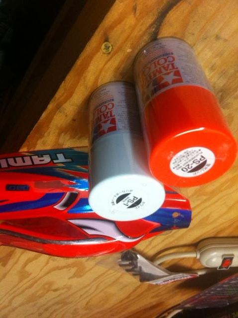

I just ran out to the garage to check.. I was going to laugh at myself if the directions or lid said to back it with white.. I am horrible about reading directions for stuff like this.. lol. It actually didn't say it. but as you will see in my pic, I heeded your advice and a few of the others here and will be backing it with white this time. I am hoping to scuff the spots that have chipped, paint it again with florescent red again, back it with PS White, and hope it sticks. I will scuff the next shell too. This shell already has a bit of abuse so it isn't going to look all that great when done, the DB01 shells are starting to get a little rare so I am going to try to make this one last as long as I can (I have another new one just to hoard a bit).
