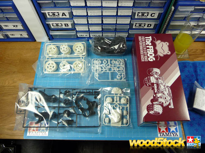

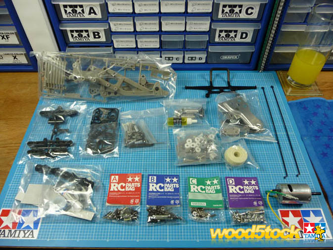

wood5tock 864 Posted March 13, 2014 The best laid plans of Mice and Tamiyaholics... I did my best to keep the shrink wrap on this until other stuff was finished, but with the Super Hornet on hold (waiting on news about the decals) and at this point (Monday) waiting on all my Bommerang parts orders (which have arrived far quicker than expected) I decided I wanted to do something else so i grabbed my Re-re Frog kit which arrived back at the very end of January and started it (I don't think I did too bad hanging on to a new kit for that long) Right here we go Parts bags in their drawers The other parts bags put into misc drawers ready for the build Now on to the build 4 Share this post Link to post Share on other sites

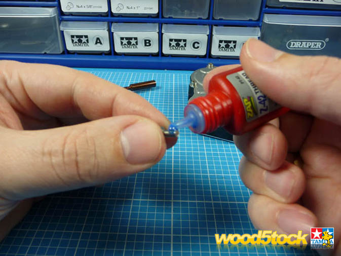

wood5tock 864 Posted March 13, 2014 The Chassis A little squirt of grease makes the self tappers cut easier A drop of blue thread lock as I am screwing into metal On goes some foam tape to grip the battery pack better as per instructions, got it straight as well One assembled chassis 2 Share this post Link to post Share on other sites

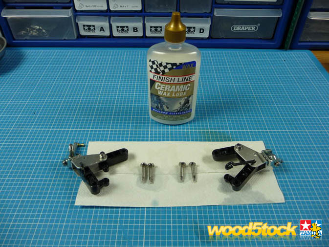

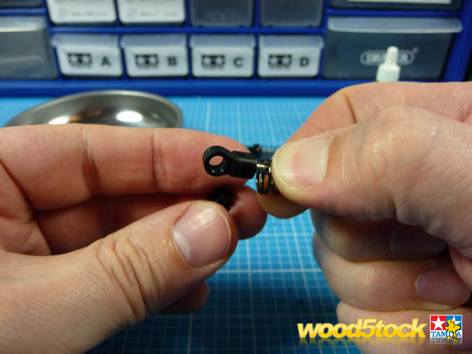

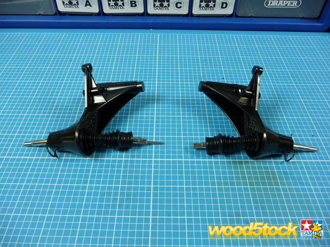

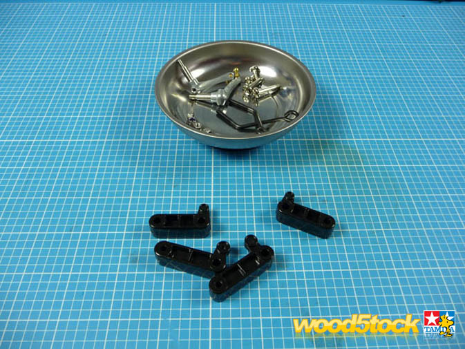

wood5tock 864 Posted March 13, 2014 Front suspension I came up with a cunning way to precisely drip the wax lube on my parts, Oh err 1 Share this post Link to post Share on other sites

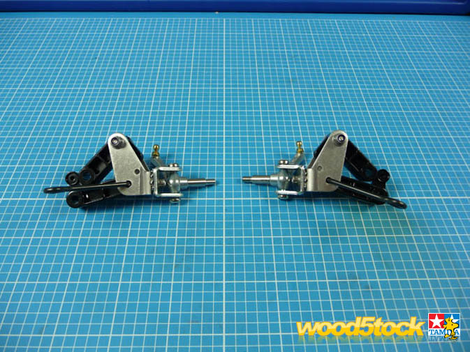

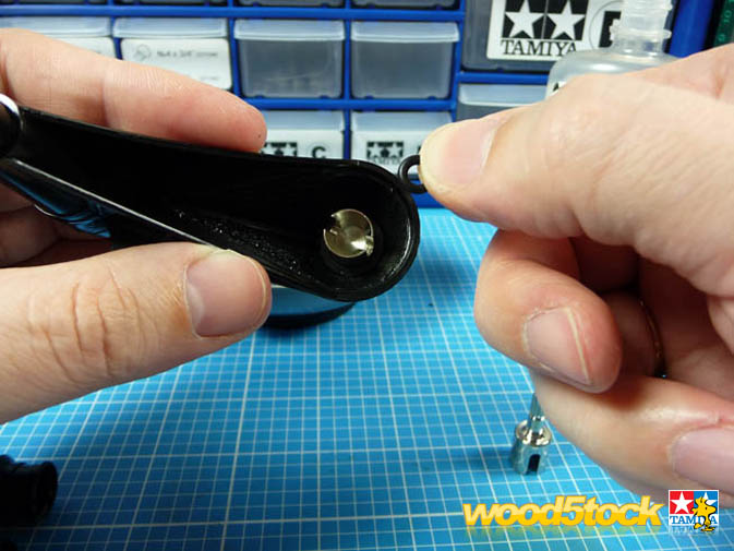

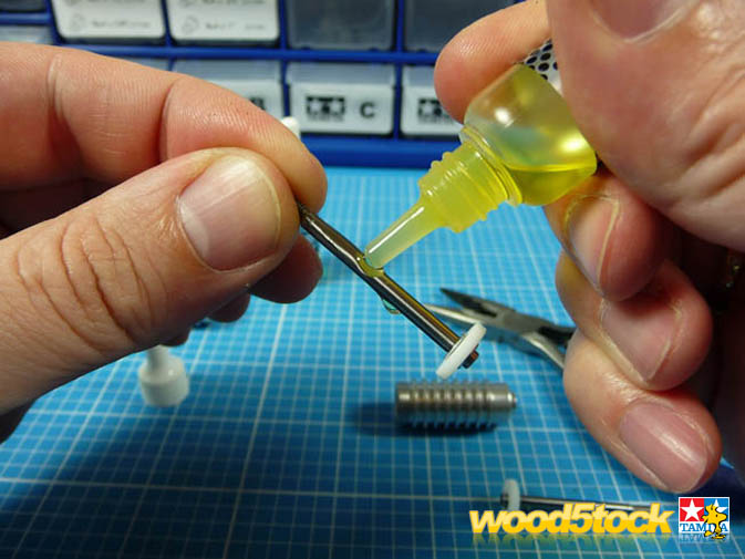

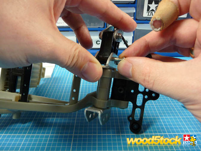

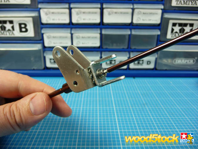

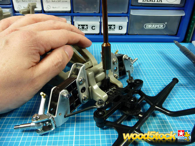

wood5tock 864 Posted March 13, 2014 Attaching suspension stays My first introduction to anti wear grease, my first impression is it's a little like silver copper slip but the binding agent has a much stickier property. I found a nice way to apply it was with a cotton wool bud, seemed to do the trick I have always been intrigued by the ORV front suspension. I knew roughly how it worked but it's nice to have it actually in my hands for once 2 Share this post Link to post Share on other sites

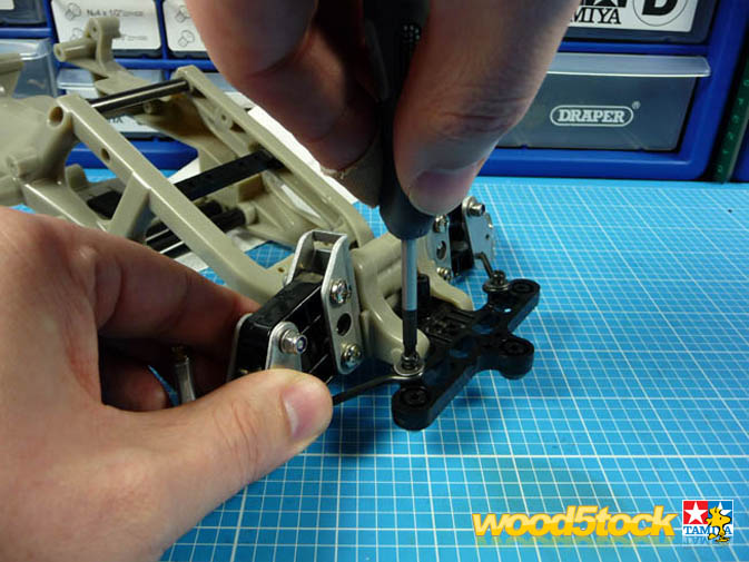

wood5tock 864 Posted March 13, 2014 Attaching front suspension 2 Share this post Link to post Share on other sites

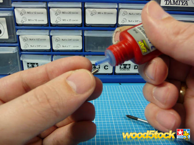

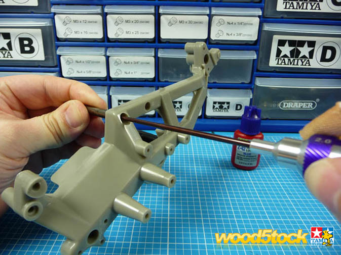

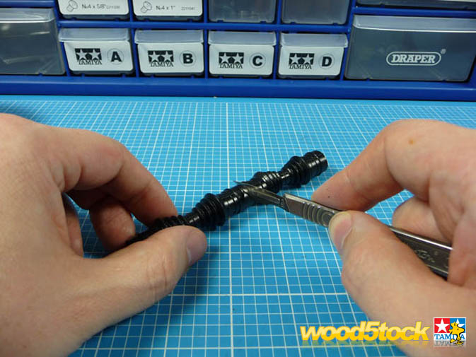

wood5tock 864 Posted March 13, 2014 Attaching fron bumper etc Once again giving the hole a quick squirt to aid threading I decided to seal the edges of the reinforcing plate with Gorilla Super Glue to prevent any fraying etc 3 Share this post Link to post Share on other sites

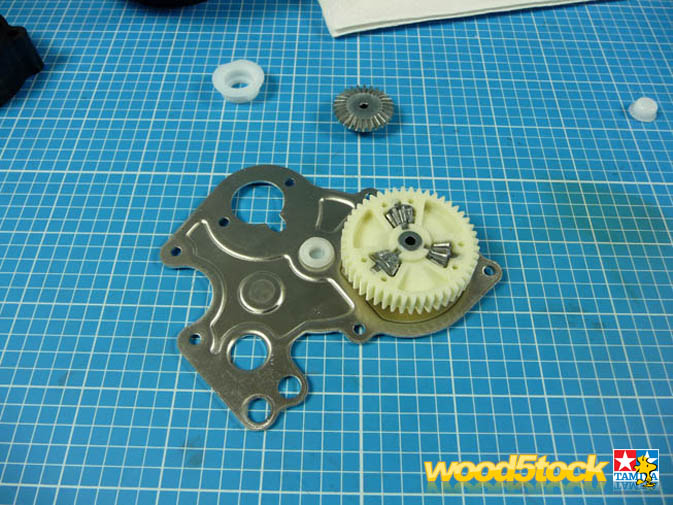

wood5tock 864 Posted March 14, 2014 Thanks for all the comments guys On with the build Spur gear Gearbox part 1 Share this post Link to post Share on other sites
wood5tock 864 Posted March 14, 2014 Gearbox part 2 Once again where possible I have swapped out the original fasteners for stainless items Share this post Link to post Share on other sites

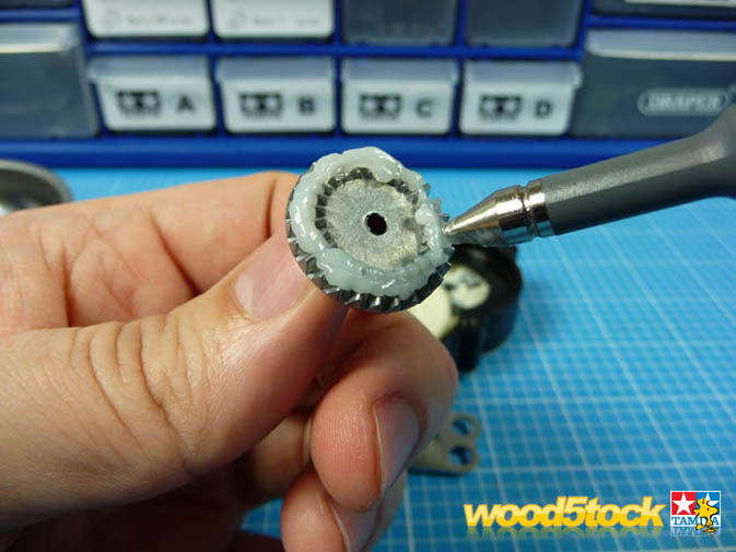

wood5tock 864 Posted March 14, 2014 10 Installing the gearbox Drive shaft assembly A good dob of AW grease with a cotton wool bud Share this post Link to post Share on other sites

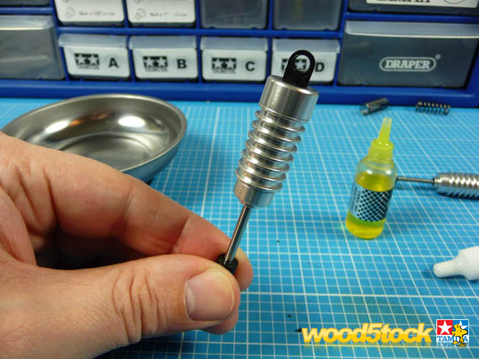

wood5tock 864 Posted March 14, 2014 Rear dampers Still had some damper oil left over from my Novafox Share this post Link to post Share on other sites
