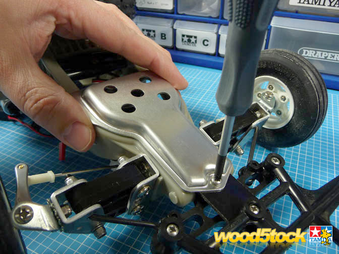

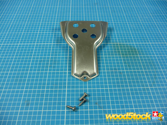

wood5tock 864 Posted April 3, 2014 A bit more done this afternoon/evening, managed to save the roll cage bleed issue thankfully so I could get on with using proper masking tape to do the pink strip. I also finished prepping 'Glenn' ready for his coat of primer I also put the spot lamps together Then as a final job I decided to add the chassis guard (almost called it a sump guard ) 1 Share this post Link to post Share on other sites

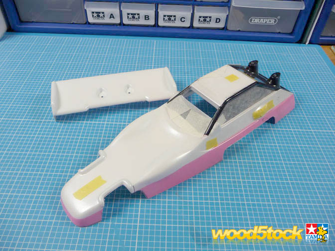

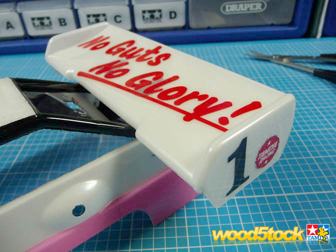

wood5tock 864 Posted April 7, 2014 With the famous pink stripe done it was time to do the white. As with all my runner versions I am continuing the theme of using a pearlescent version of the original box art colours, in this case PS-57. I was going to do the pink in PS-50 backed with the original PS-11 but lost my bottle as I didn't know if the PS-50 would work With the PS-57 dry i then backed everything with original PS-1 white I then pulled of all the spray film to reveal... ...Well to be honest something a little disappointing I don't really know where my head was at with this one but it isn't up to my standard. However this is a runner and I will buy a new body in the future and re-do it for my own sanity With the body not filling me with much pride I had second thoughts about applying decals at this stage, but I figured the paint job wasn't enough of a debacle to get to precious. If it was a vintage 'shelf queen' it would be a different matter Top sides done And here we have a finished body, not to bad after all The weather has gone a bit nasty today so I will have to prime Glenn and his spot lamps another day this week so stay tooned 4 Share this post Link to post Share on other sites

wood5tock 864 Posted April 14, 2014 I am happy with colour it's self as it's a subtle twist on the original box art, I'm just not happy with the way it came out or rather how I did it in the first place When I get a replacement shell in the future I will also try out the metallic pink backed in the solid pink, which I should have done in the first place. I'm not sure what planet I was on when I attempted this :lol: 1 Share this post Link to post Share on other sites
