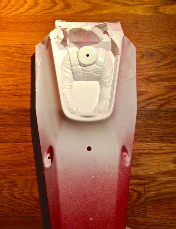

Based on a tip from this page on RC Car Action, I tried cutting the overspray mask around the driver and painting that area white. Looks grim during the process...
...but after removing the mask, it's all good:
I've tried out the included driver-area stickers for now, but just can't see them lasting very long. They're trying to cover highly irregular surfaces. I'll probably do some hand-painting once they inevitably fall off or get dirt stuck under them.

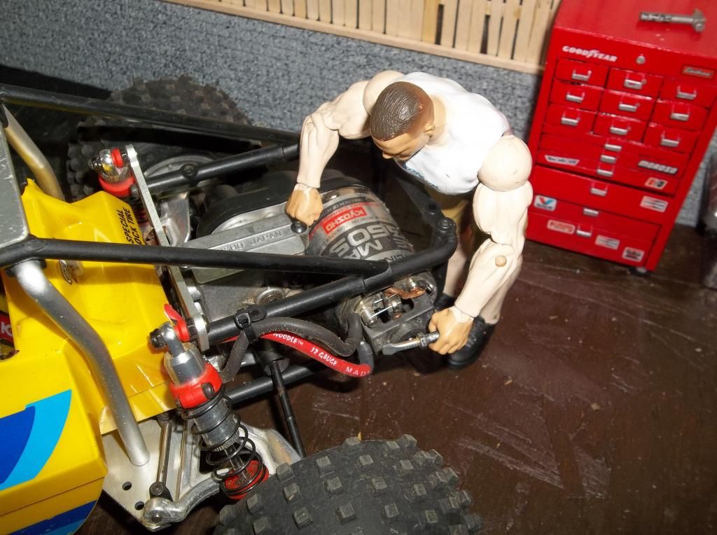

I finally found a fitting motor for my Scorpion after I burned out the Sport tuned I had originally put it it. It's a Le Mans 360st. Anybody know anything about this motor? It's fast I know that.
How did you burn out the Sport Tuned?
The 360ST has a longer can (550 size) than regular 540 motors as I'm sure you already noticed.
This gives it more torque.
Back in the day Kyosho used the numbers to indicate runtime
The "360" designation originally meant that it was designed for 360 seconds (6 minutes) of racing before the batteries of the day dumped.
The 240ST motor was a 4 minute racing motor, and the 480S and 480T were 8 minute motors designed for Speed and Torque respectively.
Of course these numbers were approximate and your runtime would vary base on battery capacity and running conditions.
The 360ST was the regular version with bushings and fixed endbell whereas the 360 Gold was fitted with ball bearings and adjustable timing. There was also the 360PT.

Thanks for that info Champ85, I actually broke a brush holder/spring on the Sport tuned. It was hot and I got into a bind and it snapped right off.
That's too bad. They are usually pretty good motors.
Hopefully the 360ST serves you well.
