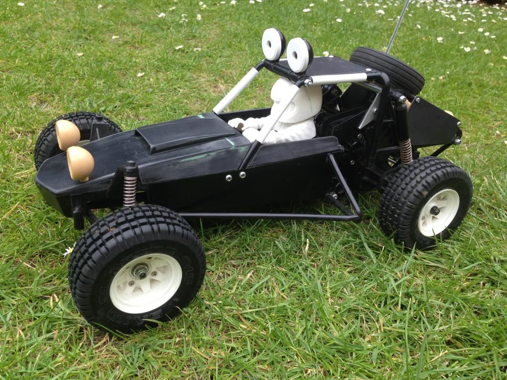

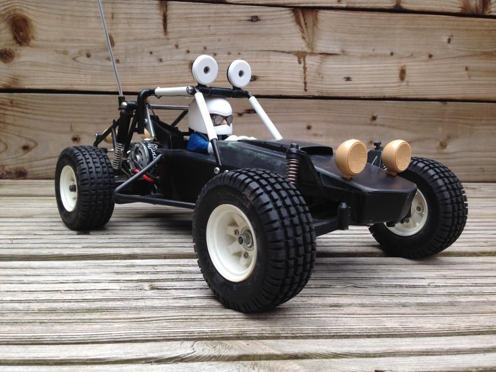

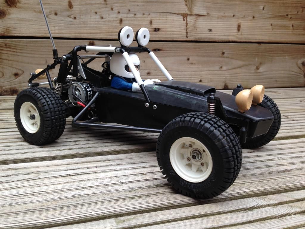

So anyway... actually Jenny I kinda used an idea you suggested about the padding on the rollcage. I've used some 6mm styrene tubing which I cut to length and slit open to allow me to wrap it around the cage bars. It holds itself on quite tight and only shows a 1-2mm gap where I slit it. I've also bolted on a plasticard roof panel and glued some tabs inside the bonnet to secure it near the roll bars.
Here's the pics.
0F6C2643-2312-46F9-B0F2-208FE85D2293_zps
89DF1880-4857-49BF-B470-0B37B1C3FAD7_zps
461BF8FD-AECA-450C-870B-034EB14B88D6_zps
I had thought the Brat tyres would look too fat atvthd front but the more I see it the happier I am with them. I have already noticed these rears don't have the same amount of grip as the old Hornet tyres which is probably a good thing and will hopefully make it less likely to try to swap ends on loose surfaces.
98CE94E9-E6BC-40EE-B8AD-3213F1358716_zps
Not too much more to do now. I want to fab a spare wheel mount on the rear cage, a fan shroud on the engine and I was wondering about some small panels on the rear end to get a bit of colour back there. I'm thinking to keep the cage bars black but possibly paint the pads yellow. The body will be painted white with yellow detail panels.

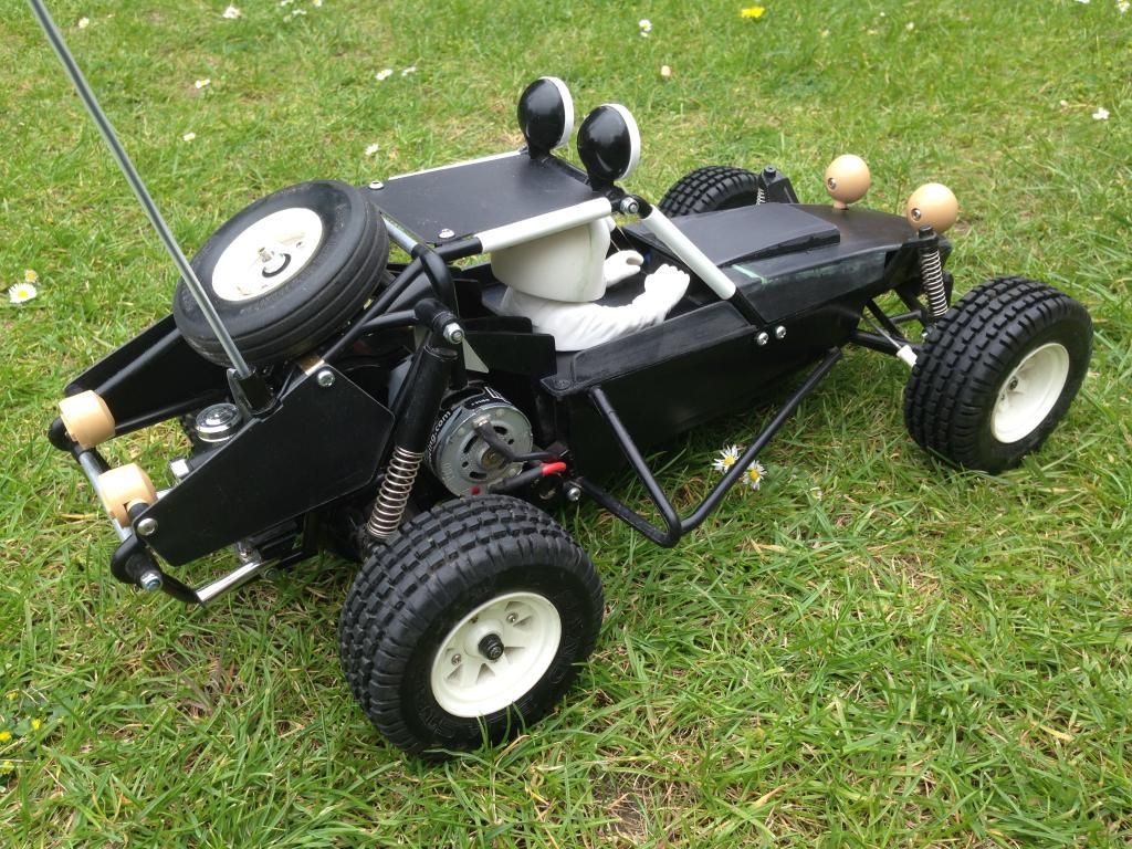

Made a fan shroud for the Duratrax engine from plasticard.
7AC14C1D-F4EA-4B28-B2F2-CAAA14E8C7FB_zps
3C528948-0C10-4467-B18C-5CCBA6031E92_zps
And a spare wheel holder from brass strip and an old steering servo horn.
9DE688BF-C2CF-461D-A709-19579013C8E0_zps
CB2F5553-BD39-437A-8070-4EA22620D6BF_zps
It's not as robust as I would've liked so I'll keep an eye on it.

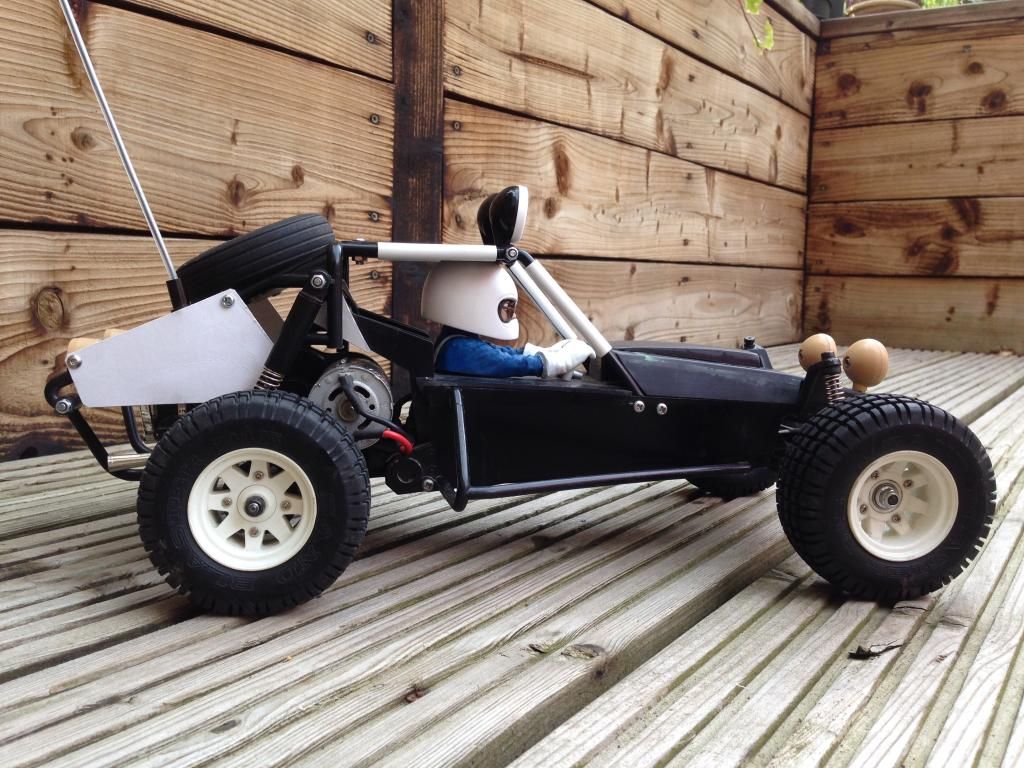

Here's the first try at the rear panels.
C478EA5F-3FEB-44C2-8F9F-D584D0FFE29B_zps
48C73198-54F7-41FB-83DB-6D57D12A3217_zps
I might make them a little smaller when I transfer them to plasticard as they hide the engine a bit more than I wanted. Quite happy with the balance though, it'll need some colour at the rear.

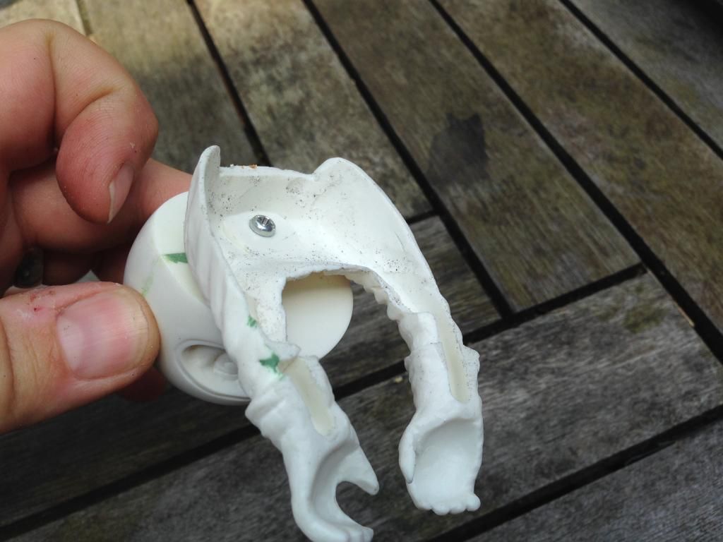

Today I've done the last few modelling mods. First I put together a new WW driver and cut a section out of his back so he sits a little further back. Filed and it's ready for fitting.

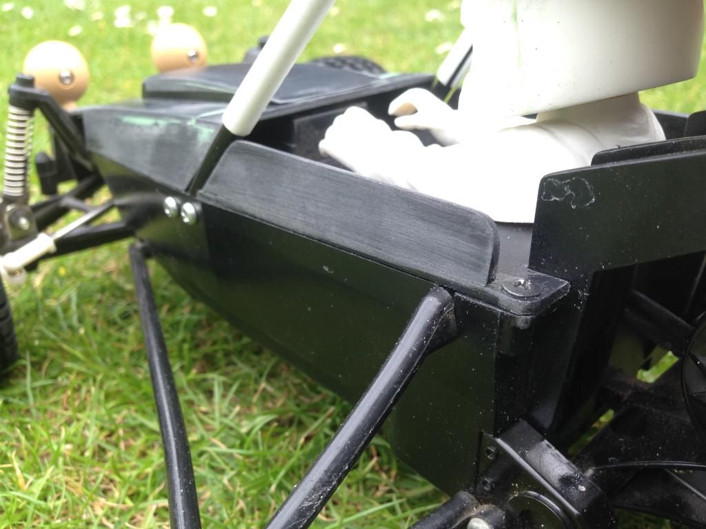

I also added a side peice to enclose the cockpit area a bit more.

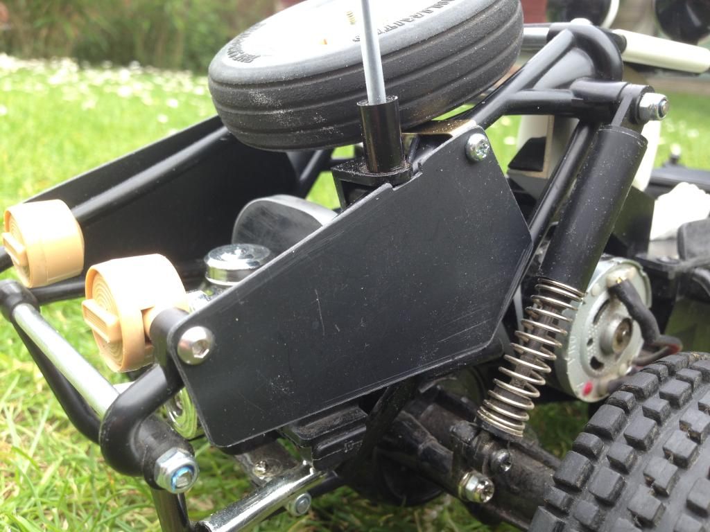

And cut the rear panels from plasticard. This side needed a small notch for the antenna mount.
27C6D49A-C2D3-4268-9492-A89D9EC83E88_zps
Other than cutting the steering wheel that's about it!

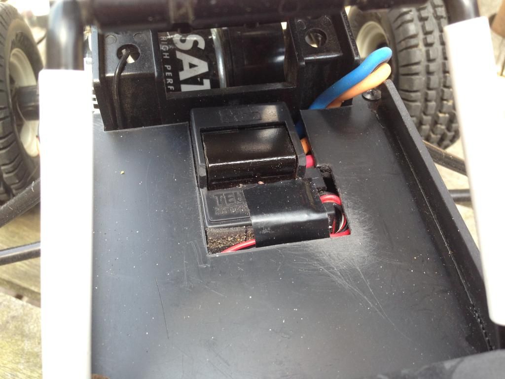

More tinkering today. On the last few runs I found the car would cut out every now and then for no apparent reason and then be fine once I picked it up. Traced the fault to the pressure the battery plug and wiring was put under crammed into the small space so I reluctantly have relocated the ESC. It's now under the driver at the rear of the chassis so I've cut a hole in the cockpit deck and given Willy a bit more of a trim.
BF0D7615-B2D0-4FC5-A897-2B948C5469D3_zps
130595BD-2C62-407E-A9B8-18BDC18CDFD7_zps
It's visible when he's fitted but it's not too bad and I can improve the look but a little more plasticard work and how I paint the driver. I've also taken inspiration for the GH's fixing for the driver and now hold him in place with a self taper through the roof panel into his head.
6F331A43-881E-4465-A90F-457B97C6FE46_zps
Drive it around the garden and it's not cutting out anymore :D
I also got around to trying out the 380 motor in it and I'm quite surprised at how fast it goes.
ESC is much cooler now but the 380 was very hot after 5 mins!

I just finished a FAV build, and would like to use the rx tube mount that you used here. What type of car did this come from? And if you know which parts sprue, I would be grateful for the help. Thanks
Space saver, it's lighter so helps it go faster :D It was all pre-planned of course :)
The antenna tube holder maybe available in other kits but I think mine was from a TL01 or TL01B. It's on the B parts sprue. Follow the link below.
http://www.ebay.co.uk/itm/111126907388
You can see it in the bottom left corner, between the servo spring and servo horn.

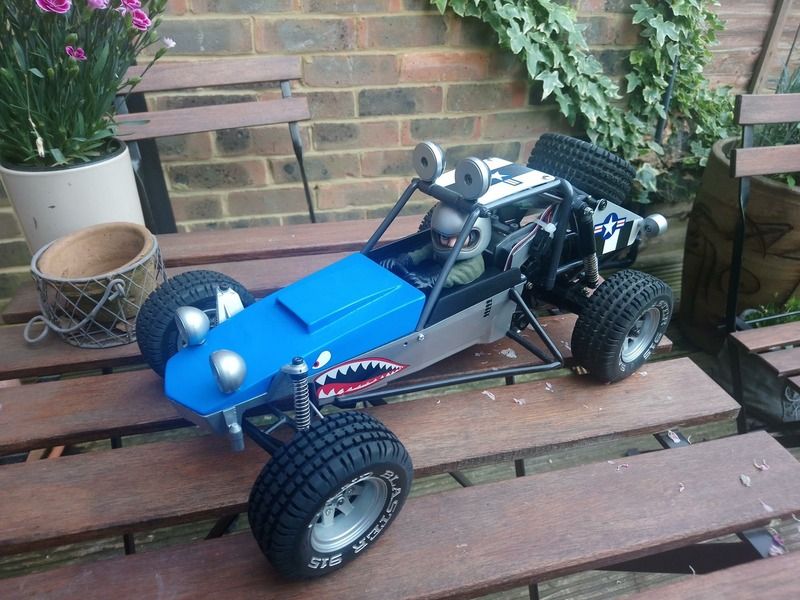

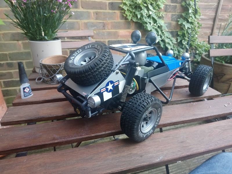

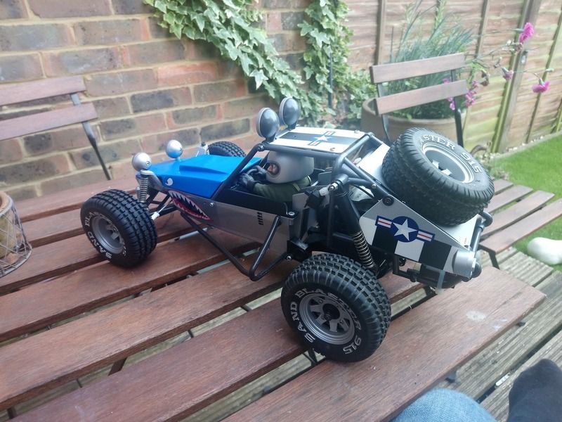

Thought I’d update this old thread as the Fast Attack Hopper is finally finished. Traded it with my brother in law and he gave it a rather nifty P51 Mustang paint job!
40D10C16-DF08-4182-9DA9-D77DF6696DB6_zps
26C49593-715B-43CF-B0BA-0004092C5BFE_zps
0868455D-F9AF-46ED-A2CE-E9A7F53A8EA4_zps
I’d like to point out the drivers face was painted by yours truely 😉
