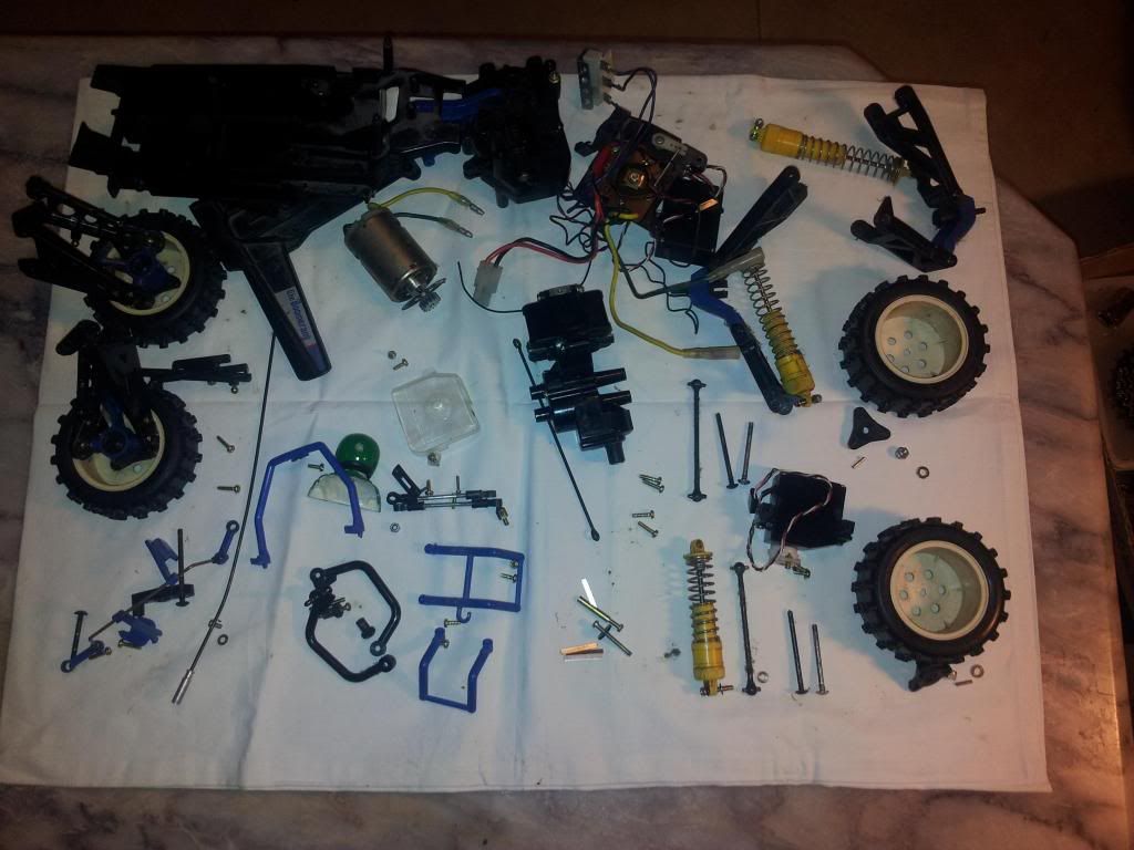

This is my next rebuild, a Bommerang. It seams to be the old Boomerang not the re relase? correct me if i am wrong.
I got this from a friend some time ago that wanted to put it in the garbage!
I thougt that was a bad idea of course :angry:
so i took it insted.
I have taken almost everything apart and i will clean the parts and do the damage control.
The front end is in bad shape what i can tell so far.
Boomerang has been re-released a few yrs ago.
Spareparts from re-re is not hard to buy like bumper, arms, blue parts etc.
Gearboxes & wheels are Hotshot parts.

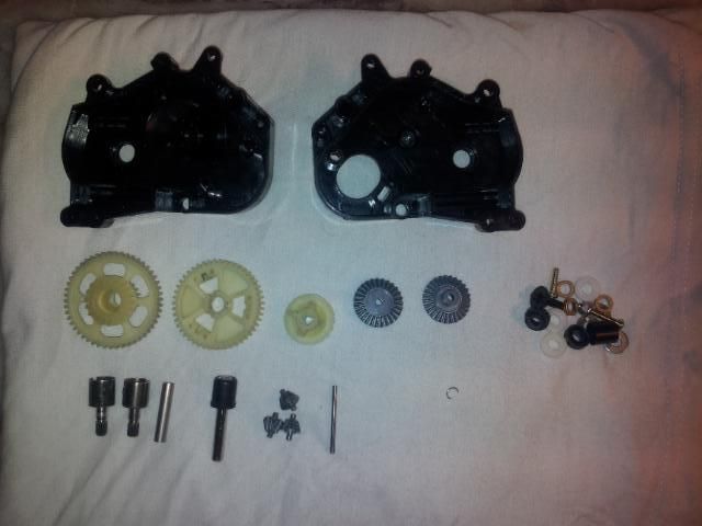

I have cleand and checked front and rear gearbox, everthing in very god shape exept for some minor repair on the front housing.
Very good save ! .
Most re re boomerang parts fit , BUT some need to have the re re parts & not the vintage parts .
Gear box is different , so you have to use the E clip off the re re & NOT the vintage C clip .
Just some small things like that .
But if your gear box's are good , just keep with that & use the C clip .
I am siting here and shall order a lot of ball bearing for the Boomerang.
In the gearboxes, is it better to use the correct thrust bearing or can i put in a normal 1150 bearing insted?
I have read that that is ok to do so?
/Lasse
thrust bearing only !.
Ok i will try to find some, will not be easy.
Is there any shop that has those thrust bearing for the Boomerang?
