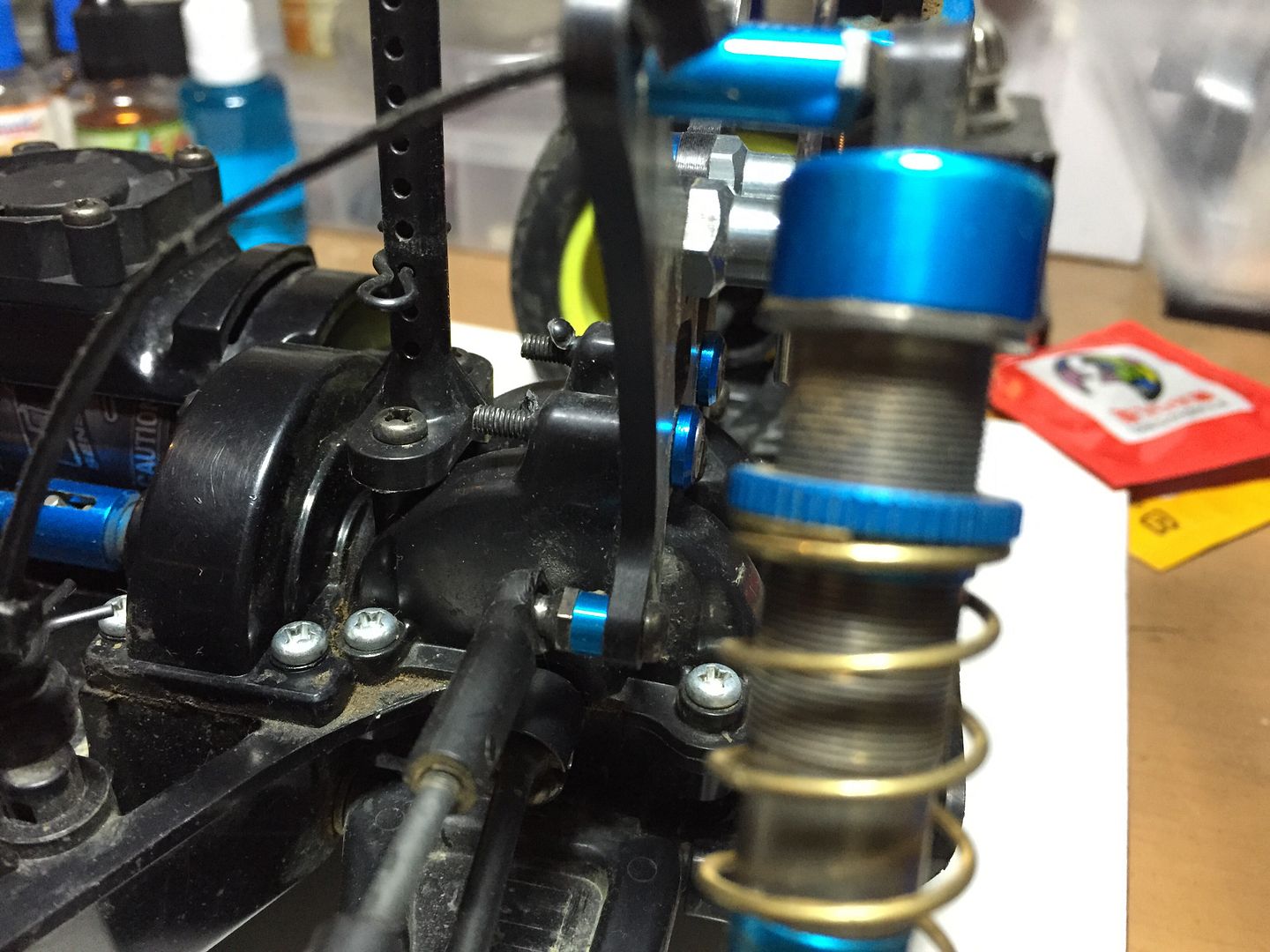

I have the same problem. Front and rear damper stays would loosen after just one run. I used longer screws that punched through the diff cover. If they continue to back out, I will use M3 locknuts on the end of those screws to keep them in place
That looks like a good idea.
Personally I would add the 3mm locknuts anyway, purely to make it look neater. Maybe some blingy blue ones?
