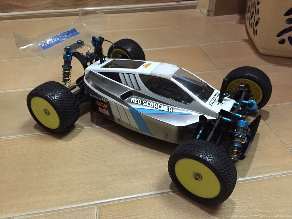

On ‎31‎/‎03‎/‎2015 at 4:46 PM, one_hit said:
I was able to fit the universal Tamiya Racing Buggy wing using Egress wing mounts (plastic N parts), a couple of nitro exhaust pipe mounts/hangers and a bicycle wire spoke bent into shape.
Hello mate, lovely looking car. Can't seem to find the Universal Tamiya Racing Buggy wing mentioned, is there a part code? Thanks :)
+1 sweet looking scorcher!
Thanks mate! A quick search for "Tamiya racing buggy wing" came up with 54134 and 53984 :)
Ah that's great thanks. Not sure why I couldn't find that myself! Inferior googling skills clearly.... ;)  now ordered  part 53984 and it's on its way.  Cheers.
Hey one_hit, so most of my (many) parts are now in for the TT-2B MS car am going to build in the next couple of weeks. I got the 53984 rear wing in also, to use with a Neo Scorcher standard shell I ordered.
I guess I need to fix the wing to the body somehow;  I see the Egress N parts in your photo, and I see the bike spoke bespoke mod, what's the fitting you used to connect the spoke wire to the rear shock tower? Do you have a closer photo of the mod? Any help much appreciated! :)
