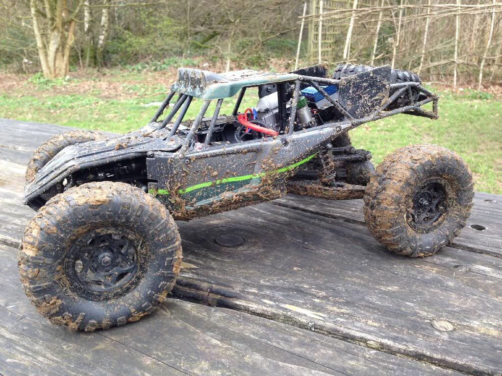

I own both and TBH they are quite different styles of car.
The TW is a true Rock Racer, it doesn't do so well in the slow crawler configuration and doesn't have a crawlers clearance for some obstacles. It's best kept for faster trail running or the standard super insane fast hooning about, at which is excels :D
90F854D7-0E60-4CE8-B0D5-D6DF8E996FB6_zps
Bad points are the high, rear battery location which induces roll overs and the small battery space. You can mod the battery deck to accept full size race packs but it's putting a lot of weight in the worst place possible! I've had trouble hitting the right spot with mine, relocated the electrics to the battery deck and went with a 4200 Turnigy Shorty pack fitted under the drivers location. Together with anti sway bars front and rear it's tamed the rolls but it's a ****** to swap batteries. I'm thinking to go for the GCM front Tower plate conversion to hopefully cure the issues I have.

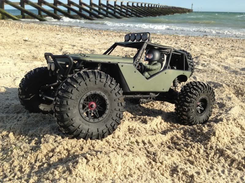

The Wraith is a much better platform to turn into a crawler. Firstly it looks the part & with a few chassis changes it becomes a much more competent slow speed trial/crawling machine. Mine has the battery forward and flip bonnet mod both of which are virtually cost free. Chassis mounted steering servo with panard. Flip the shock mounts on the axles over to sit lower but retain the articulation. Leccy bits all in a project box on the old battery deck. Numerous other bits and bobs been done over the years and it's still going strong. Big + points are the size, it's more like a 1/8 sized buggy so has great ground clearance and will take just about any 2S lipo you can to put in to. I run with a 5000 Turnigy hardcase and it'll go for well over an hour of hard abuse!
Best of all mine has the best driver in the business :D
I would say the build and parts quality is about the same on both these cars and on a par with Tamiya. The main chassis parts are made from a tough, nylon type plastic so they flex rather than break in most impacts. I've cartwheeled the Wraith down a hillside before and not suffered any permanent damage other than paint scratches!

Not too keen on that effect Shen, I'm more of a dull, low vis military kinda guy :)
4B77EA1C-201D-4288-8D82-EF9CFEB04C36_zps
Had to make my own plasticard bonnet as I melted the original one with a new brand of cellulose thinners trying to clean off the paint :(
Looks pretty cool you should put some fast attack stickers on it!
