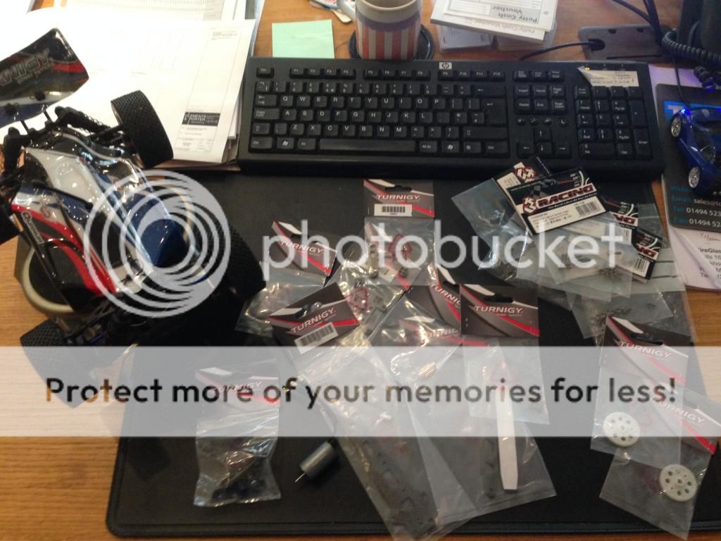

Been busy on this one, I think I jinxed it in my last post -
"I barrel-rolled this buggy end-over-end for about 20 meters and it just carried on. There's that lack of fear that you're going to break something expensive, because there's nothing expensive on it"
Turns out the steering servo got rather knackered on impact the other day.
I searched the web and found a suitable replacement, ordered from eBay in the end.
Metal-geared and hopefully a bit higher quality than the stock item.
Also recently fitted the hardened-steel spur gear and spur gear / diff outdrive support which came from Belarus.
The latter imroves the mesh between spur and pinion by putting the two much more parallel than the standard plastic setup permits.
Whilst it was out of action I decided to fit a few more hop-ups, some 3Racing universal front shafts as the dogbones ocasionally popped out of the wheel cups.
Anything which was dismantled was reassembled with 3Racing titanium hardware too.
Here's a pile of the parts which have been superseeded so far-
Hopefully it will be out destroying tyre treads again soon!

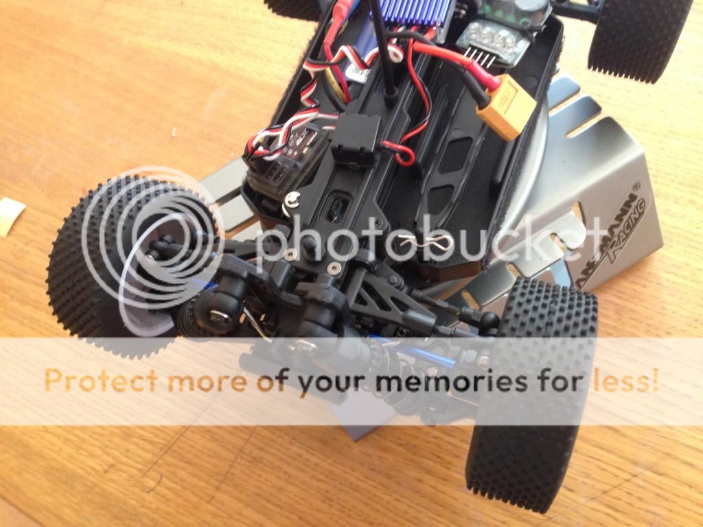

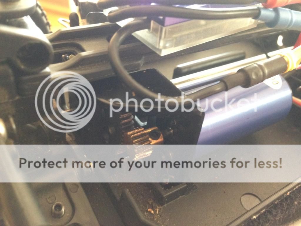

I agree, the one concern I still have with this buggy is the exposed spur/pinion. I have my steel spur gear now which is holding up well, whilst the pinions are made of brass. We'll see how it goes!

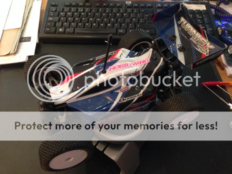

Busy yesterday / today installing all of the upgrades. The steering is soooo much better it's like a different buggy. The upper carbon deck prevents chassis flex and keeps the spur/pinion mesh completely square (previously any chassis flex would put this mesh out of line).
The Hobbywing ESC will enable me to upgrade the motor further down the line but also has more programmable features inc. LiPo cutoff, which I'm not sure the original kit-supplied ESC did have.
I also thought it was fair to add a Hobbywing bright pink sticker to the bodyshell, they supply you with a whole load of stickers after all.

I absolutely would, just not to a beginner. I wanted a buggy I could throw into the boot of the car and give abuse to. Sure, it has it's design flaws but it's incredibly fast for what it is and it takes jumps really well!
Will see what difference all these changes have made but I'm really just hoping for better reliability out of it and less time on the bench. It absolutely monsters the HPI Mini Recon my boss has too!

The exposed spur/pinion is a big issue on small cars (kemora, mini 8ight) when driving offroad.
On my kemora after many unsuccessful attempts to seal the area, I had to convert to steel pinion and spur. Noisy but the only way to get past one battery pack.
