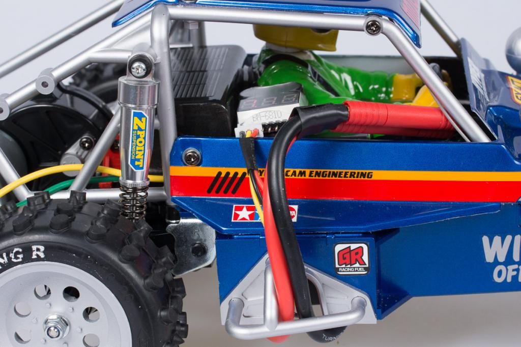

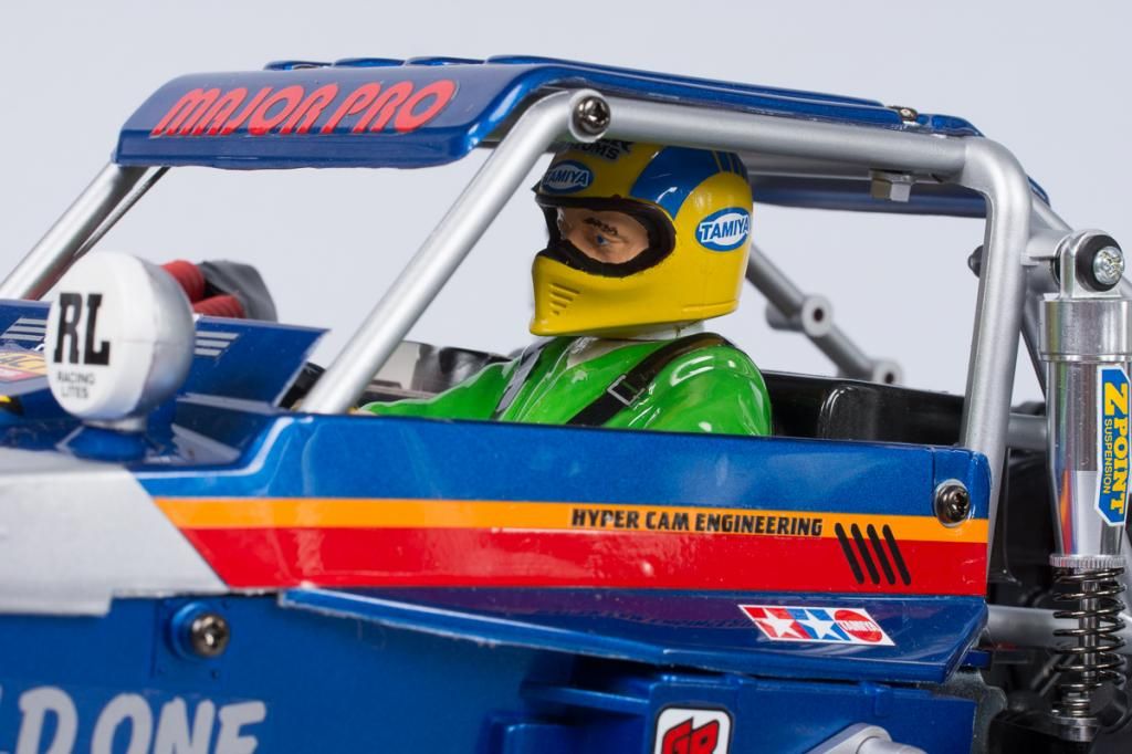

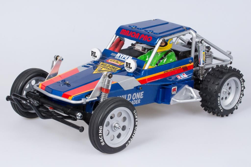

Hi All,
I have taken a few shots to show you my car, now finished! I had it on the beach for it's first run yesterday with the kids. I am amazed at how easy it was to drive, albeit in an open space. Even my 4 year old son was ok driving it and my 7 year old daughter too. Here are the pics:
So after this experience, my first RC build, I am really impressed. It all went smoothly, the cars looks good and goes great! I have found that the paint is hard to get to stock to the roll bars but that's ok I like the used look for things I actually use. I have 4000mah Turnigy hardcase LiPo's for these and they seem to last really well and fit in the space well too. I have the low voltage buzzer attached with velcro tape beside the driver. I am really impressed with the Imax B6 charger I bought too seems to be a very smart piece of kit.
I have started building Wild One number 2 for my son and did have a paint issue where the paint reacted with the lexan badly and trying to clean it off with thinners made it even worse. Not sure how to fix it yet but I think I'll try my airbrush sander to clean up the surface the polish with an extremely fine steel wool, followed by some plastic polishing compound and see if I can start again.
Cheers,
