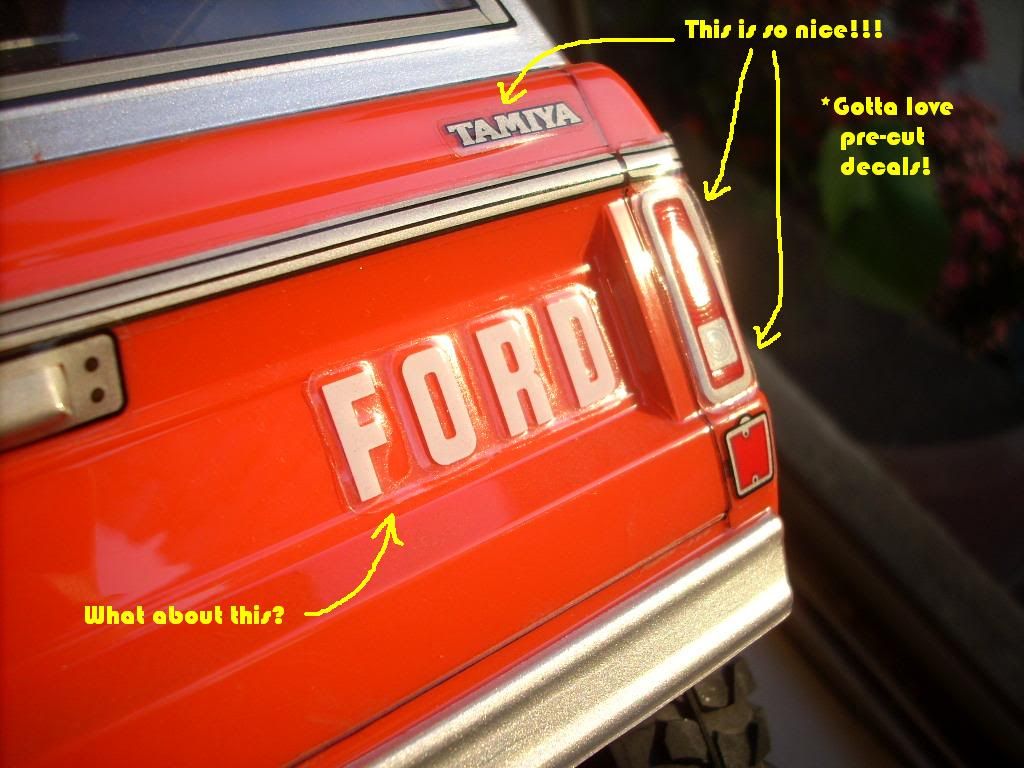

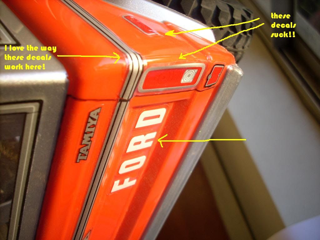

The main reason I dislike precut stickers. For lines cut from "solid" areas of coloured sheet which don't have clear film around the edges, precuts are OK, otherwise not. When there's no options to precut stickers for a certain body, I always remove the clear film from their edges, keeping just enough film to allow rounded corners to prevent peeling. Some prefer to cut stickers with a knife/scalpel, but I personally dislike the typical distortion that often results from this, with force applied in just one direction, compared to the virtual equilibrium of forces from both directions caused by scissors.
Buying the best scissors you can afford is a good investment. Tamiya's Decal Scissors (# 74031, pictured below) are rather good and far better than any "household" scissors, high quality surgical scissors even better.

I cut each letter out on my Bronco body to prevent all that air under the clear parts of the sticker. I did lay them down with liquid dish soap and water method.
The problem isn't that new decals are pre-cut (an unfortunate feature, by the way), but they are also thicker than the ones from the 80's. I learnt that comparing original Bruiser decals with re-res. They are much less prone to really adapt to the body curves, therefore they are almost useless if you want a perfect boxart Toyota Bruiser. They simply won't stuck on the sides of the Toyota body! :(
