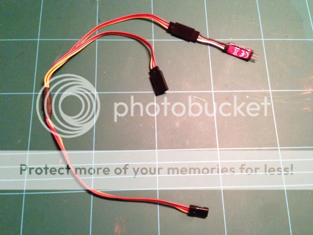

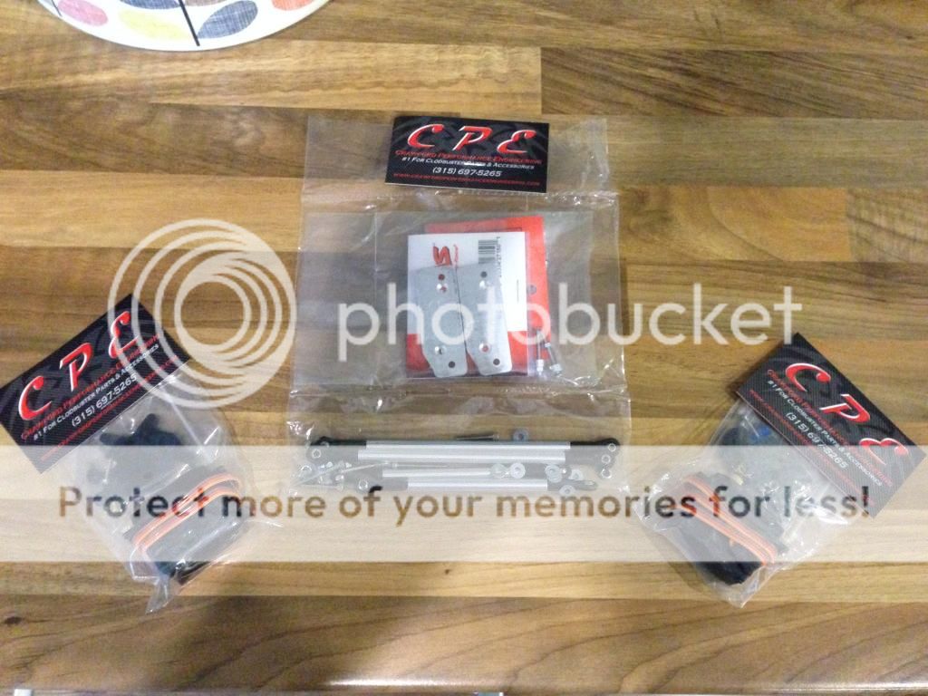

The only thing left to sort really is the steering as has already been mentioned. I have just received from Crawford all the parts required to put a servo on each axle. This is a relatively simple mod and while I haven't fitted it yet I'm told it makes a heck of a difference!
243183E2-4DD5-40F6-8799-1AFD6C58A49D_zps
You also need a servo Y-lead to split the signal from the receiver to each servo and then either a signal reverser (very cheap) or a quick (but slightly fiddly) mod to one of the servos to make it turn in the opposite direction to the other one:

Thanks again gents...yesterday I went ahead and ordered a bunch of parts. Shocks, savöx monster torque servo, a receiver, ball bearings, an esc, CPE steering links and chassis brace, servo plates, and the ESP alloy ball bearing steering links. My pockets are officially empty until next payday :(
