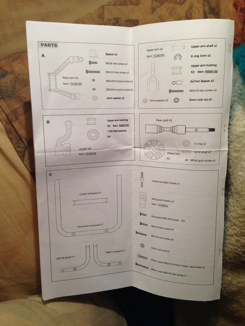

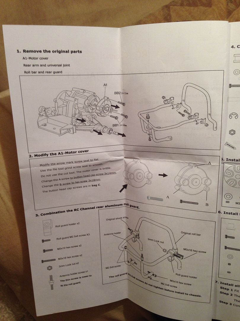

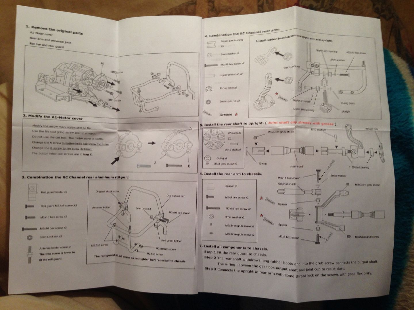

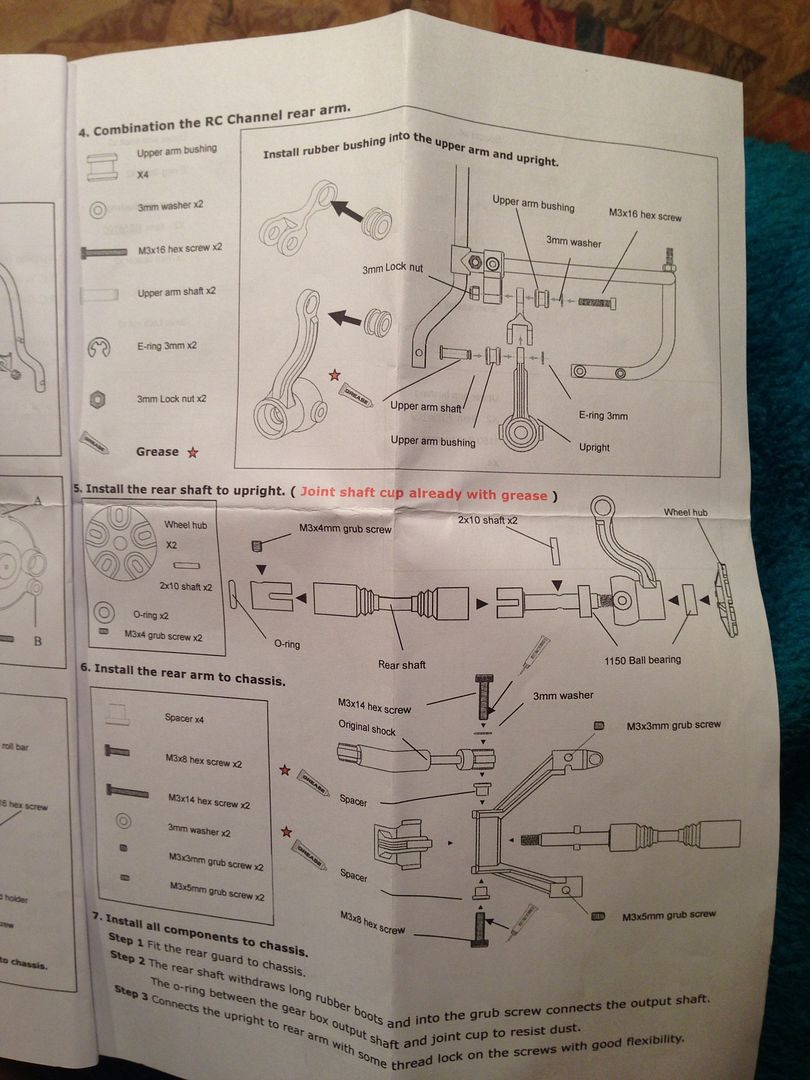

I will add pic's for you in a few minutes . As i have the instructions .
This kit come with it's own u joints & shalft's . If you look at the last pic on MY below post .
You will see the parts list that came with the kit . Now you can buy the rear shalfs from rcchannel.com.tw/
by them self .
Let me know if you need better pic's etc .

Thanks for the replies and the instructions.
Think I have it sorted, for whatever reason the builder used the Tamiya joints instead of the RC Channel shafts.
Emailed Paul at RC Channel, and got a quick reply, seems like a really cool guy by the way.
Will be ordering the correct shafts.

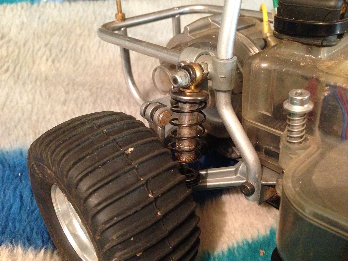

I plan using a set of Scorpion 2014 shocks with the coilover kit, I made aluminum collars for the tops and will use the stock Kyosho bottom mounts.
Will be removing the torsion bars and front springs.
Will be interesting to see how it all work out.

This is one of the sets i got from them & i don't use the torsion bars , or front springs .
